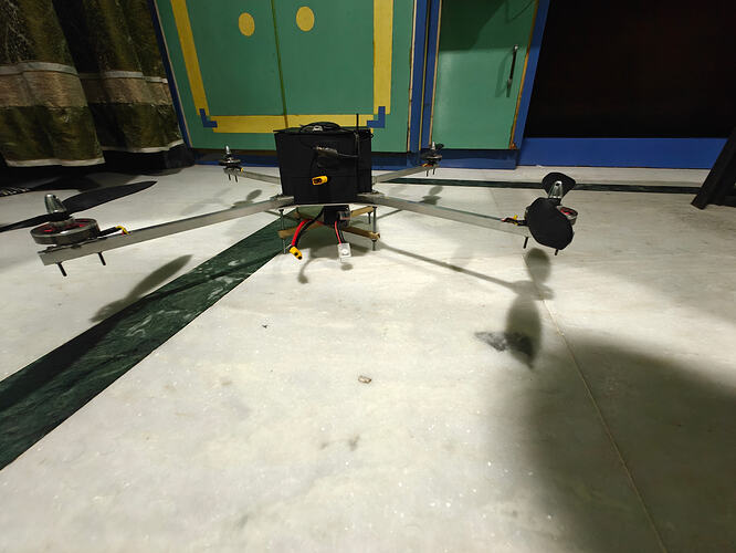

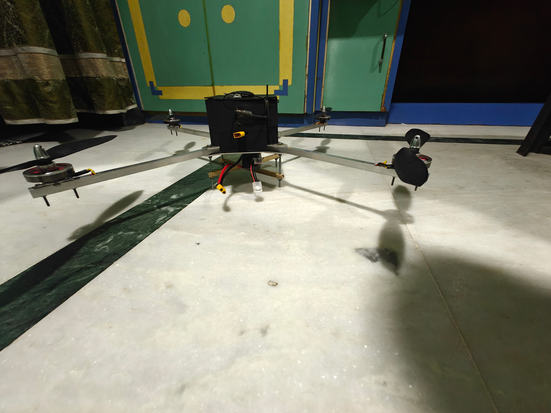

Review this log please
Perform the 3-axis accel calibration again. Then level the craft and perform a single axis “Calibrate Level” and check in the HUD that it is actually level. That’s all you can do.
What transmitter do you have? From the last log you posted it doesn’t look like you performed a Radio Calibration.
Radio calibration is done, I have skydroid t10, it doesn’t have any trimming options, can I tilt the drone on the opposite side of the drifting to compensate for it? Also please answer:-
Does accel calibration resets the imu level? Or the factory leveling done on imu cannot change? What does accel calibration actually calibrates?
If the FC is not level with the frame you get the kind of effects you are seeing.
The correct solution is:
  1. Make sure the landing legs make the drone body level.
  2. Make sure the body is leveled
  3. Make sure the motors are leveled with the body
  4. Make sure the FC is leveled with the body
  5. Calibrate the Aceels like @dkemxr said
Tilt to the opposite side is not reproducible. Do you really want to tilt the drone every time you arm it? How are you going to make sure it is always the same tilt? If the FC is not level with the motors there is no amount of tilt that is going to make it work!
No, the accel calibration IS the IMU level.
There is no such thing as factory IMU level!
Calibrates the IMU level

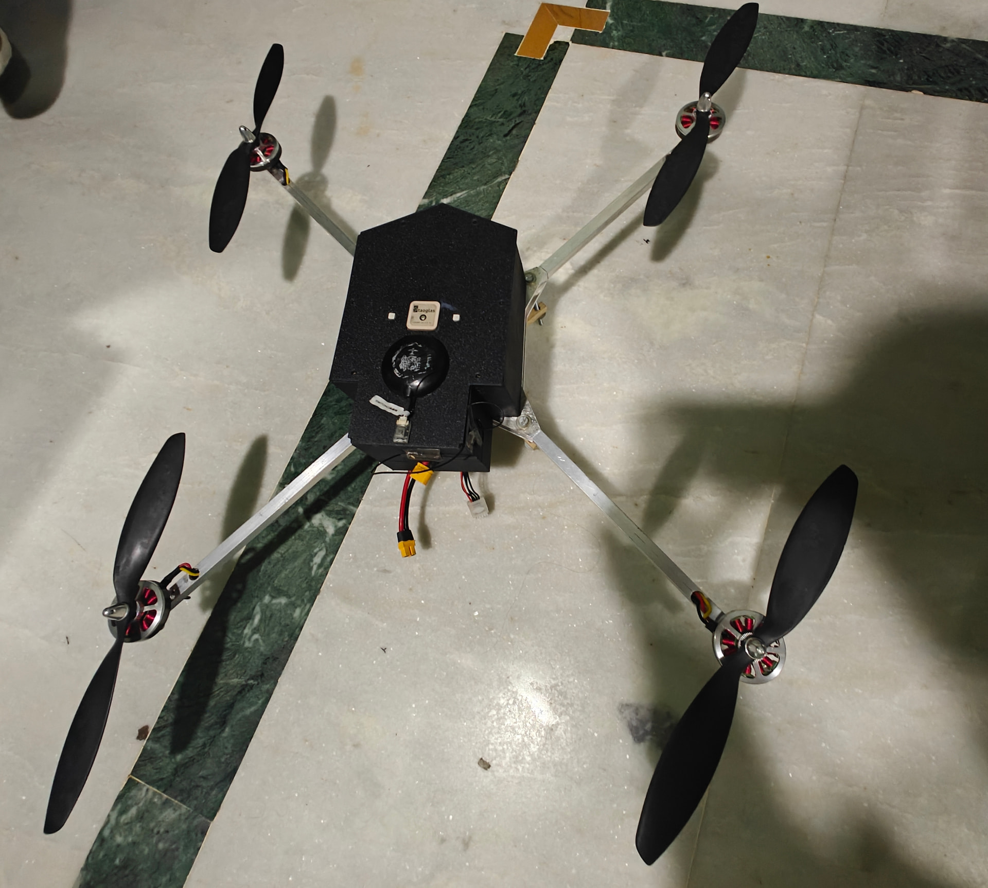

after doing all the steps before autotune(except magfit) i am unable to get a good tune, i tried autotuning it 2 times but the drone is osscilating after giving it a sharp yaw or pitch command. it flies relatively stable in default pid, but still it osscilates a bit in hover position. i tried setting up mot_expo using my performed thrust experiment on the motor and propeller(only one set). i did the whole setup above 3-4 meters where there is no wind and followed all the steps here AutoTune — Copter documentation, still i am not getting a good tune. i have attached the videos of the drone flight and logs and also thrust test.
Yes, after 4 months of messing around tuning is poor. It could be attempting different colors of lipstick on a pig with that frame build. I would use Transmitter Based Tuning which is just a method of manual tuning. If you flash the Dev version of firmware you can configure 2 channels which will speed up the process a bit. But no matter what it can be a bit time consuming. At the end of the tunnel though you will know a lot about PID tuning because there is no “Auto” about it.
IMO your frame is not sturdy enough, too much noise and vibration, also you need to invest in gathering RPM data by using some ESC that support that, it will do filtering so much simpler.
did the frame modification, can you please share filter configuration for the following
i am not getting it. there are 3 peaks at 39,71 and 91hz and i cannot attenuate all the peaks because the maths doesnt add up. please share filter configuration.
The maths not adding up (71 and 91 not being multiples of 39) is a clear sign that the hardware still has issues and is still not sturdy enough.
Fix the hardware better, and then the notch will also work better.

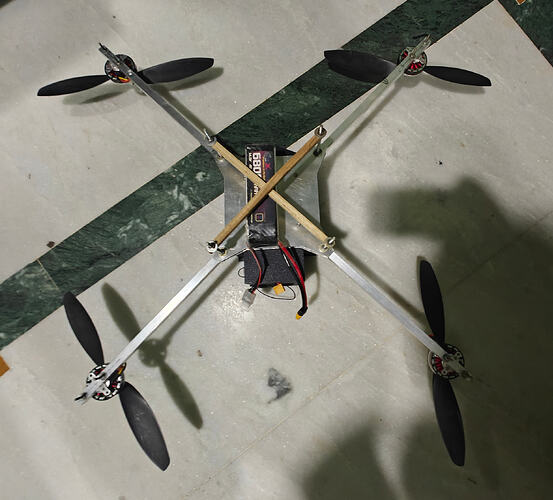

Sir, can you suggest some changes? I have sandwiched 2 aluminium plates between 4 12x12 Aluminium square hollow pipes, the overall weight is less than 500g, the only vibration I can find is at the end of the pipes where motors are mounted. And as I change the propellers , the vibration level also changes.
Aluminum is not a great material for a frame build. The arms are poorly mounted to the plates with insufficient support and those huge holes for the motor leads are decreasing the arm rigidity.
Sir, at this point I have given up and want to sell my drone and just quit the hobby. I tried everything, the drone feels like one whole piece, rigid, sturdy. I have used double decker box to fit the flight controller at the second level and escs on the first level(just below flight controller). I can’t afford to buy new parts or frame :sob: or carbon fibre.

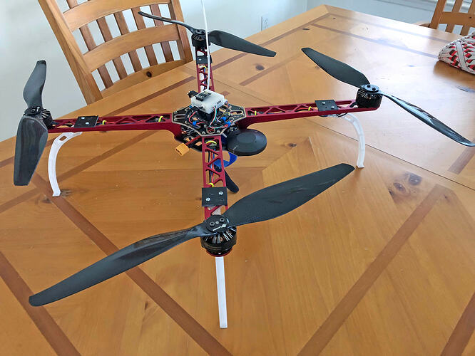

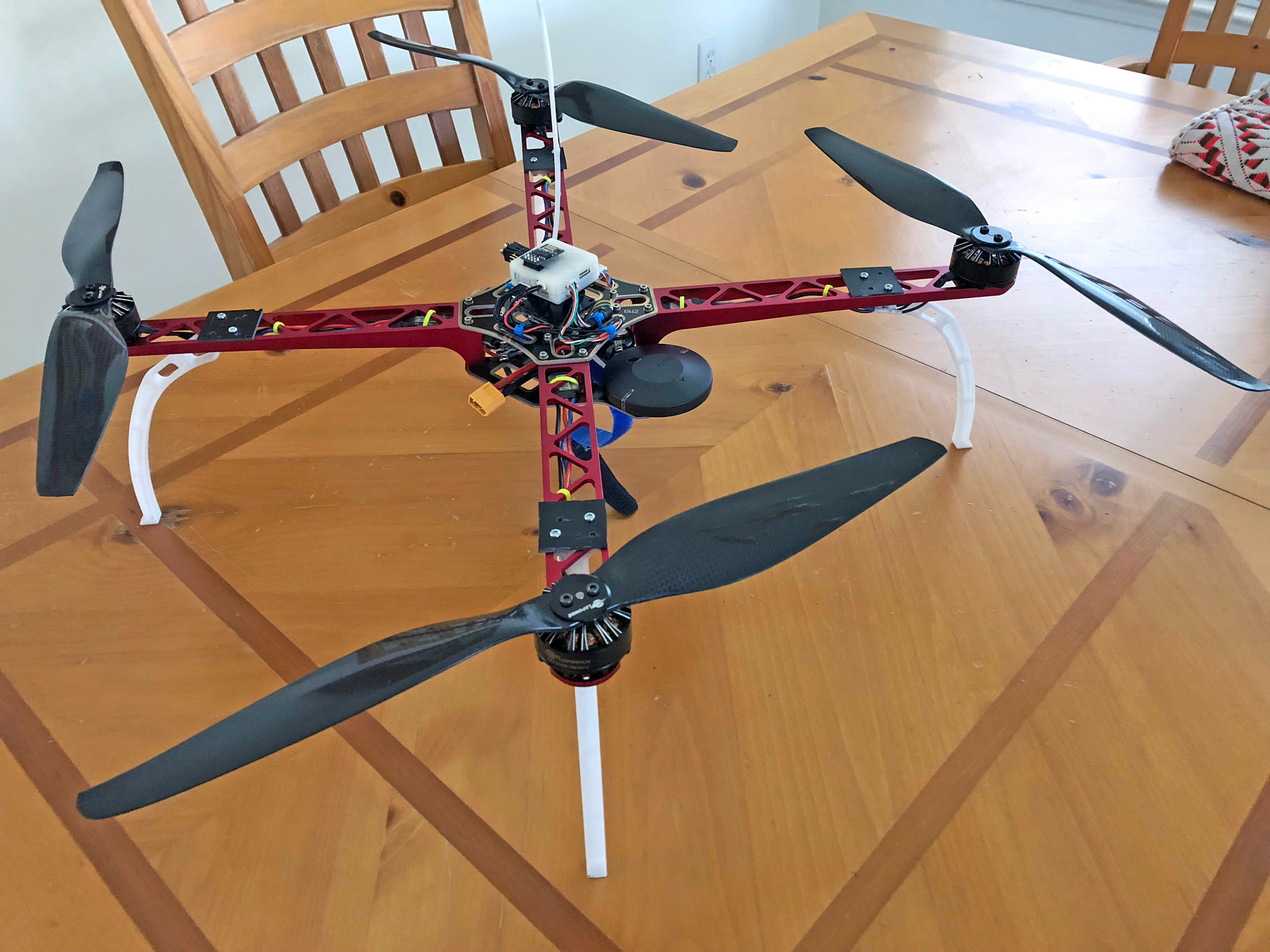

Was this the orginal thng? How exactly did you feel the bad tune? I am also building an F330 frame, going into PID tuning in a few days. Wish me luck :wink:
It was one of the early knock-offs of the Flamewheel which came with the shitty plastic arms. I had these aluminum arms on it until they pretzeled in a crash then put G10 arms on it, also extended, and then the shitty frame plate broke. They are truly junk frames. Why don’t you use a cheap CF 7" frame instead of that F330 Frame? They are junk too.
Make the arms shorter. That will reduce flex and vibration. and the Box for the FC Probably just adds to the vibration.
I am not aware of “ CF 7” “ frame. Did a google search but there are no results with anything of that name here in India.
By the way, this is for my college project and the whole thing is already on the expensive end for us, so yeah that’s why I chose F330. It only costed less than Rs. 1000. Now, I’m thinking I should have gone for a smaller frame since this is an indoor drone since this is a bit big to handle, but this build was the cheapest I could put together, considering all components.
By plastic, you mean glass-fibre right? Mine seems to be glass fibre (This is what the vendor page says: Glass Fiber + Polyamide-Nylon)
