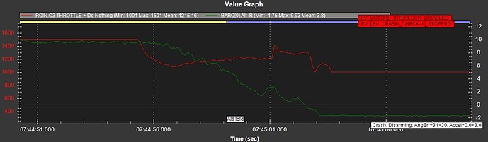

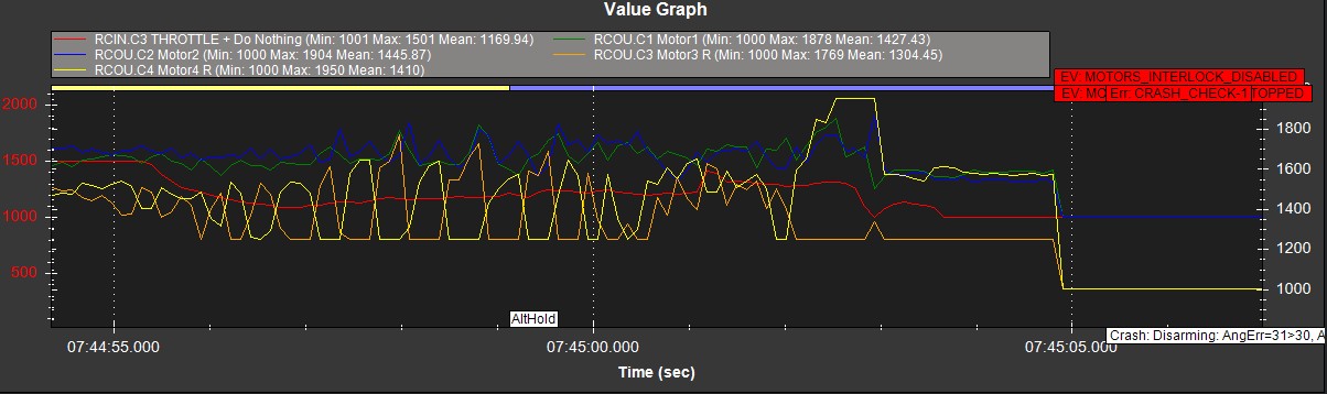

Sir, the hobbywing escs are rotating the motor around this value, below that no rotation on arming so I set it. Any leads on crash info? Why it happened, I spend 2-3 days just for autotune and still it crashed in loiter. The crashed happend between 17:14-17:16. There is a big spike in this region. The log also includes log_disarmed and detailed ekf logging. IDK what is wrong with it😔 I have followed all the steps, I am also learning a bit about reviewing logs, taking help of gemini but it’s still inaccurate.
Then perhaps you have an ESC calibration problem because this IS the problem.

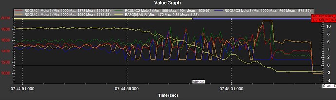

Note here as you are descending, before you switched to AltHold which had nothing to do with the problem, the motor outputs are bouncing off of the very high Minimum Spin you have configured. Stability is lost under this situation and down it goes to a crash.

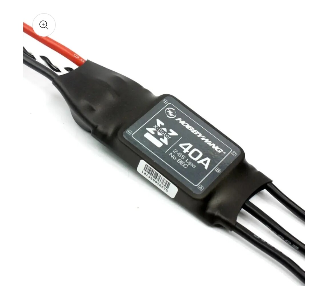

What exact Xrotor ESC’s are these? Post a photo and a description.
Sir, the esc’s are brand new, here is the link, also one question:- how can an esc be the reason for the crash in loiter?
XRotor 40A Multirotor Drone Brushless ESCs 2-6S
It’s hard for me to believe that when you run Motor Test in Mission Planner it takes a minimum of 20% throttle for the motors to spin. If so then the ESC calibration is probably not right.

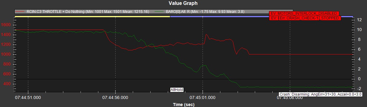

What are you talking about? The log shows YOU dropped the throttle and it started descending and it then lost stability for the reason I gave.
Open the log yourself and start doing some of your own analysis.

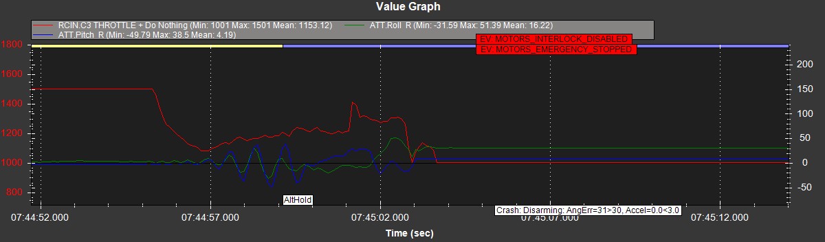

Yes sir, I dropped the throttle because it was death wobbling sorry if I put it wrong. But the drone slowly became unstable in loiter mode then the unstability got worse and then I started to descend using throttle. The log also contains disarmed part. Sir I also did the analysis based upon my understanding but I didn’t get the problem. The drone started death wobble/was unstable in loiter mode before descending.
Sir, I did a stress test in loiter and the drone refused to crash, I seriously don’t know what is wrong with my drone. I have shot a video as well as logs are there, please take a look.
I call bullshit on that and you should be able to see this in the log also by looking at the sequence of events.
You drop the throttle and then as it descends attitude control is lost:

Also after the drone started wobbling in air then I lowered the throttle, please check first spike.
