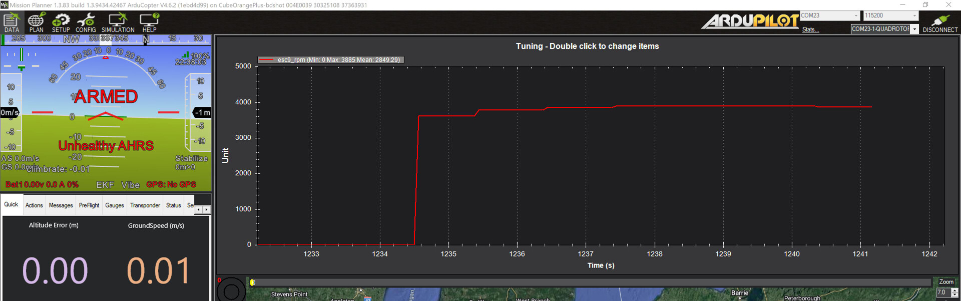

I recommend also shift to bdshot Arducopter firmware. It will helps you a lot on Harmonic Notch filter settings without additional hardware change, noise and vibrations reduction. Take note, Aux port 2 onwards on Cubepilot support bdshot.
The main outputs are Dshot capable if configured properly.
What do you see here?
Dshot main
Count the number of magnets on the bell. Set Motor Poles to that number. It needs to be correct, especially if you want to use telemetry for filters.

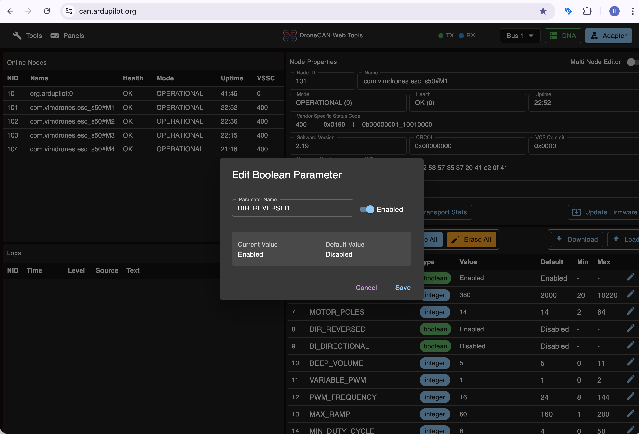

with DroneCAN, things are easier :wink:
Vimdrones needs a 4-in-1 DronCAN ESC!
