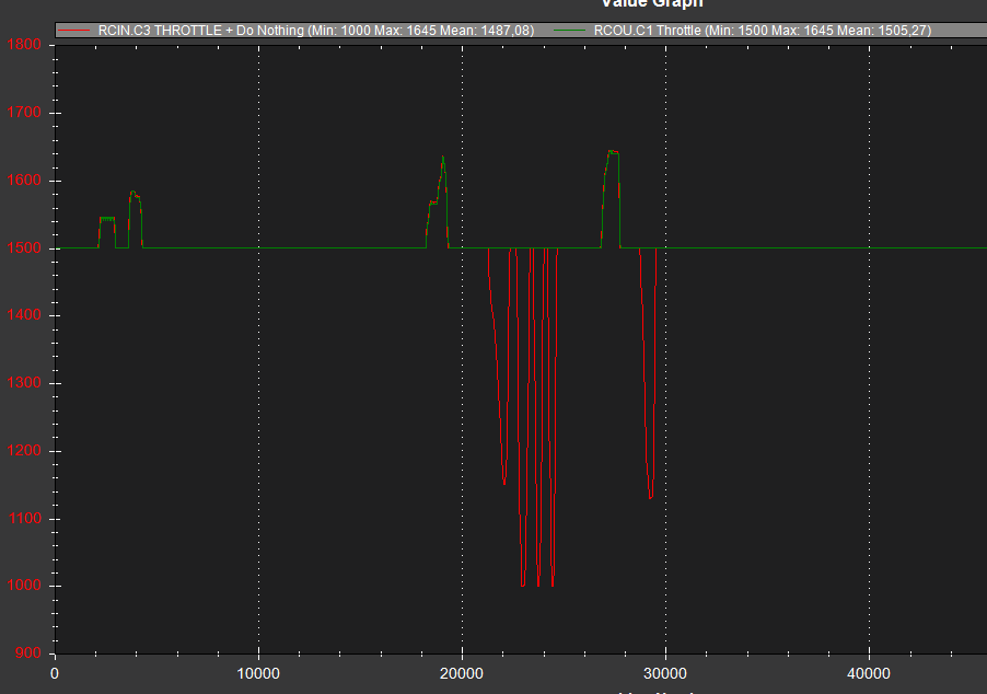

I cannot get reverse thrust to work.
If throttle input is lower than 1500us, ArduPilot sends 1500us to the esc.
ArduPlane 4.6.1
Matek F405-Wing
log file

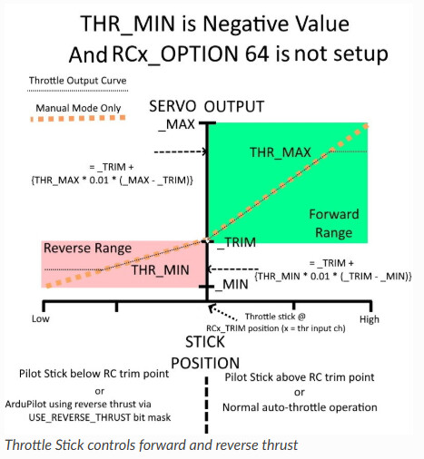

I have setup reverse thrust according to the documentation.
I use this setup:
But it does not work.
