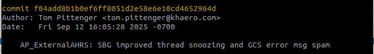

We are migrating our fork of Ardurover from the Master Branch to Rover 4.6.3. We are using a Raspberry Pi 5 and integrated it using AP_HAL_Linux. Originally, we created a hwdef.dat file to setup our IMU, GPIO, and CAN connections. The hwdef file was located in /libraries/AP_HAL_Linux/hwdef/.
On the Rover 4.6.3 tag it appears there are no hwdef files. How do we configure our Raspberry Pi with sensors without creating a hwdef? Is there an easy way to port our HAL configuration from the Master Branch to Rover 4.6?
I attached our hwdef file as well as the specific commits.

The hwdef is from the following commit on Master branch:
And we are trying to migrate to this commit
Thanks!
Looks like we migrated to hwdef for 4.7 from a legacy mechanism for Linux builds. Is there anything you specifically dislike about the master branch that is driving you toward this solution?
4.7 is close to a beta period and release, and it may be worth your while to simply maintain what you’ve got until the stable release rather than working toward backporting.
