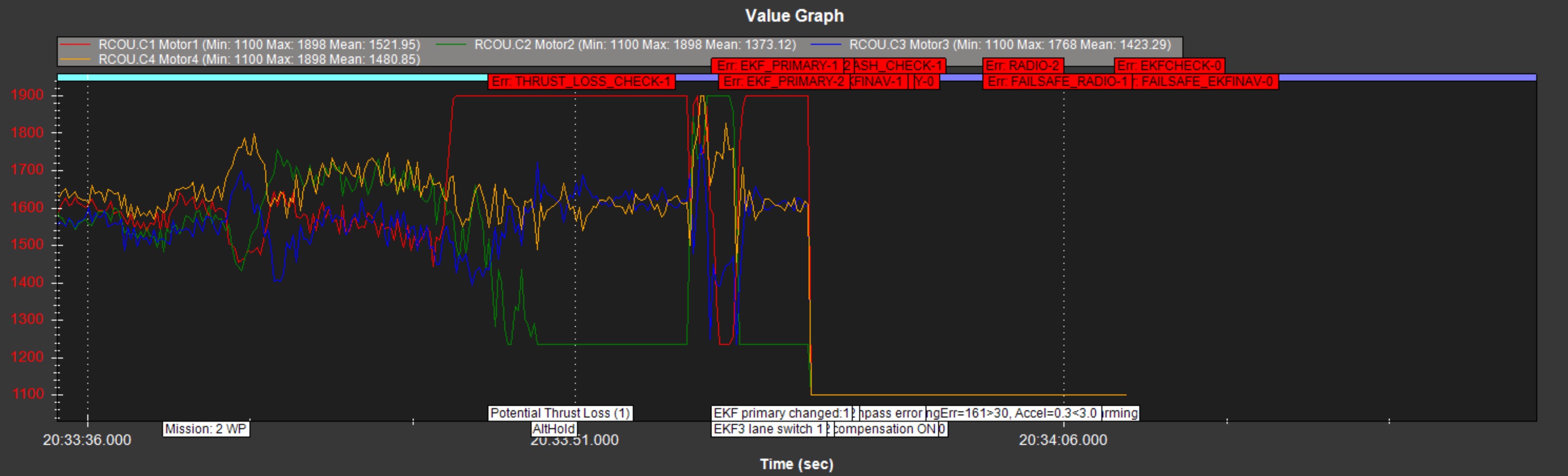

Flight 119: on the next real flight the aircraft again lost thrust on the front-right side and crashed. ArduPilot logged:
Potential Thrust Loss (1)
Motor 1 command went close to maximum while the aircraft continued to roll/pitch toward the front-right side. EKF/GPS errors only appeared after the aircraft was already out of control.

Could RCOU.C1 still look normal in the log if the actual PWM signal physically reaching the ESC is interrupted?
Also, how much confidence should I place in Potential Thrust Loss (1) identifying the actual failed motor?
