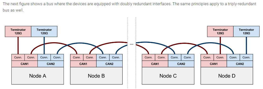

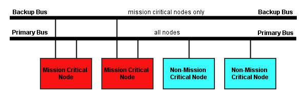

I noticed in DroneCAN’s hardware recommendations that they suggest establishing a separate ‘backup’ and ‘primary’ bus, with essential components connected to both.
However, practically, this seems impossible since most devices have only a single CAN bus interface.
