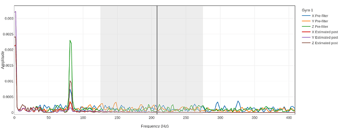

Hello everyone. I flew my drone again after enabling RPM filtering, and it feels much better. I no longer see the vibrations that I noticed during my first flights, and the parameters seem to be working well. I also increased ATC_ACC_P_MAX and ATC_ACC_R_MAX to 280, which made the drone feel more responsive. I think I could increase them a little more for an even better response, but I’m not sure yet. The RPM filter seems to be working well, and my vibrations have been reduced significantly. I no longer hear the motor oscillations. During my first flights, the motors sounded like a tractor, and I really didn’t like it because my GoPro picked up that horrible sound. With the new settings, the noise is gone, and the drone flies smoother. I have uploaded the log from my latest flight with RPM filtering enabled. Please keep in mind that my flight controller has limited logging memory, so I recorded as much data as I could. If I don’t need to make any further changes, thank you all for your help and support throughout this tuning process. I really appreciate your time. Happy flying!:blush: :airplane: https://drive.google.com/file/d/1xbFdjLhTXOeTtOUEKHdp_YLFQIb8Zqp9/view?usp=sharing

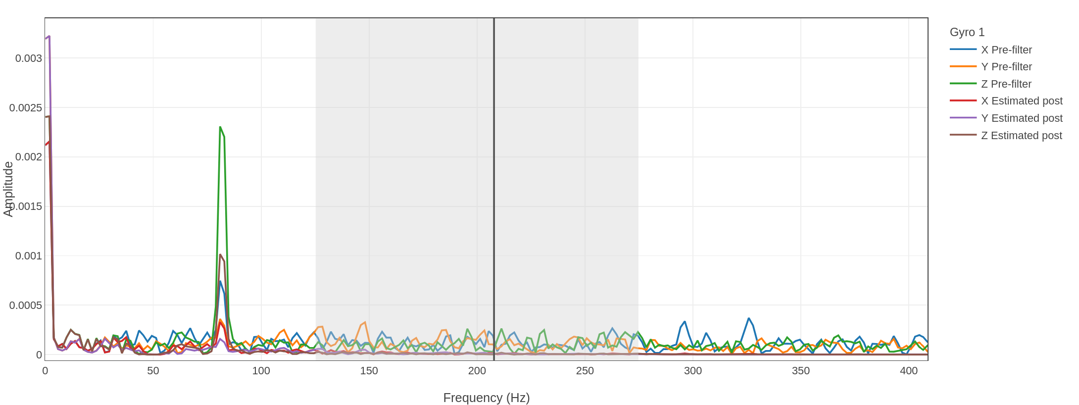

The RPM looks correct and that would give a (motor) noise frequency around 228Hz, which is where the notch is centred - but there is still a peak around 80Hz. Is there a fan fitted to the VTX or something like that??
That 80Hz peak will be why you seemed to get better performance by lowering the gyro filter to 60Hz, which would normally not be required. Leave it there.
Aside from that, noise is still VERY low and there is no need for a notch filter at all.
The frequency response and phase is MUCH better with the notch filter disabled. Even the 80Hz peak is below the level we would normally be concerned about.
INS_HNTCH_ENABLE,0
If that 80Hz peak became an issue then you could set a static notch for it.
Attitude control looks great.
Personally I would probably still run Autotune which will give you the maximum accelerations and PIDs - you can adjust down a bit from there for the best feel. I prefer the result with AUTOTUNE_AGGR,0.1 and these small quads suit tuning the Yaw D term too.
Usually these small quads end up with ATC_THR_MIX_MAN higher than 0.5 This is not adjusted by Autotune, you have to adjust it yourself to suit requirements.
