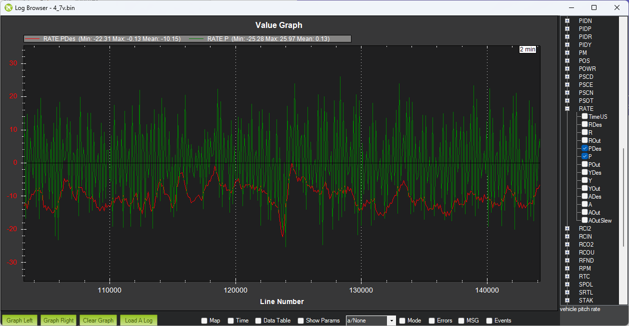

The 4.6 log’s rate tuning is not too bad
But the 4.7 log RATE logs look terrible so something has definitely happened.
I noted that pitch and roll deviations in the new flight are significantly one-sided. This may mean nothing because of all the clipping, but it may also be a sign that weight distribution has changed (and this led to worse responses with the existing problems).

There are significant differences in configuration between the logs, including harmonic notch and gyro filtering setup. The stat params indicate a significant number of flights between the two provided logs. I don’t think 4.6 to 4.7 is the only change. Unfortunately because the 4.7 param conversion has now been done, and then more changes made on top the only way to test it would be to wipe params. Go back to 4.6 and restore the config from a saved set of 4.6 params. Then perform the first test flight. Then update to 4.7 and perform the second test flight.
Vibrations, filtering and PIDs are all different sides of the same thing, you cant work on only one while leaving the others fixed.
