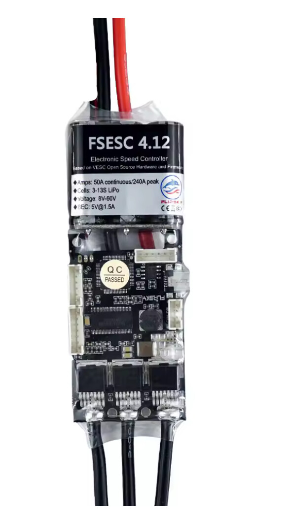

I have played about with a similar idea, but I was looking at doing it in software with a VESC controller, basically it can track the motors position at all times, so you can run it in current mode for flying then switch to angle mode and set it to stop where you want.
Unfortunately the vesc mini escs aren’t cheap
https://vi.aliexpress.com/item/1005005528310875.html
Would something like this work for what you’re trying to do? A little bit cheaper, it looks like.

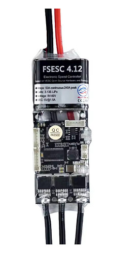

There are cheaper controllers but they are are heaver. they would be better suited to larger motors.
https://vi.aliexpress.com/item/4000437383339.html
