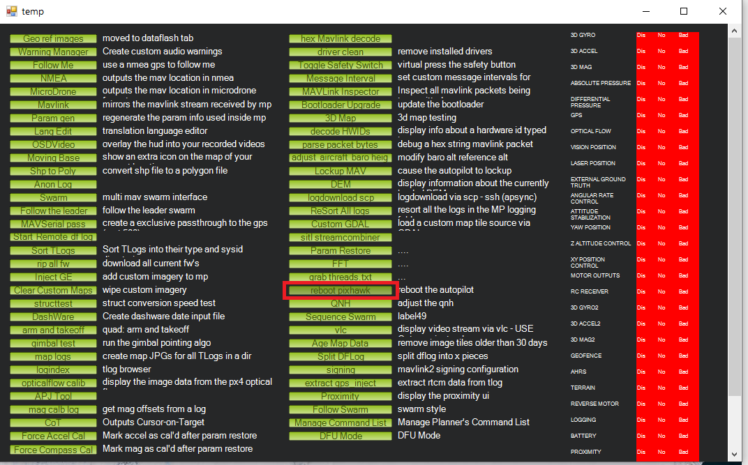

You can reboot via software so you won’t have the error described above.
In MissionPlanner you press CTRL+F
Yeah I know this and already said that that process was rare, only needed in mp firmware flashing so now I have shifted to qgc for this and mp never worke
