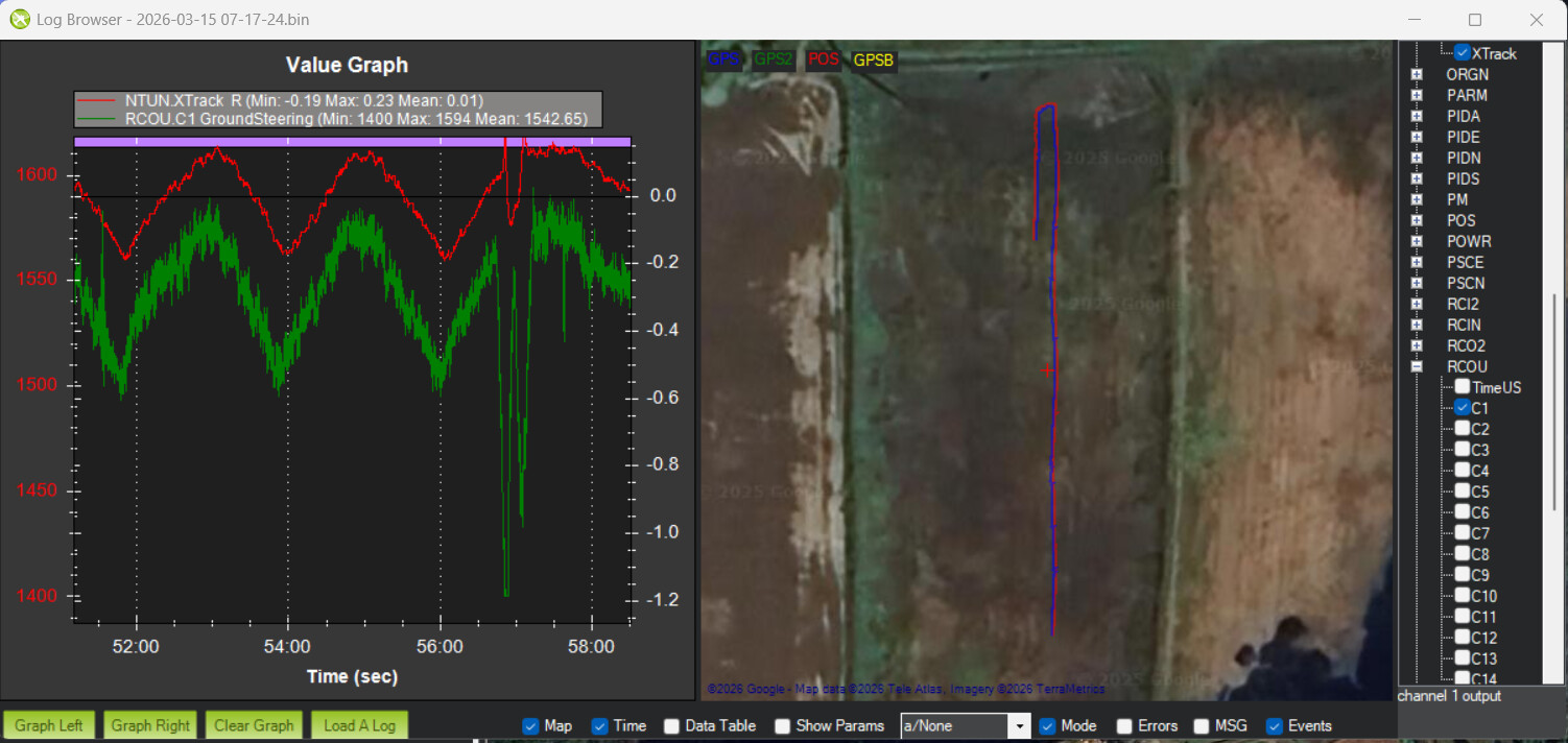

I am attaching a screenshot of NTUN XTrack vs Steering RCOut. The RCOut follows the XTrack error (about 2minute oscillations around the straight line, peak to peak 1500 to 1580) but it also has a “noise” component (peak to peak about 10-20) on top of that which is caused by tiny position errors (many reasons for that, but the rocking/vibration of the vehicle is one of them). I wonder whether this can be smoothed out because it doesn’t seem right and although tiny it does consume battery power.
Hi @SeptenJDT,
OK, so this is a very mild case of “wobby path” (as we call it). I think the solution is to increase PSC_VEL_FF which is mentioned on the Position Controller wiki page but probably incorrectly says that it should always be zero. I wonder if you could try a value of 0.5 to see if that helps?

That’s a very slow rover! Tuning is a bit difficult at that lower end.
I’ve had some success with similar speed (albeit on a much smaller vehicle). Looking at your logs, a number of maximum speed and steering parameters are set too high (beyond what the vehicle can achieve):
  • Your CRUISE_SPEED and CRUISE_THROTTLE are way off. I’d suggest a CRUISE_SPEED of 0.13 and CRUISE_THROTTLE of 80
  • Likewise set WP_SPEED to 0.13
  • Decrease ATC_STR_RAT_MAX (max turn rate) to a realistic value for the vehicle - that looks to be around 40 degrees/sec. Also decrease ATC_STR_ACC_MAX to 20 degrees/sec/sec
That should (along with @rmackay9’s advice above) help reduce the wobble.
I would note that the sorts of turns you’re doing (<10 degrees/sec) are typically far slower than what a typical vehicle does, and will likely require larger-than-typical PID values.
