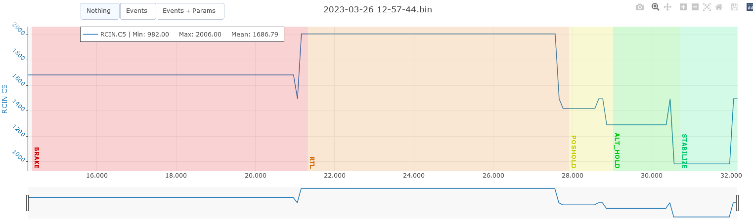

So I can shed more light on this. It only occurs when changing modes although not 100% of the time it does within 4 or 5 mode changes. In every case of this occurs you can see the channel 5 which controls the mode go to mid point of 1,500 PWM but the logs stops before the PWM completes the change and before the FC changes mode. Changing to RTL seems to be the biggest culprit.

Here is the plot of mode change channel on the original log when I switched from POS to RTL you can see the logs stop immediately after the switch position change and before the FC changes mode.
