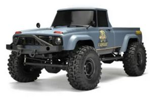

You won’t find much if anything. Buy a ready to run crawler and put a Ardurover supported flight controller in it.
The ArduPilot methodic configurator software has a Carisma SCA-1E crawler template with parameters and list of components
Yes, like that. I built one from a Redcat Racing Crawler some years ago and it’s still going. It has a CubeOrange+ in it now.
