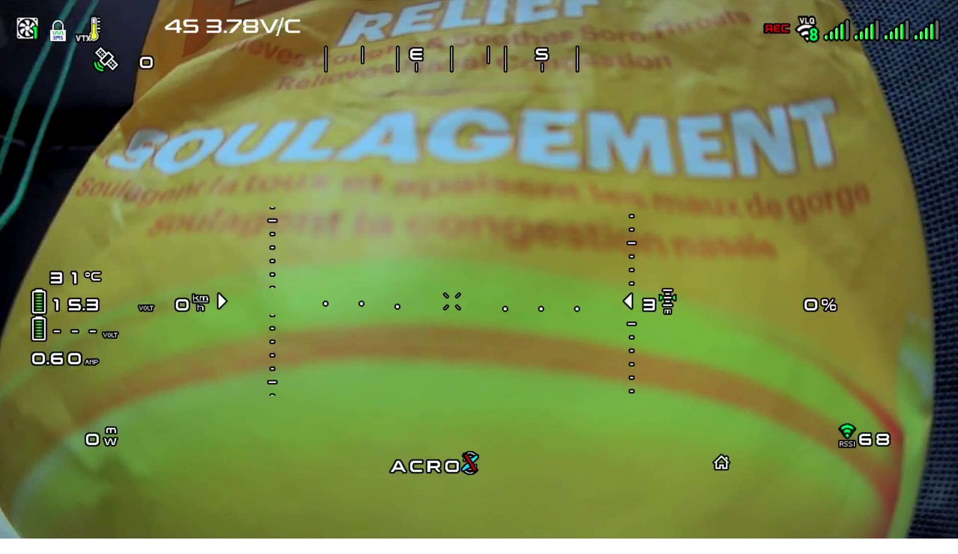

Thank you for the reply. I think I must have been confused. I thought “DisplayPort” was a protocol in and of itself. But I need “DisplayPort” and MSP both, if I understand you and the following image correctly:
So if I’m out of UARTs, my only option is going to be to use stick commands.
Right and SmartAudio is not really recommended for HDZero. I’ve added MSP VTX to my list but might take me a while.
