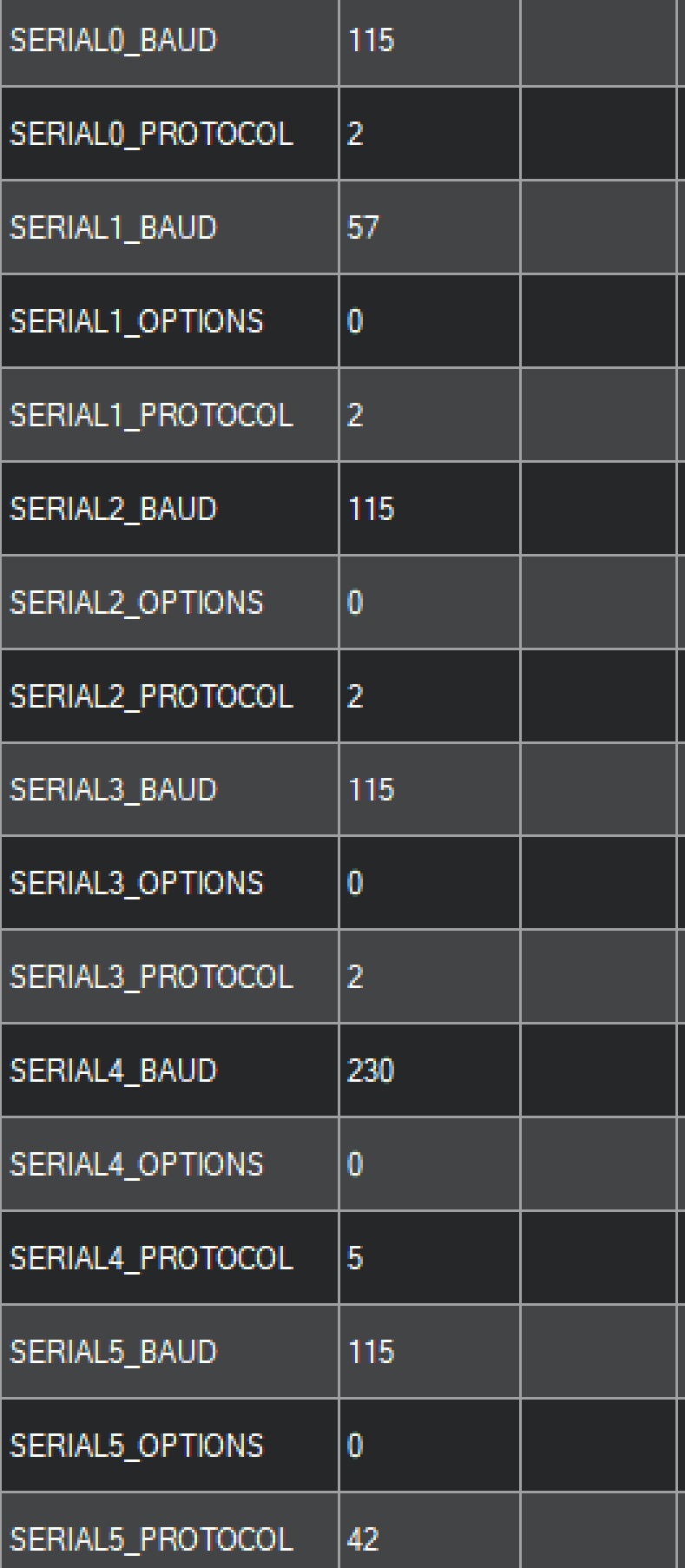

  • My Serial 7 (Uart6) Params are set to RC IN (23)

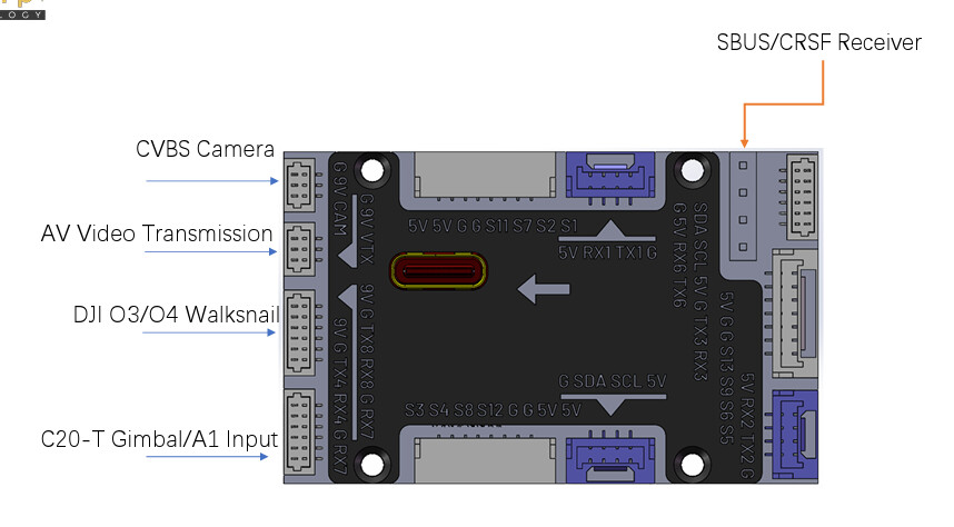

  • I have double checked my wiring. SBUS coming from the Air Unit has Ground and Signal > Ground and RX on the UART6 (noted in the SBUS diagram).
  • The UART1 on the air unit goes to the 5v - RX1 - TX1 - G on the FC (upper blue plug). Yes RX and TX are flipped on the FC side.

Unless I missed it, I’m not seeing the hardware definition file for your FC.
Is it possible that that SBUS needs to use a different UART/Serial?
ETA: You might try setting SERIALx_OPTIONS = 3 for inverted logic.
Thanks Mike! Unfortunately the FC came in the plane already wired to the power, servos, etc. This FC does not have much documentation which is what is killing me. I will try the invert and get report back.
I changed the Serial7_option to 3 with no luck.
Double check that there aren’t any other serial ports set to RC input (SERIALx_PROTOCOL,23).
When you’re troubleshooting, keep in mind that any changes to serial ports only take effect after you power cycle or reboot the controller.
There’s no info out there for that controller… not a good sign. Just for giggles have you tried setting SERIAL 6 to match tx/rx6?
Might have to reach out to the manufacturer and ask them.
