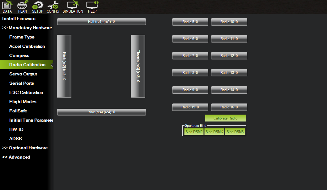

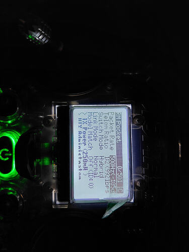

RC not found (Radiomaster Pocket internal ELRS + Drone Speedybee Elrs + SpeedybeeF4V3)

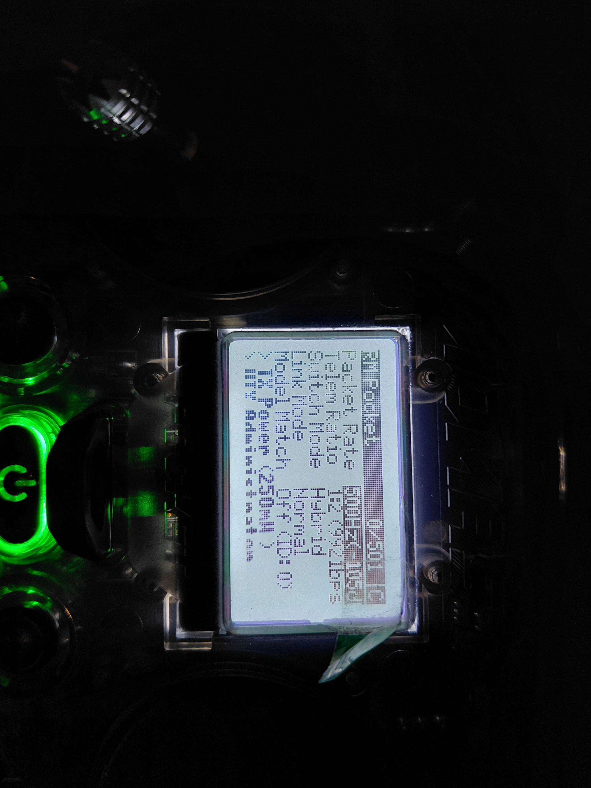

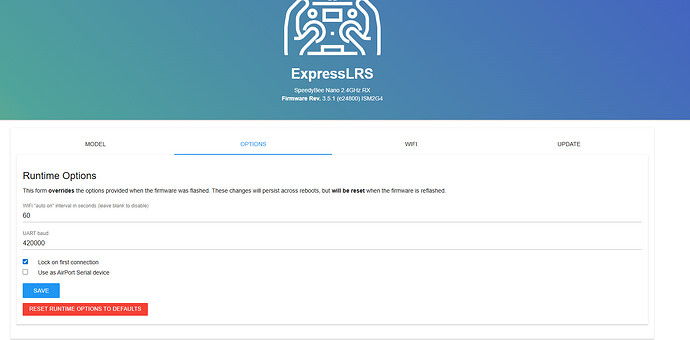

TX and RX elrs configuration

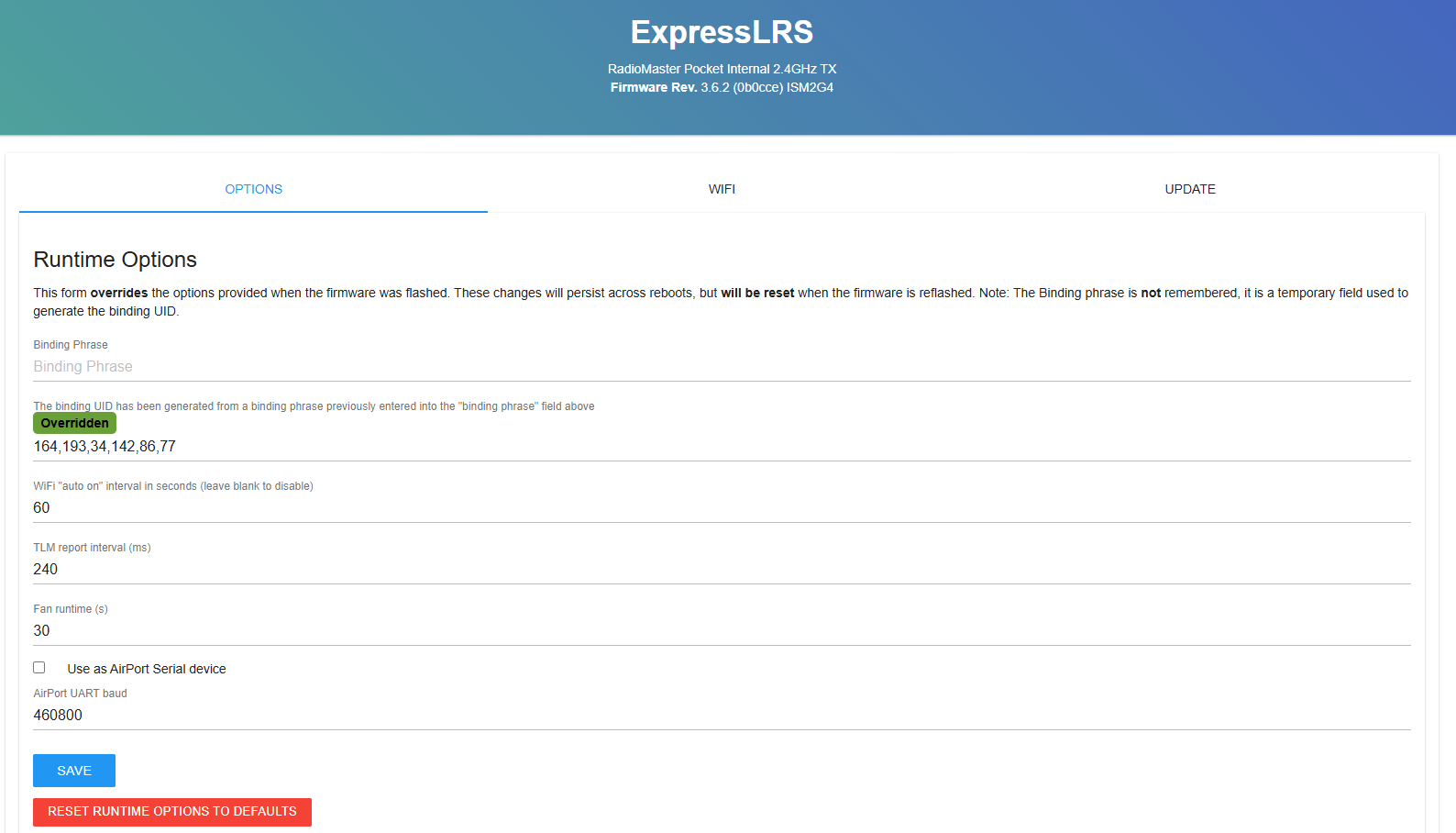

Radiomaster elrs configs:
As you see tx and rx boud.

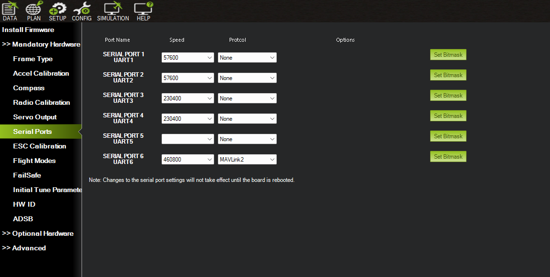

Mission planner configs:
Serial port is 6 and it configured but RC still not found.
Use serial protocol 23, RCIN.
