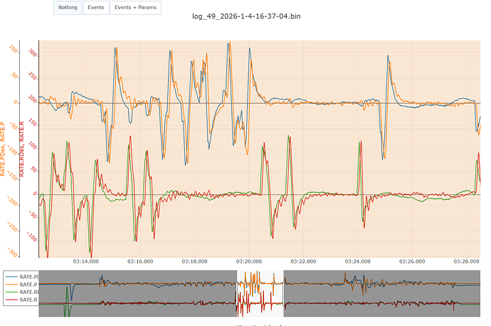

The tune isn’t that great and the Motor Ranges are at default. And perhaps the same place you got the RPM parameters the Batch Logging parameters are misconfigured. In fact with that Flight Controller don’t use batch logging at all. Set these
INS_LOG_BAT_MASK,0
INS_LOG_BAT_OPT,0
INS_RAW_LOG_OPT,9
I would set the Rate P&I values equal for Pitch and Roll. Set the Motor Ranges properly. Make a hover flight to collect data to review the notch filter. Re-configure that if required and then run Auto Tune.

I also noticed that the log i posted is missing a lot of the flight. Here it is again.
log_49_2026-1-4-16-37-04.bin
Then why do you have MOT_SPIN_MIN at default which is 15%? You didn’t follow the procedure.
