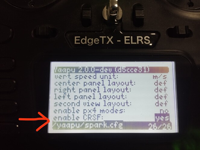

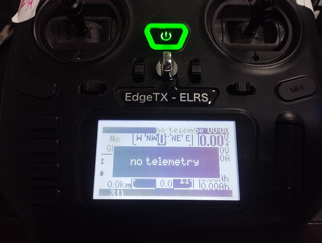

Hey there am using radiomaster tx12 Elrs and kakute H7 v 1.3
Elrs 3.3.0
Edgetx tx12 MK2 with 2.8.0 version
Kakute 4.6 arducopter
Am receiving massages from arduopilot
When push Tele in my radio I have " no telemetry" but when scrolling right I can get all massages
What the problem

RC_OPTION,288
And make sure in the Yaapu settings on the radio you have selected CRSF telemetry.

RC options 288 didn’t solve it

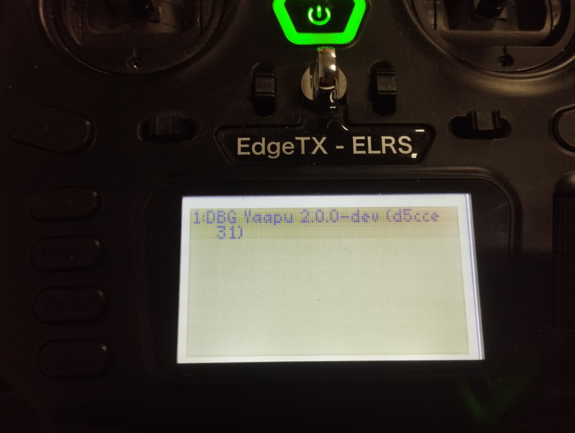

The script is running but I need the interface like that

The yaapu script configuration is model specific. If you rename or copy or do anything to the model of the drone in EdgeTX then you’ll loose the configuration for the script.

How can I check that
I have the original files of the script dev 2.0
I think I didn’t make any edits

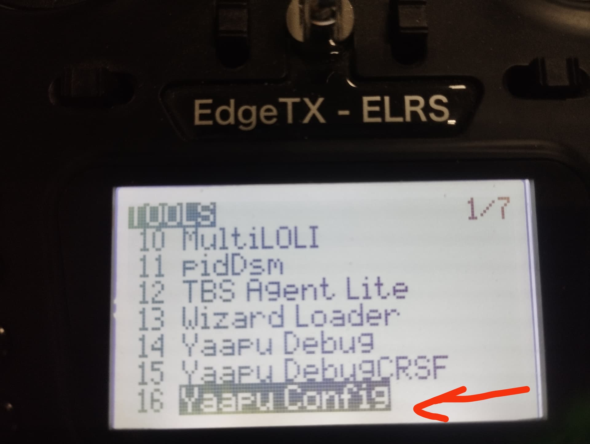

In models>yaapu I have spark.cfg this my model
Should I rename yaapudev.cfg with spark.cfg and delete old one ?

You shouldn’t need to touch that. Look at the link posted by @menschel
