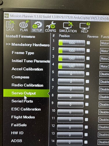

I’m building a quadcopter from scratch following the UDEMY course. I have it built but when I tried a test flight, it flipped on its side. I’ve been through the calibrations many times. I’m trying to understand what may be the problem besides replacing the cheap ESCs and motors. I’m using a MATEK F405-TE controller. I’m struggling understanding the huge amount of data in the log but this caught my eye, but I have no idea what to do with it.
Screenshot 2025-04-06 at 7.38.45 PM
The bin file is huge and I can’t upload it. So, I could also use some suggesting on what to log and what not to log for future flights.

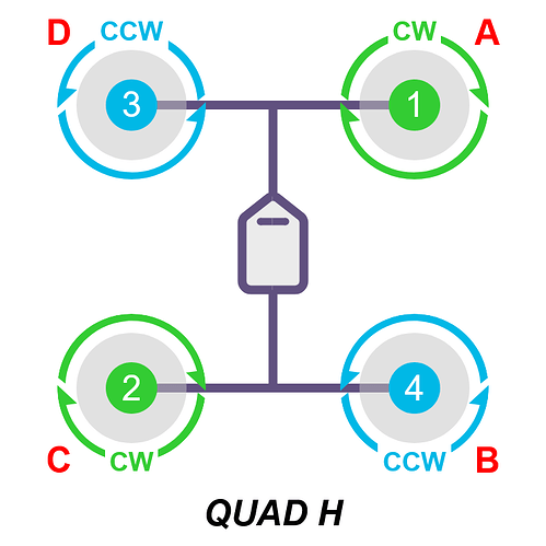

The motor order and/or direction is incorrect.
Thanks for the quick reply. That was my first, second and third concern. Obviously I am missing something. Where I test the motors, the appear to be correct and turning in the right direction. What am I missing?
The correct motor order is ABCD , not 1234.
ABCD = 2134 on the Flight Controller = 1423 on the X-copotr labeling as I map it out using the documentation in Mission Planner. As I said earlier, when I test the motors, the are rotating in the right direction and I have the propellers providing lift, just not evenly. Anyone else with ideas?
You are really making this a lot more complicated than it is

Now test the order in Mission planner: A, B, C, D
If incorrect and only if incorrect , change the FC → ESC connections, or exchange the SERVOx_FUNCTION Between the SERVO1, 2 3 and 4.
An why are your pictures all pointing to the left, That confuses me, and I bet it confuses you too.
The copter pictures always points up.
OK, here is an image directly from Mission Planer. A=1, B=4, C=2 and D=3. That would be great if the MATEK T405-TE FC was numbered the same way, which is 2,1,3,4. I took you advise and oriented all up. (I rotated the MP image to match then MATEK documentation) So, by my understanding,

Run Motor Test and note which motors run when you select the A thru D buttons. If they are incorrect as per the FRAME_TYPE you have set, and the illustration, re-factor the SERVOx_FUNCTION parameters until they are in the right order. And then of course make sure they also run in the correct direction.
That’s it.

I agree that replacing components is not the best approach, but I am at a loss to diagnose the issue further than I have. I had no idea that the Methodic Configurator was available. Wow, what a resource!! That is incredible. I looked at “hardware to avoid” and my quadcopter build uses most of those mentioned. I’m just shaking my head, I installed new ESCs and motors and triple checked rotation using Test Motors and also when armed and attempting to fly, but the copter still flips on its side. Is there a way to use the Methodic Configurator using the FG450 frame and the unrecommended ESCs and motors? I just want to get the copter in the air.
