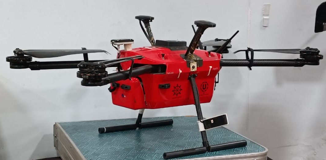

It’s a T-Drones M1000 drone with two MicaSense MX cameras as payload

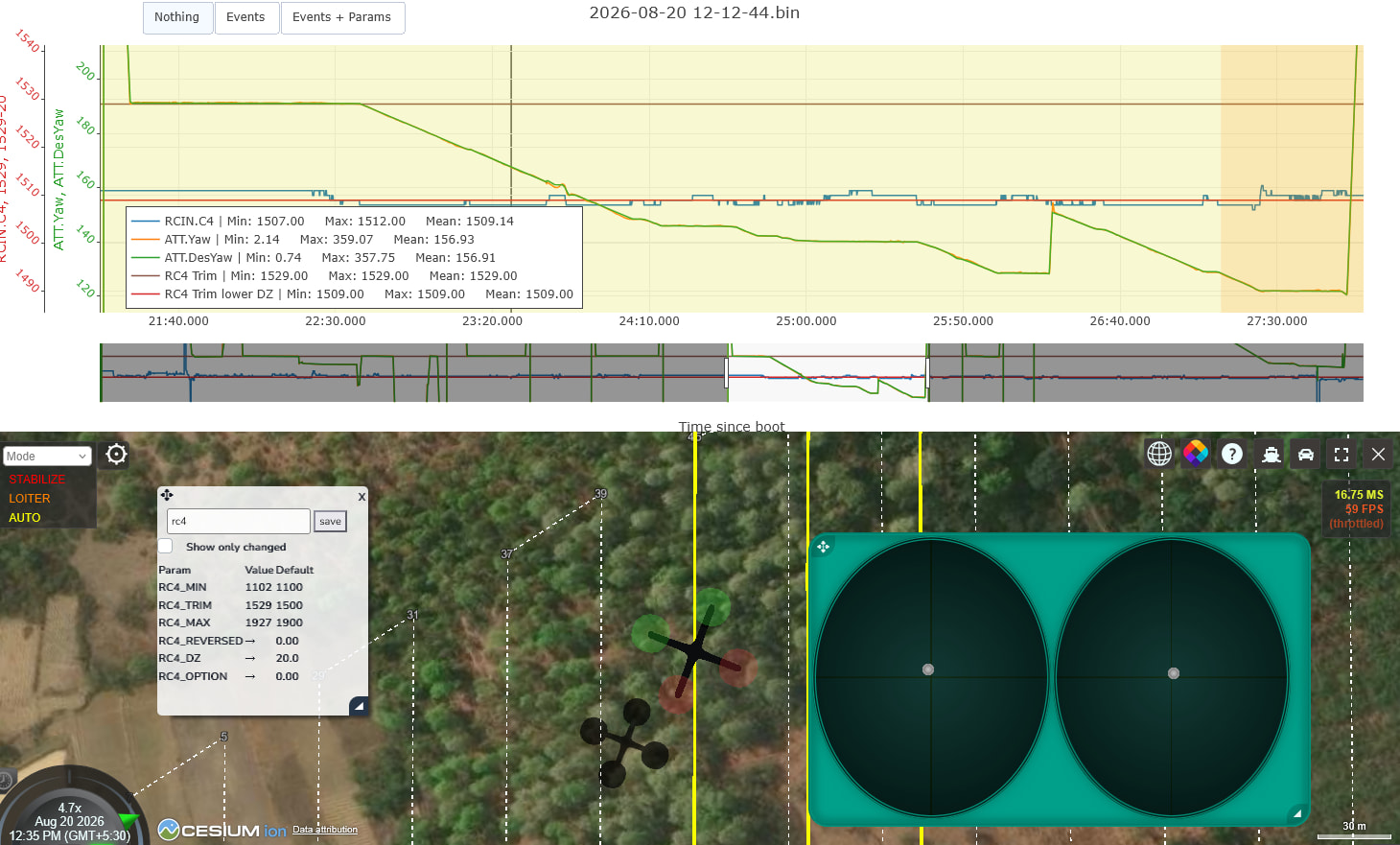

During an AUTO mission, the quadcopter sometimes behaves as follows:
  • The vehicle flies along the desired mission flight path, but its heading/yaw is oriented in a different direction.
  • The yaw offset remains almost constant throughout a particular flight leg. In other words, the vehicle may be travelling north along the planned path while the nose is pointing, for example, 20–40° away from the direction of travel.
  • The vehicle does not necessarily exhibit this behaviour on every leg or every flight. It’s kind of random. Sometimes the same/similar mission executes normally, while on other flights this issue occurs.

Updating from 4.4.4 to latest 4.6 or 4.7 might help, there was some bug fixes regarding waypoint yaw handling. WP_YAW_BEHAVIOR looks correct, but you can try 3 instead of 2.
Recalibrate your remote, it might override autopilot yaw, you have RC4_TRIM set to 1529 with 20 as DZ, while getting ~1509 from RC, that can be a reason too.
You also have the filtering misconfigured, it can fly better.
RC transmitter trim would clearly cause the issues you are seeing
Per Amilcar’s suggestion, RC issue
