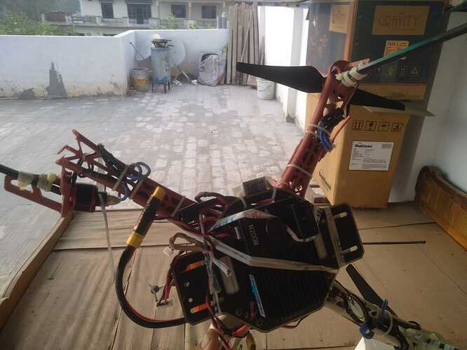

Quadcopter crash diagnosis
Copter-4.6.3 with N200 VIO Module, crashed today.
Prior to this flight, I had three perfectly ok flights without this module.
Set the parameters as per the module’s manual attached.

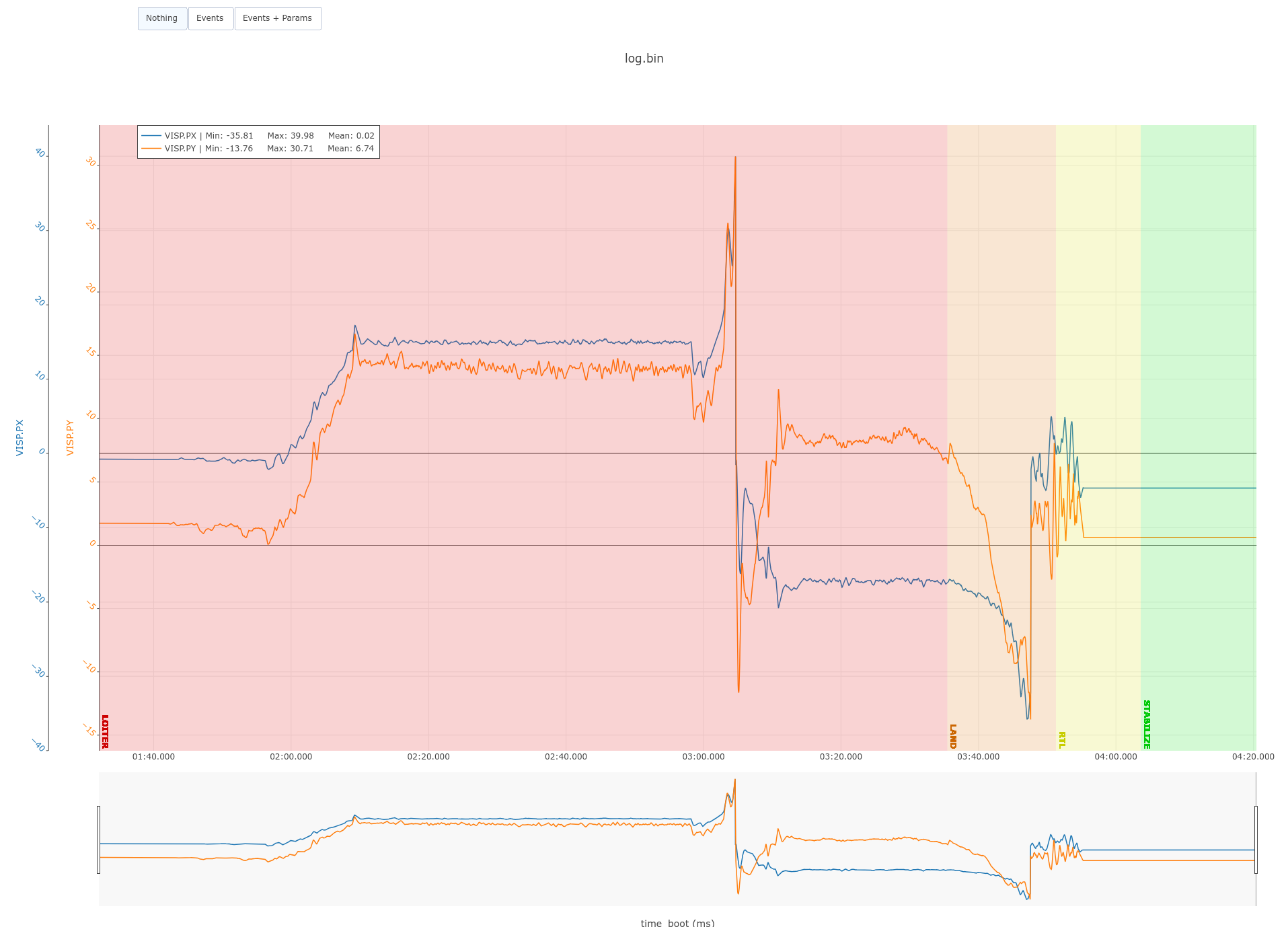

My impression for this one is that N200 VIO has nothing to do with the crash, as it was actually not used. That thing was set up as source #3 for EKF position, but nothing was configured to switch to this source. This part of the manual:
If visual positioning is used, the EKF estimator must be switched to the corresponding
source. The specific switching method can be found at:
EKF Source Selection and Switching — Copter documentation

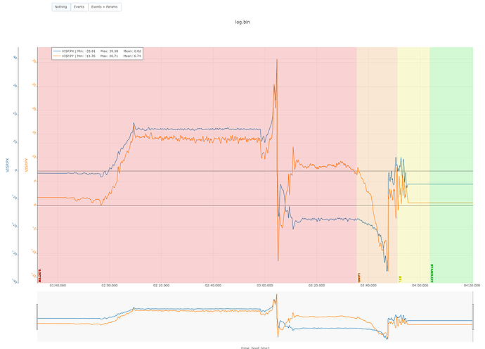

was apparently not implemented, as none of RC channels is configured for source switch. It does not seem to be extraordinarily reliable in your case anyway, because in your log it experienced two sharp position resets:
They are somehow correlated with attitude changes, which (odometry problems at non-trivial pitch and roll) is a common thing for various reasons (loss of distance estimate, quick change in visual features and loss of tracking, etc.).

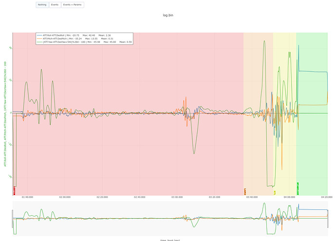

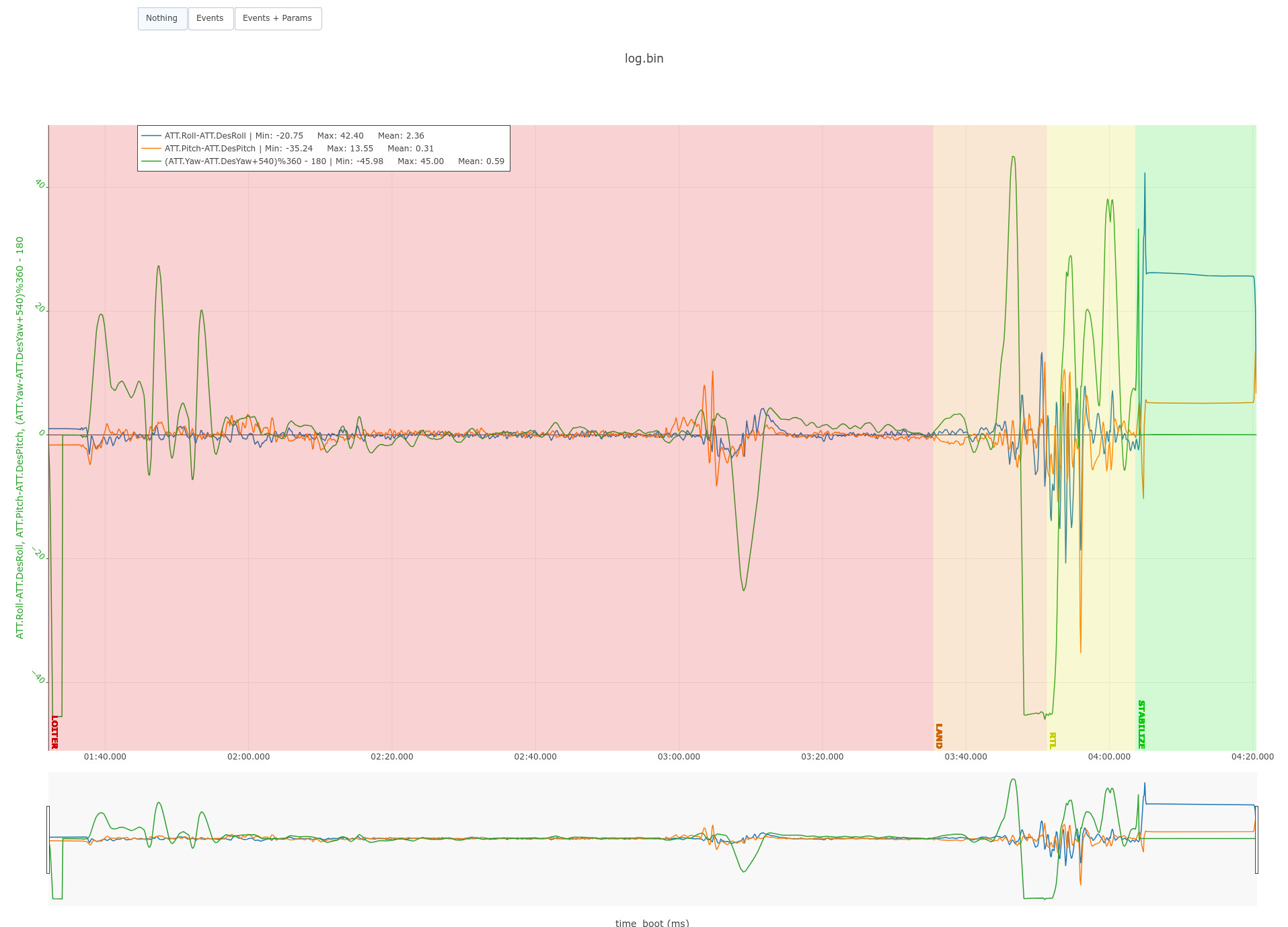

This is why I tend to search the reasons for this crash in other places. Which seems to be at least two things: lack of tuning and being underpowered. First, you have not performed any PID tuning whatsoever, and the fact that the machine is somehow flying is solely because the default PID configuration is for an old machine of roughly this size and same battery voltage. This is your machine’s difference in desired and actual roll/pitch/yaw, and all of this is quite poor, but especially yaw.
One may or may not like the Ardupilot Methodic Configurator, but tuning the low-level subsystems is a must before attempting to use higher-level subsystems (like odometry). Your lack of tuning was an incident waiting to happen, and it finally happened, because it’s very difficult to fly reliably if your yaw is off by up to 45 degrees.

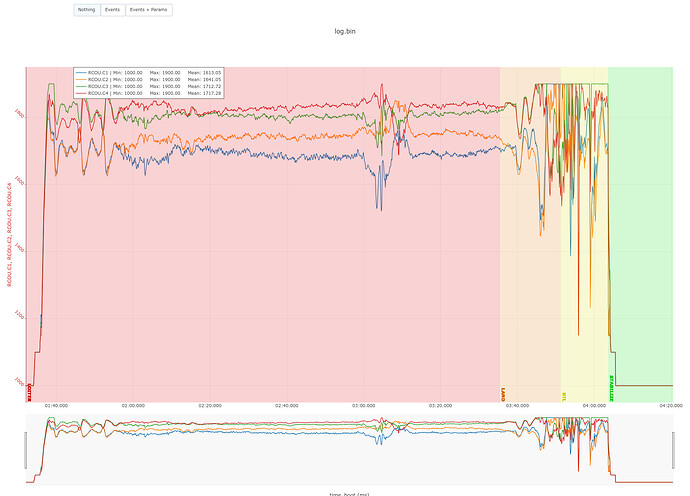

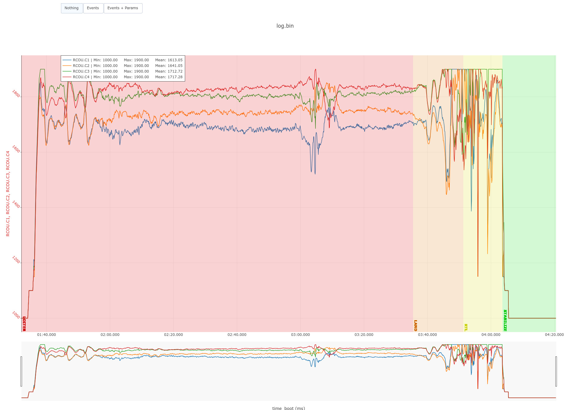

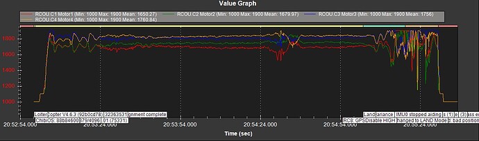

The second problem - and likely the main reason for yaw to be that poor - is that your machine is sufficiently imbalanced and underpowered at the same time:

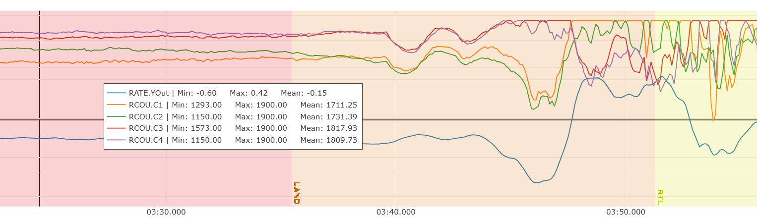

Here, even in the calm region of the flight (02:20 to about 03:00), which is just hovering as can be judged from GPS logs, your motors rotate at way too differing speeds, and one in particular (motor 4, red plot) is running close to its maximum (1820…1830 out of 1900 for the PWM value). The second runner-up is motor 3, and the fact that both are the clockwise motors suggests that you have a yaw imbalance. Normally this happens because some motors are way off-vertical in a way which is not supposed to happen. What exactly causes this on a frame where there is only one way to mount the motors, is unclear, but the yaw imbalance is huge.
Whatever extra output is commanded atop of that, and chances are high that some motors start hitting the maximum threshold. This is exactly what is happening after 03:45 where motor 3 is pretty much permanently saturated. Perfect control of all four axes (roll, pitch, yaw, thrust) becomes impossible, yaw gives up, and with pretty much no pilot input this is a crash.
Yes, this is grossly underpowered/overweight. On default parameters it should have never left ground.

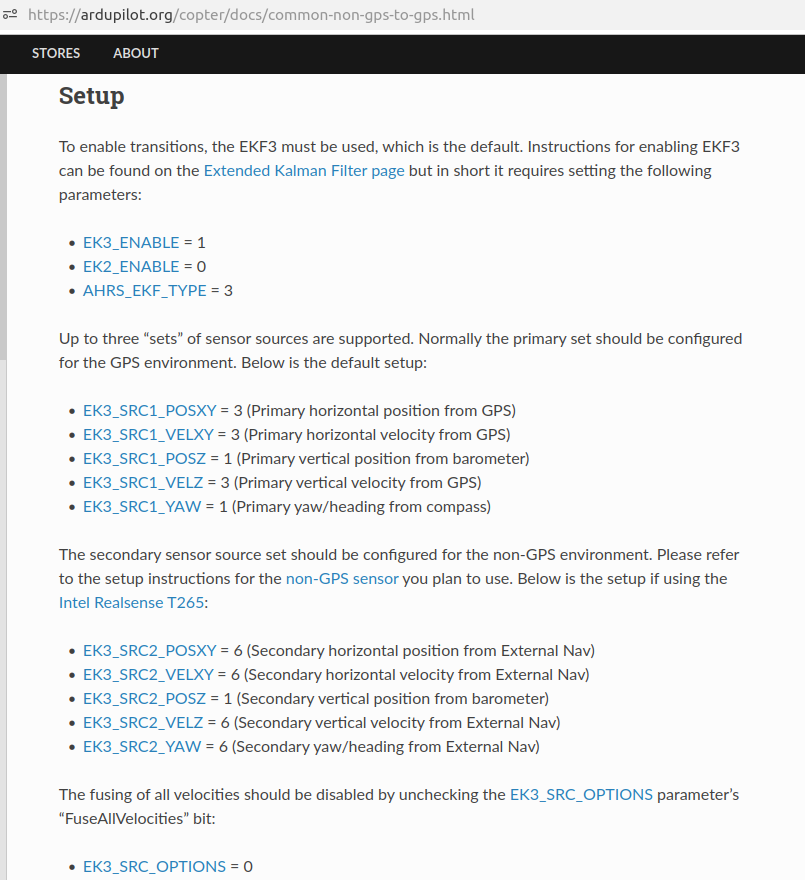

First, Ardupilot will not immediately switch to an alternative configured somewhere in the sources. Switching GPS off is not the correct way to test odometry. During your flight for which the log is attached, you turned GPS off around 03:27, and at 03:35 the copter switched to Land because it started to see that no updates are coming from GPS so it lost the position estimate. Notably, it did not even try to switch sources (the XKFS.SS log entry stays 0 means SRC1 for the entire flight).
You should either switch between sources using RCx_OPTION = 90 or use some scripts to automate the transition - as detailed in the GPS-to-non-GPS wiki.

In the N200 module’s manual it says “Set the position source of a free EKF3 instance to ExternalNav”
what he means by “free EKF3 instance” ?
If RCx_OPTION = 90 is configured for a two-position switch, then everything from EK3_SRC1_* is used when the switch is low (e.g. away from you), and everything from EK3_SRC3_* is used when it is high. Source 1 for low, source 3 (not 2!) for high.
Your latest config is wrong: it only has EK3_SRC3_POSZ to be non-zero. You have to set these:
  • EK3_SRC3_POSXY = 6 to use your N200 module
  • EK3_SRC3_YAW = 1 to continue using compass for yaw

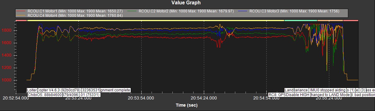

Yaw imbalance is possible to check with Yaw rate controller
Craft cannot keep from yaw rotating, flying underpowered drone on 2 motors was too much.
Thank you so much Mike for your support on pointing to yaw imbalance !
I would measure rpm of each motor on same throttle input pwm value under load and rectify it.

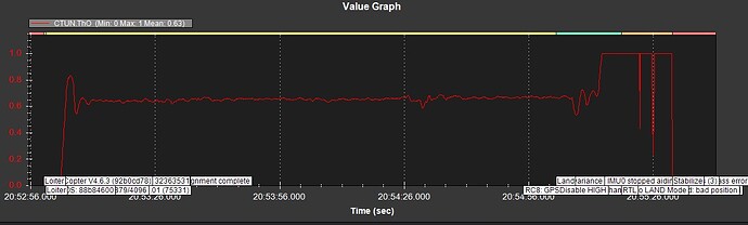

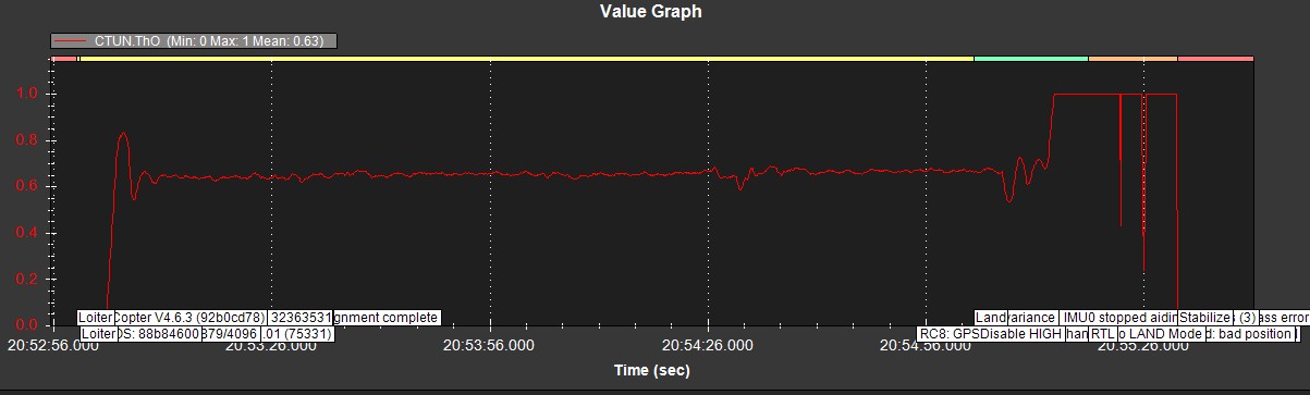

That is far from the truth. This craft is grossly underpowered/overweight. The log shows a litany of Thrust loss errors as a result. It also has a mechanical Yaw bias and the remedy you suggested makes no sense. The tune is terrible of course as it’s on all default parameters. You didn’t even set the Initial Tune Parameters. You know, the ones that are shown in Mission Planner under Setup>Mandatory hardware
This is a billboard for what not to do. Someone with your lack of knowledge should be using the Methodic Configurator
Forget about switching the EKF source until this thing is actually flying properly. Or perhaps you will damage more than a frame arm.
