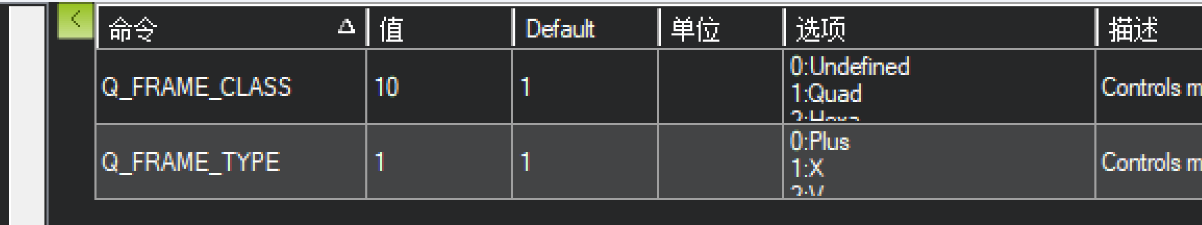

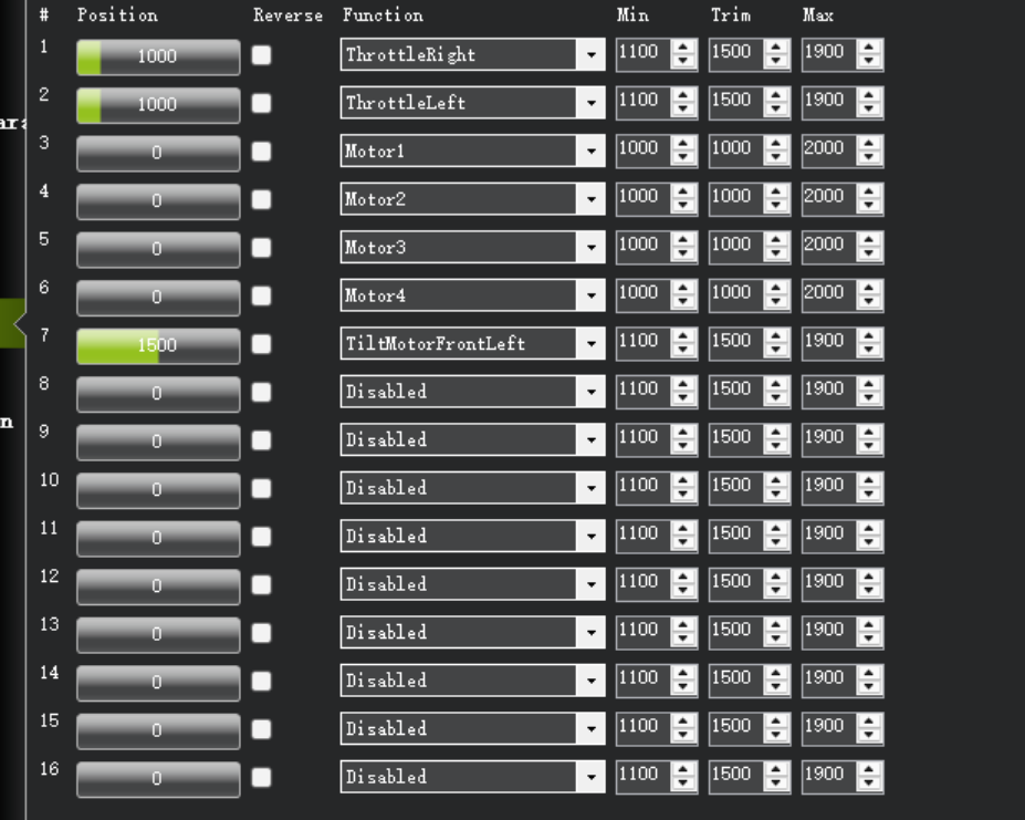

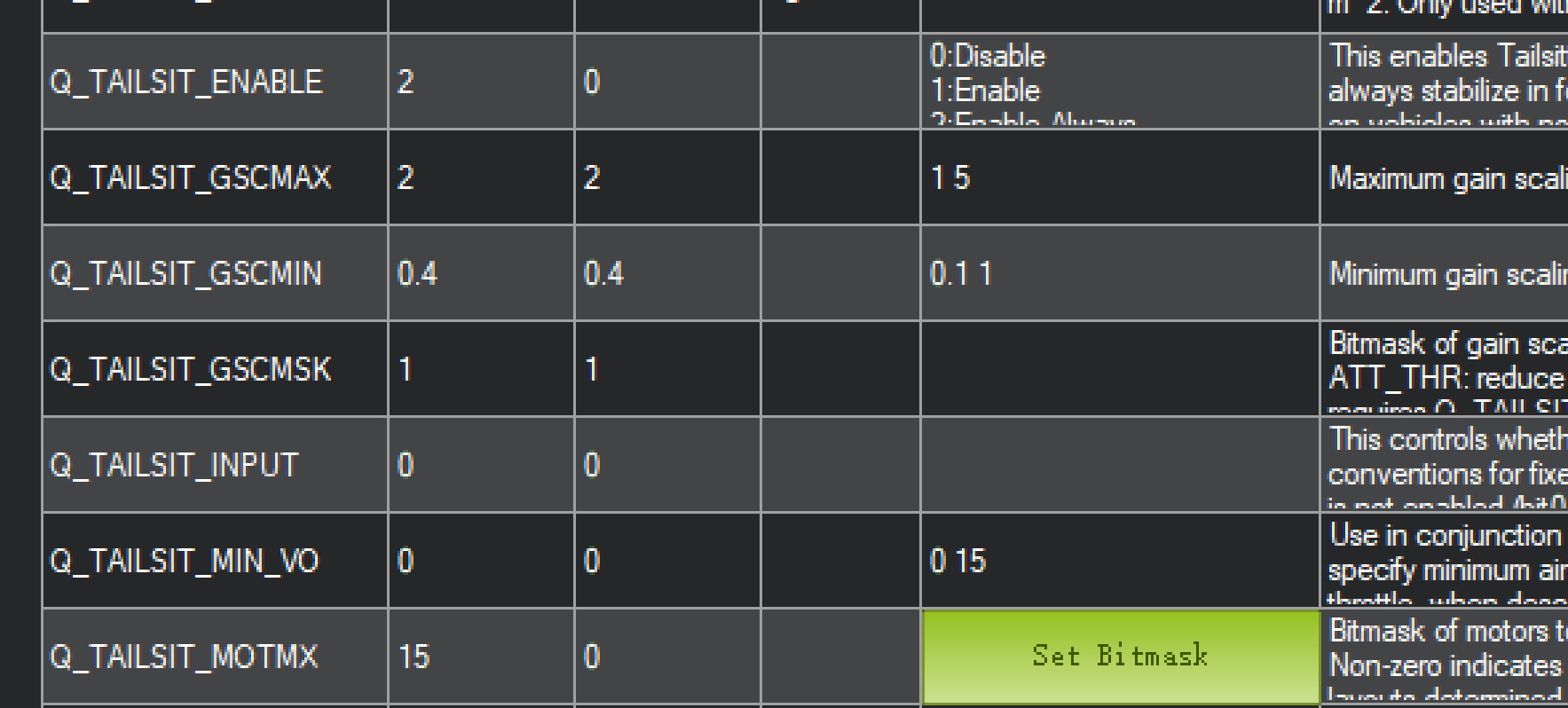

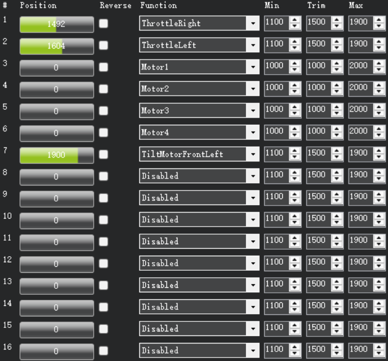

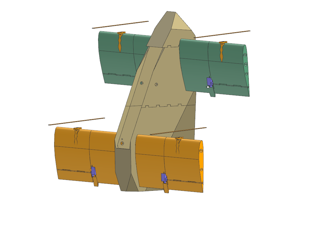

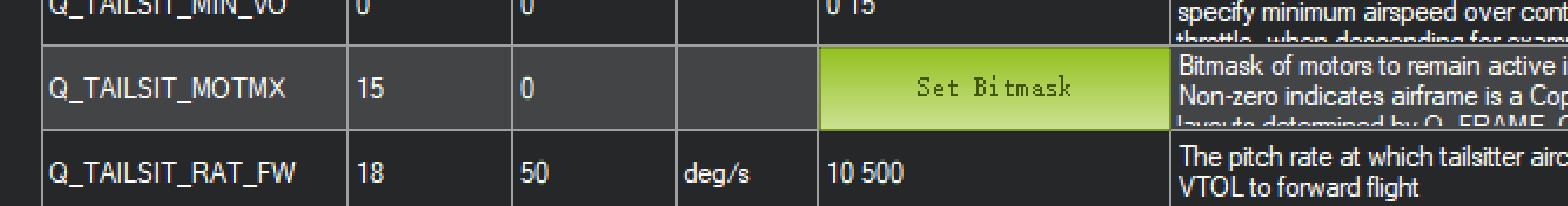

I’m designing a VTOL aircraft like the one in the picture. It has four motors and can take off with the nose pointing up, similar to a multirotor. It can then enter fixed-wing flight mode. I set the main parameters for the aircraft according to Tailsitter Planes — Plane documentation. However, after unlocking it, I’m finding that the motors have no output.
I’d appreciate any help. Thank you.
x.param (25.3 KB)
Q_FRAME_CLASS should be 1 for quad.
Thanks, that’s the parameter. Now it can take off.

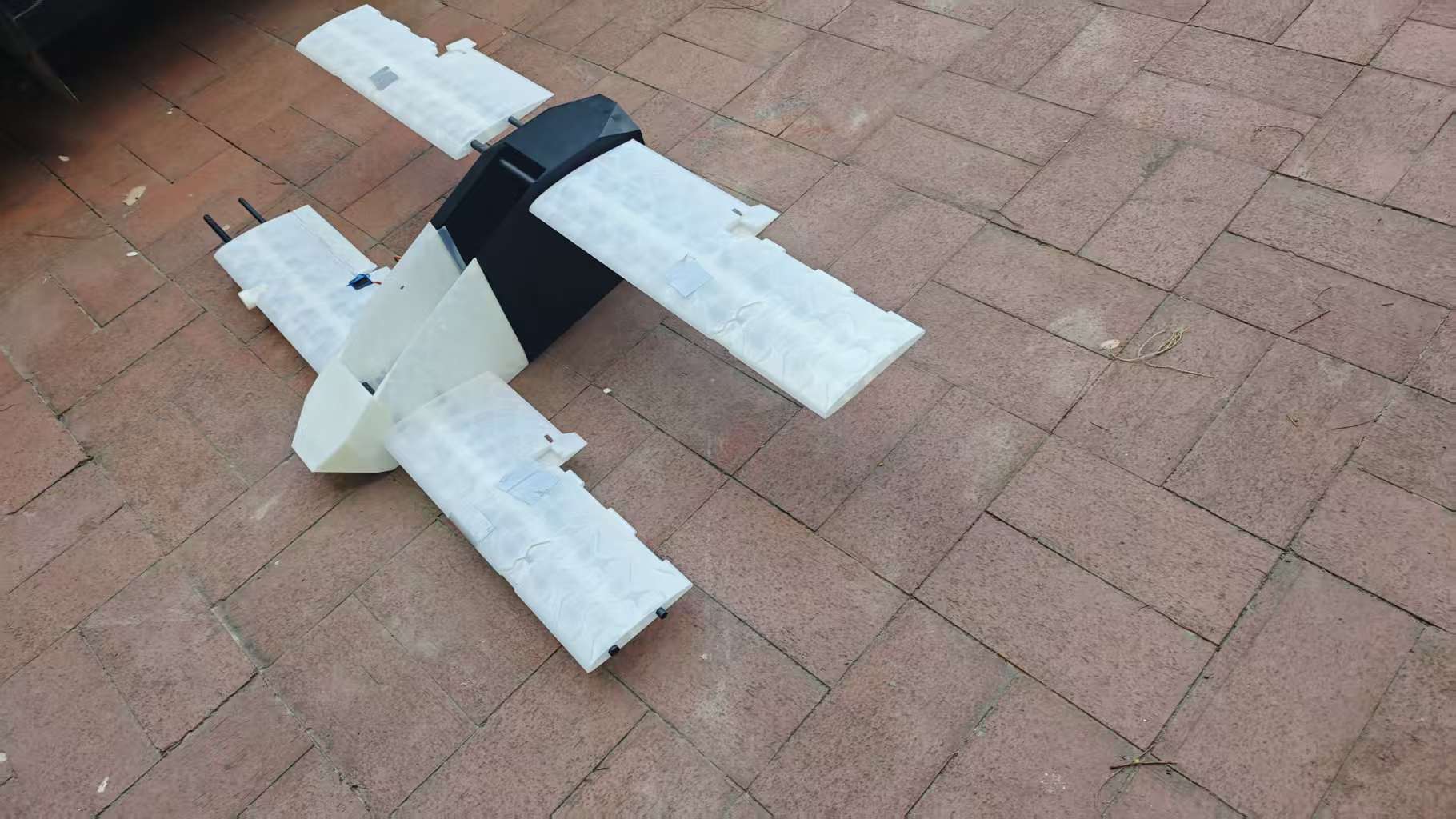

thats really cool! did you transition it yet? what material did you print the vtol from?
Sorry, I haven’t logged in for a long time. It’s fully operational and flying normally now. It uses ASA materials, with one layer of exterior walls and 6% infill. Here are the blueprints.
Hwing.zip (187.0 KB)
Amazing! did you have any issues with tuning the aircraft?
There are no major issues, and the issue of excessive computational cost during hovering is not a concern. :slight_smile:
