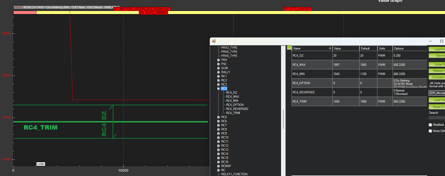

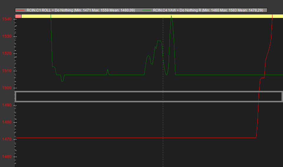

You have RC input exceeding deadzone for ROLL and YAW (according to Your params, gray area is about to be no RC input)
Calibrate radio (on Your transmitter, reset trims if used) then calibrate radio in arducopter using mission planner.

I performed radio calibration and did a test flight , but now the quad is automatically yawing towards right ,but its not getting drifted now
i am attaching the log , kindly let me know if this is related to any other parameter issue or structural issue
thanks!
Word of explanation - You RC channel values has to be in range of TRIM ± DZ. So… It looks like Yaw channels is outside of this zone and this is considered as non zero yaw input.
Not sure what kind of radio You use, but You did not calibrate it very well or did not calibrate rc inputs in mission planer, or radio is a bit crappy and can not hold center value very well, or centering spring is not strong enough.
Easy fix is to increase DZ value, to keep whatever value RC4 has inside dead zone. Move stick left, then release and see channel value, move to right, release and see channel value.
make middle value of that as TRIM value, and difference between readins Your dead zone (technically half od this difference, but You want/need some margin I guess).
