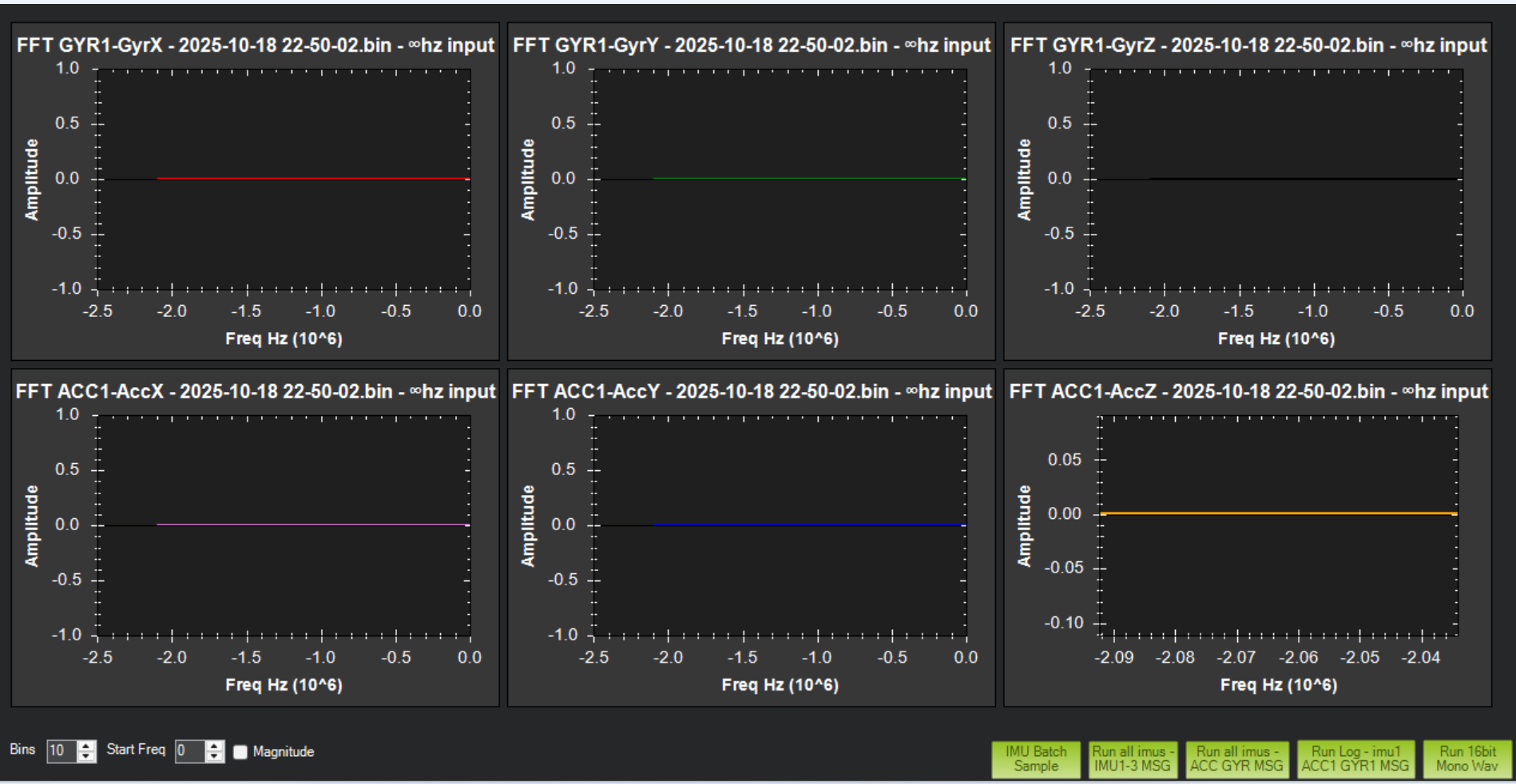

So the first thing to do in setting up a notch filter is to determine the center frequency.
I used the above log in Mission Planner’s FFT, and I got a weird result:
This is probably wrong. I got no output by using the first green button from the left, so, I used the 4th button from the left.

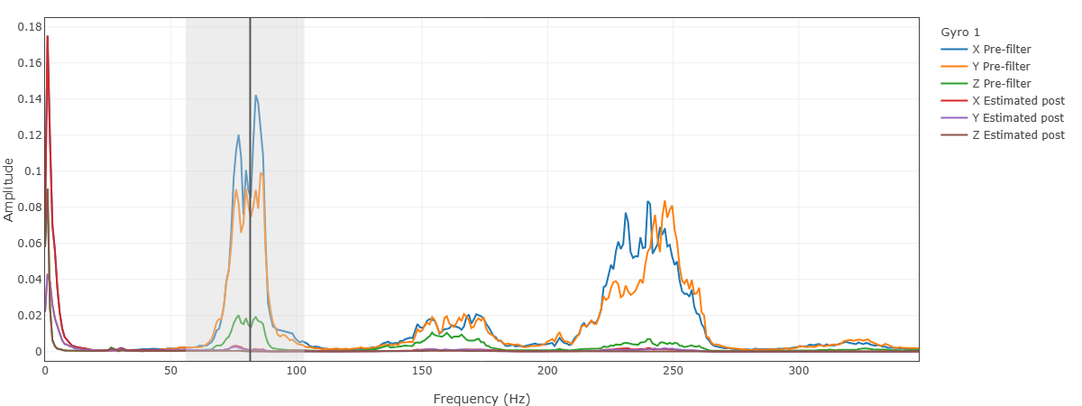

This is the new log file - https://drive.google.com/file/d/1Jh_IxTW_WF5hUJtm_VhT0C40rGWqh4nz/view?usp=sharing, and from the webtools, I think that I need to use 80hz base frequency.
But, what to do about the other noise at about 200hz (If I remember correctly)?
Those settings are a mess, try this instead.
filter (2).param (338 Bytes)
No more noise and a filter that correctly tracks the noise peaks:
