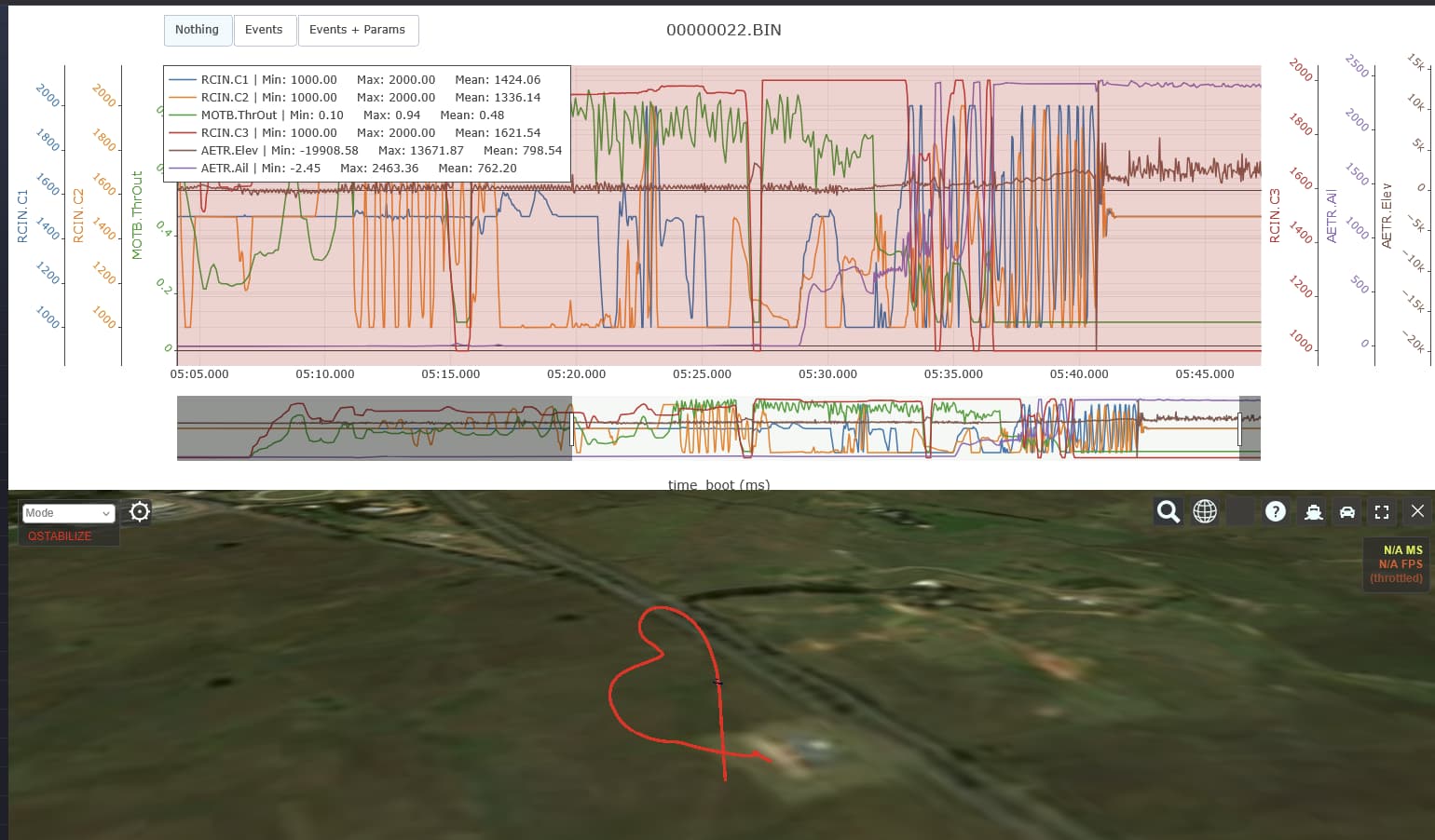

@hwurzburg, initial log and params were in my first message. I send them once again with the shorter flight.
attaching parameters:
sitl_init.param (32.2 KB)
and the log:
after several pitch moves, the plane flies away and does not respond to controls.
