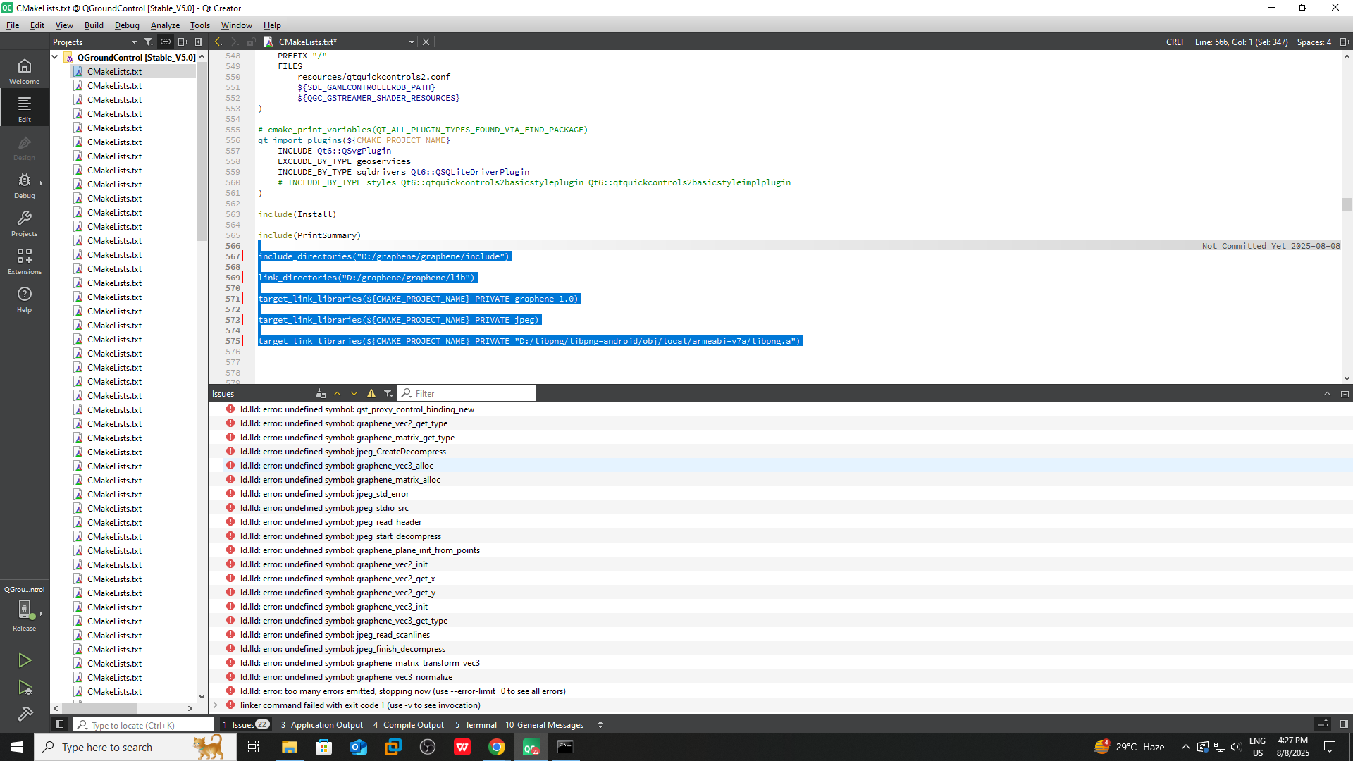

I am currently running QGroundControl v5.0 (stable release) with Qt 6.8.3.
Previously, I followed the official Qt guide for Android to successfully build and install the stable QGC v4.4 version with Qt 5.15.2 for both Android and Windows desktop.
However, since that version does not include the 3D View, I am now testing the newer QGC v5.0 stable release with Qt 6.8.3 to check if 3D View is supported.
I initially encountered multiple undefined symbol linker errors related to graphene, jpeg, and libpng while building QGroundControl.
To address this, I downloaded the required graphene and libpng libraries as ZIP files, extracted them, and manually added their include and lib directories to the CMakeLists.txt file. I also linked the static libraries (graphene-1.0, jpeg, and libpng.a) using target_link_libraries().
Could you please confirm if these manual changes are the reason I’m now experiencing the current linker errors? I suspect the issue might be related to architecture or compatibility mismatches.

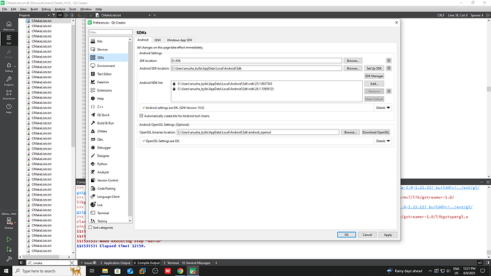

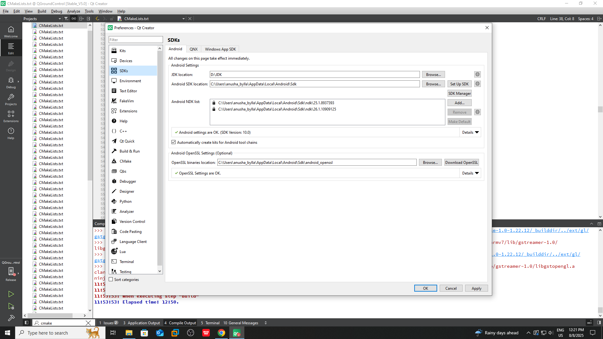

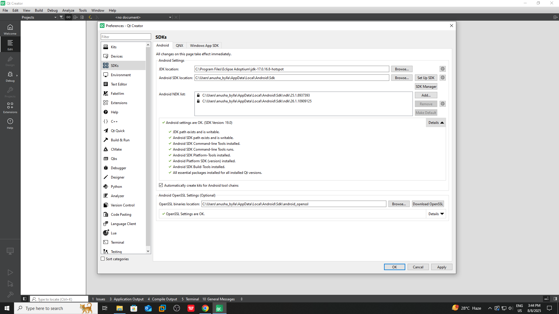

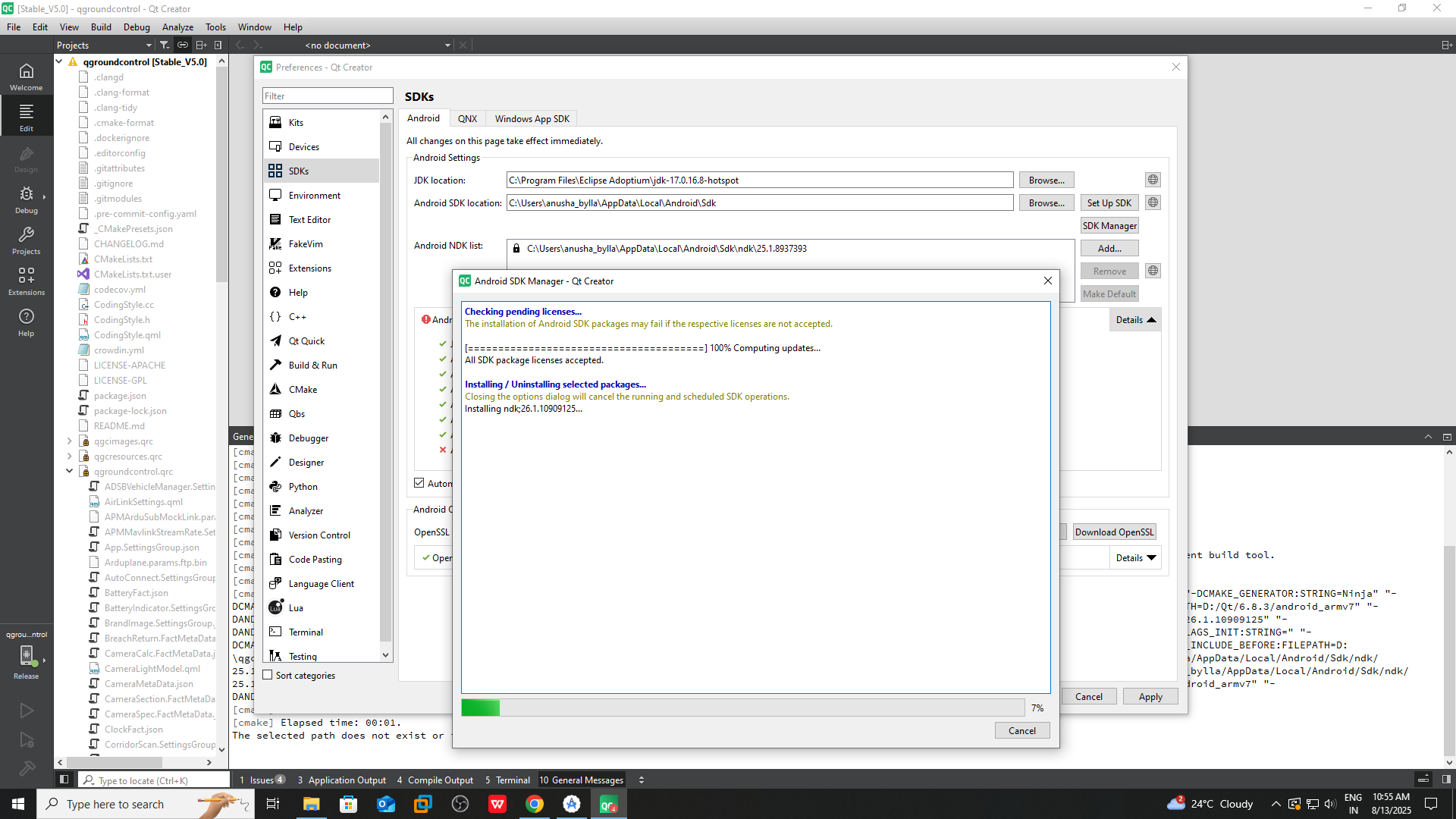

Hello, I’ve resolved those errors, but there’s one thing — the QGC guide says to install NDK 25, however it automatically installs NDK 26. Could that be the main reason I’m getting issues in the application output?
For the linking error, I studied GStreamer for Android and it was automatically resolved.
E/.qgroundcontro( 1138): Not starting debugger since process cannot load the jdwp agent. Art: Clearing App Profiles failed. D/NetworkSecurityConfig( 1138): Using Network Security Config from resource network_security_config debugBuild: false D/NetworkSecurityConfig( 1138): Using Network Security Config from resource network_security_config debugBuild: false E/libc ( 1138): Access denied finding property “ro.vendor.perf.scroll_opt.heavy_app” D/libMEOW ( 1138): meow reload base cfg path: na D/libMEOW ( 1138): meow reload overlay cfg path: na D/libMEOW ( 1138): applied 1 plugins for [org.mavlink.qgroundcontrol]: D/libMEOW ( 1138): plugin 1: [libMEOW_gift.so]: D/Qt JAVA ( 1138): Not in debug mode! It is not allowed to use extra arguments in non-debug mode. I/QtCore ( 1138): Start I/Qt ( 1138): qt started I/qt.positioning.android( 1138): Positioning start E/linker ( 1138): “/data/app/<del>faNWFpZSbMvg6fH-bEa-qw==/org.mavlink.qgroundcontrol-S-vRWL3mT_4zdEGGdRNS0A==/lib/arm/libQGroundControl_armeabi-v7a.so” has text relocations (******************************************************************************************************************************************* E/AndroidRuntime( 1138): FATAL EXCEPTION: qtMainLoopThread E/AndroidRuntime( 1138): Process: org.mavlink.qgroundcontrol, PID: 1138 E/AndroidRuntime( 1138): java.lang.UnsatisfiedLinkError: dlopen failed: “/data/app/</del>faNWFpZSbMvg6fH-bEa-qw==/org.mavlink.qgroundcontrol-S-vRWL3mT_4zdEGGdRNS0A==/lib/arm/libQGroundControl_armeabi-v7a.so” has text relocations (******************************************************************************************************************************************* E/AndroidRuntime( 1138): at java.lang.Runtime.load0(Runtime.java:939) E/AndroidRuntime( 1138): at java.lang.System.load(System.java:1628) E/AndroidRuntime( 1138): at org.qtproject.qt.android.QtLoader.loadLibraryHelper(QtLoader.java:497) E/AndroidRuntime( 1138): at org.qtproject.qt.android.QtLoader.lambda$loadMainLibrary$0$org-qtproject-qt-android-QtLoader(QtLoader.java:545) E/AndroidRuntime( 1138): at org.qtproject.qt.android.QtLoader$$ExternalSyntheticLambda1.run(D8$$SyntheticClass:0) E/AndroidRuntime( 1138): at org.qtproject.qt.android.QtThread.lambda$run$0(QtThread.java:57) E/AndroidRuntime( 1138): at org.qtproject.qt.android.QtThread$$ExternalSyntheticLambda0.run(D8$$SyntheticClass:0) E/AndroidRuntime( 1138): at org.qtproject.qt.android.QtThread$1.run(QtThread.java:25) E/AndroidRuntime( 1138): at java.lang.Thread.run(Thread.java:923) I/Process ( 1138): Sending signal. PID: 1138 SIG: 9 Art: Compiled App Profiles. 10:42:33: Android target “org.mavlink.qgroundcontrol” died.
Re. NDK:
You can download required version independently and then move into same folder as the other versions that you already have.
  • Careful, latest QGC master files are already based on NDK 27b. …unless it got changed again within the last few days.
Also when changing NDK versions you’ll have to fully close QT. The restart after a few seconds as it is known to ignore some changes whilst running. I also had it happen that I had disable all selected Android build kits. Restart QT and then activate the desired build kits before QT accepted my changes.
As specified in the CMakeLists.txt file, when using Qt version 6.8.3, the build requires Android NDK version 26.1. If any other NDK version is detected, the build will fail with an error.
