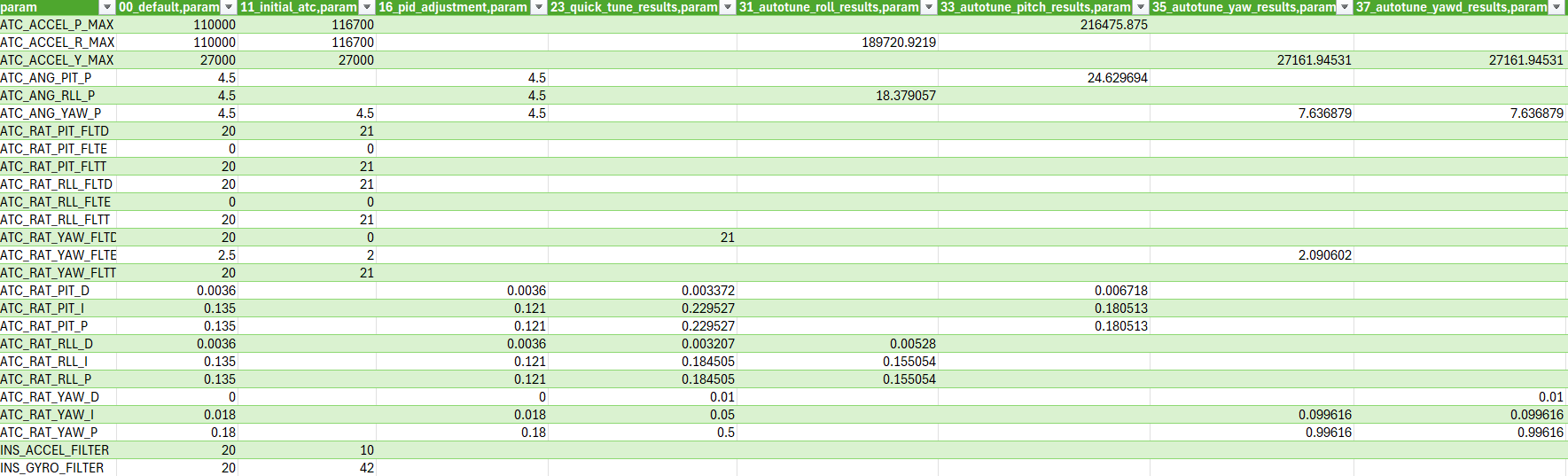

A similar feature is builtin ArduPilot methodic configurator. It generates this .csv file as output:
You can see how the PIDs change during the tuning process. When empty, there is no change.

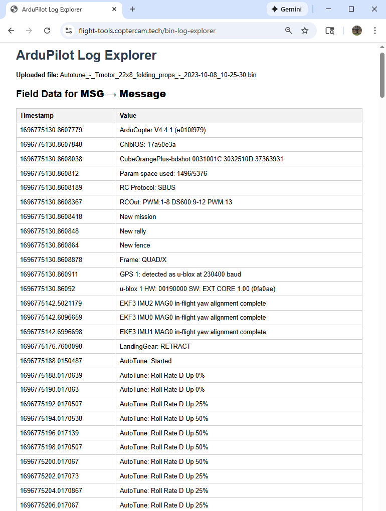

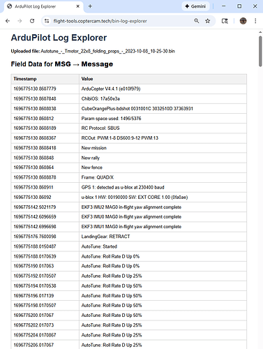

It’s been interesting to look into the log file data. Programs such as Mission Planner and MavExplorer do a great job of plotting data, but some of the data isn’t numeric and can’t be charted.
MavExplorer allows creating custom charts - also helpful. It isn’t a well publicized feature and it isn’t too difficult to use - it can be really useful. I’ve been thinking about useful reports that I haven’t found other ways to produce. Maybe most of them exist, I just haven’t found them yet.
My “log explorer” scripts make it easy to look around the data - by allowing the user to drill down by message type and field. One handy use of this is the ability to report all the mavlink messages for a flight.
