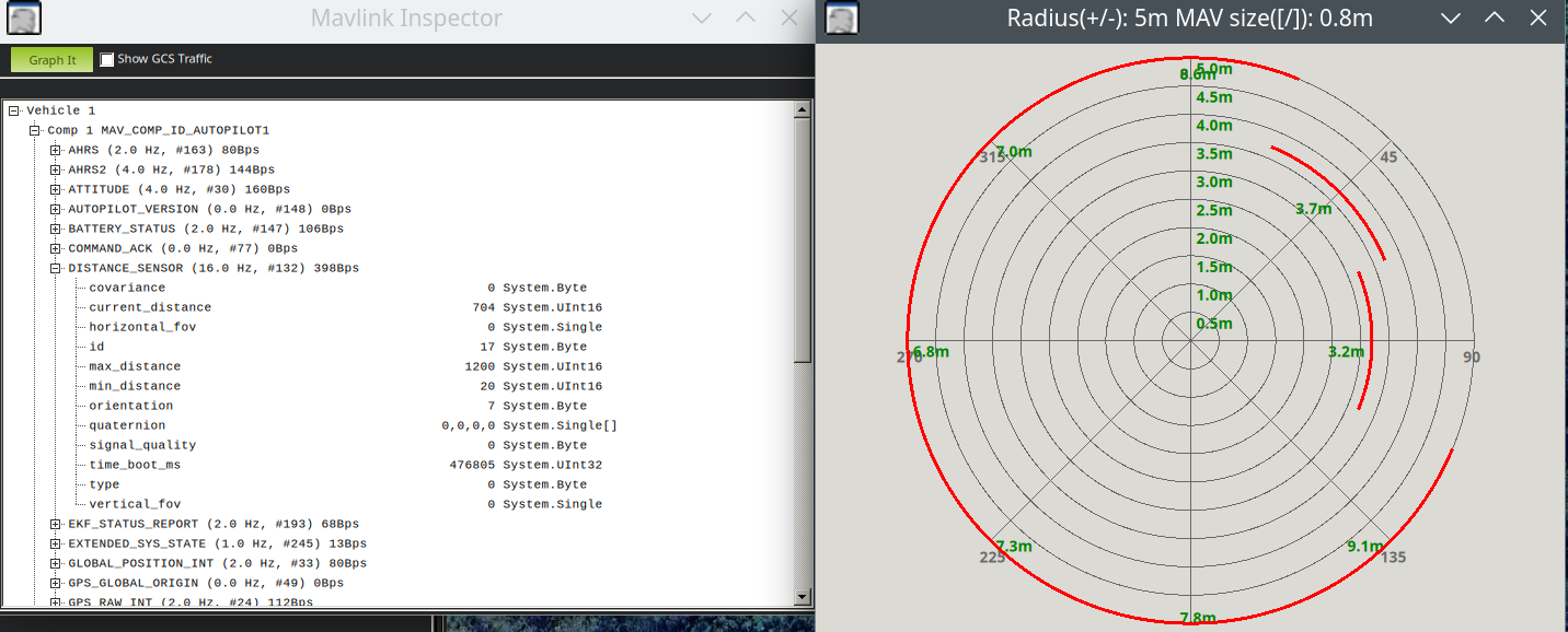

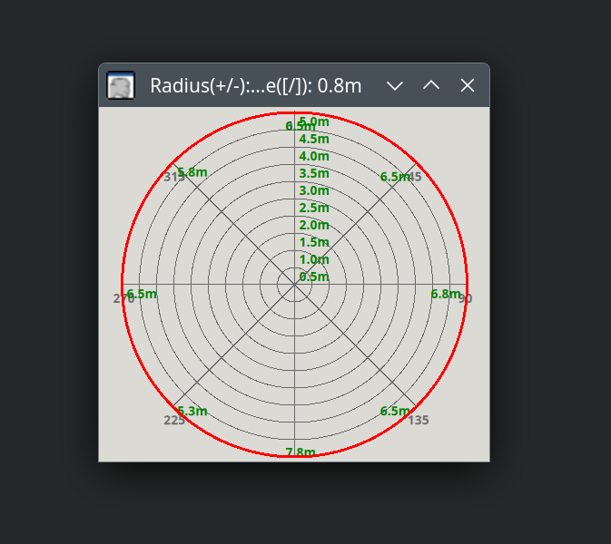

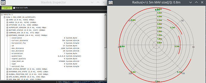

This was taken whilst rover was placed in a small garden shed. There is less than 1m from the LIDAR unit to the shed wall in any direction. Yet as seen in image it shows over 6m in distance. Did notice it briefly does respond to movement and indicate a closer proximity, but then reverts to readings seen in screenshot.

Done more tests and it would appear the unit of measure may be incorrect.
@tridge
In the parameter settings the values are in meters. Yet in MAVLink they appear to be in cm.
However, given that the walls of the shed my rover is kept in, are between 700-800mm away from the LIDAR unit in all directions, the distance readout would be correct if it was in fact in mm rather then the apparent cm.
