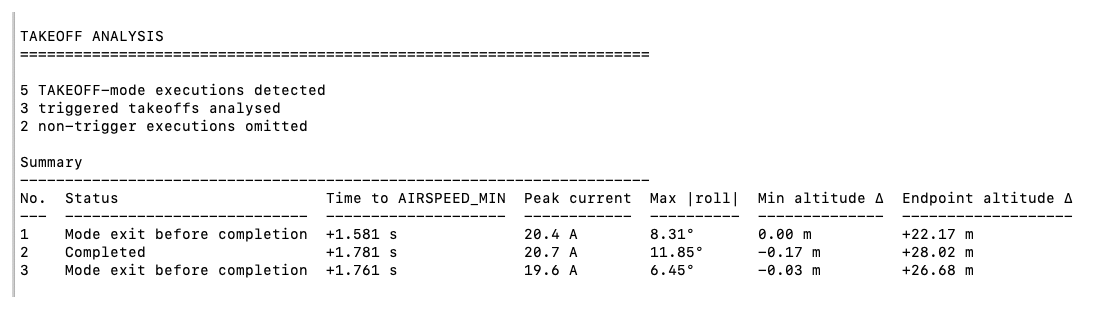

I’ve been developing a TAKEOFF analysis tool in my ArduPilotTools fork and would appreciate feedback from Plane users on whether the report is useful and what is missing.
It analyses firmware-owned Plane TAKEOFF executions rather than trying to infer physical hand release or liftoff. It is intended to work with conventional fixed-wing TAKEOFF mode generally — hand launch, rolling takeoff, catapult/bungee, etc. — without assuming the launch method.
The analyser currently reports:
  • detected TAKEOFF-mode executions and which contained a firmware launch trigger;
  • completed versus mode-exit-before-completion takeoffs;
  • trigger-relative takeoff timing;
  • airspeed and groundspeed at trigger;
  • time to configured AIRSPEED_MIN;
  • propulsion response to AIRSPEED_MIN, including throttle ramp, peak-throttle time and battery current;
  • pitch/roll response and altitude behaviour;
  • airspeed source (sensor/synthetic/unavailable);
  • the relevant trigger-time TAKEOFF parameters used for interpreting the flight.
Here is an example from one hand launch flight containing three triggered takeoffs:
Full APT TAKEOFF analysis
TAKEOFF ANALYSIS
TAKEOFF ANALYSIS
5 TAKEOFF-mode executions detected
3 triggered takeoffs analysed
2 non-trigger executions omitted
Summary
No.  Status                       Time to AIRSPEED_MIN  Peak current  Max |roll|  Min altitude Δ  Endpoint altitude Δ
1    Mode exit before completion  +1.581 s              20.4 A        8.31°       0.00 m          +22.17 m
2    Completed                    +1.781 s              20.7 A        11.85°      -0.17 m         +28.02 m
3    Mode exit before completion  +1.761 s              19.6 A        6.45°       -0.03 m         +26.68 m

The detailed report then shows each takeoff individually, followed by the relevant configuration.
This is still an APT development branch rather than an ArduPilot/AMC feature. I’m particularly interested in feedback on:
  • Is the summary useful at a glance?
  • What do you normally want to know after an automatic takeoff?
  • Is anything shown here unnecessary or confusing?
  • What information is missing for rolling takeoffs versus hand/catapult launches?
  • Are there particular logs or unusual TAKEOFF configurations that would be useful to test?
