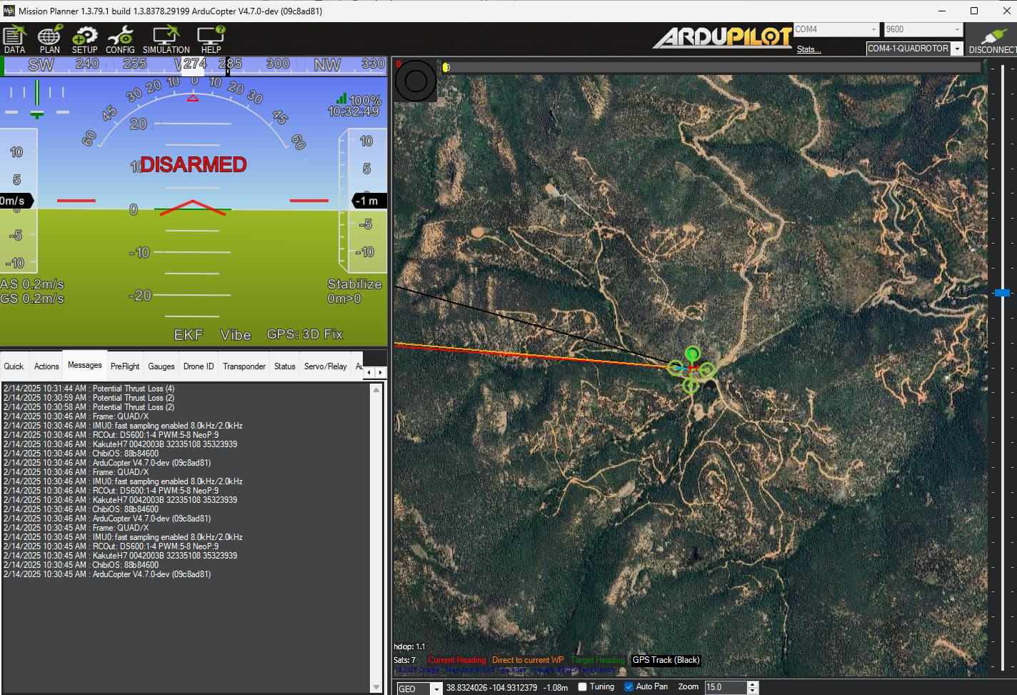

I used the online AM32 tool to reverse two of the motors and finished the initial setup page, except for flight modes. With Battery and MP connected via USB (and props off) I armed the drone. The motors spun for a second or so then stopped. They do not respond to the the throttle, but the radio calibration page shows response. I get messages of potential thrust loss. This is a screenshot:
Where should I go to figure out why the motors don’t continue to spin at arming, or respond to the throttle?
Post a link to a .bin log file. We’ll extract the parameter file from that.
I used the download data flash logs via Mavlink tab to get the latest log, then saved the only bin file in that folder to Google Drive. Was that right?
Yea, that’s it. You should be using the Bdshot version of firmware for the Kakute H7 and then there are a few SERVO parameters that need to be set. In any case you need this even if you just want Dshot.
SERVO_DSHOT_ESC,1
Okay, I installed /Copter/latest/KakuteH7-bdshot and set SERVO_DSHOT_ESC to 1. Here is the bin file from the log after I finished.
