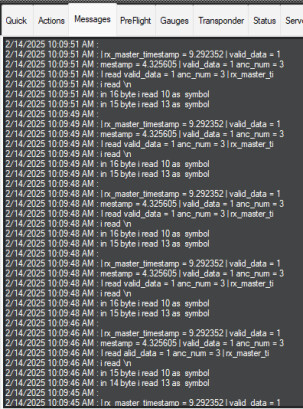

Good time of day everyone,
i made my AP_MyCustomDriver library based on rangefinde that reads serial port to ardupilot firmware. I use 4.5.6 version of firmware, pixhawk 2.4.8 fc, and my module that sends data by UART.
The problem is that I can’t figure out why is the data being red incorrectly. It supposed to read this message:
SOLVE: x = 0.3 | y = -4.655 | z = 1.0 | xf = 1.215 | yf = -1.15 | zf = 1.0 | sq = 87 | anc_num = 3 | rx_master_timestamp = 0.855660 | valid_data = 1
But for different params of call rate and expected time for SCHED_TASK it gives different variations of the message but never the right one.
For example with this params
SCHED_TASK(read_mycustomdriver, 40, 180, 10),
I got this output
Here is the code I added:

    while(uart->available()) {
        char c = uart->read();
        gcs().send_text(MAV_SEVERITY_INFO, "in %d byte i read %i as %c symbol",buffer_idx,c,c);
        if (c=='\n' || buffer_idx >= sizeof(buffer)-1) {
            if (c == '\n') gcs().send_text(MAV_SEVERITY_INFO, "i read \\n");
            parse_buffer();
            buffer_idx = 0;
            buffer[buffer_idx] = 0;
            break;
        } else {
            buffer[buffer_idx++] = c;
void MyCustomDriver::parse_buffer() {
gcs().send_text(MAV_SEVERITY_INFO, "I read %s", buffer);
