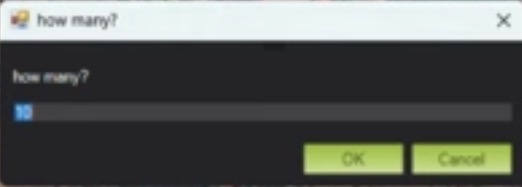

i used copter single link then type 2 when asked how many drones
Can you share a screenshot of that where you are prompted to enter the number of drones?

after clicking copter swarm single link in mission planner simulator
