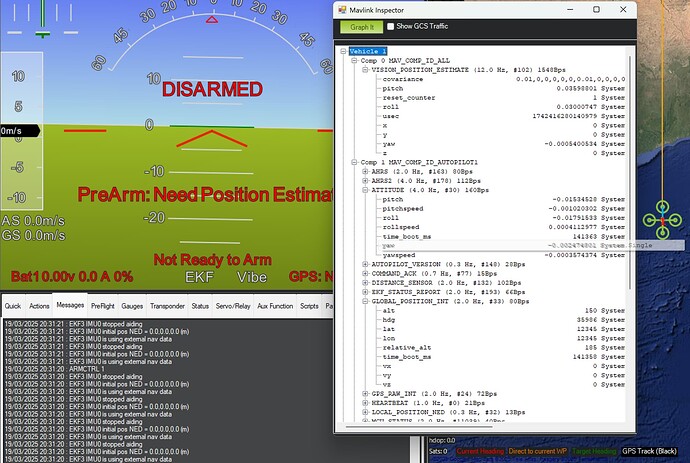

“PreArm: Need Position Estimate” even though VISION_POSITION_ESTIMATE is available
I have a depth camera system on an nvidia jetson which is sending the mavlink VISION_POSITION_ESTIMATE message over serial 3 to my flight controller. In mission planner I can see the message successfully arrive/update in the mavlink inspector (right of the image) under Vehicle 1 → Comp 0 MAV_COMP_ID_ALL.
The X Y Z values are correct but for some reason I keep getting the PreArm: Need Position Estimate error in Loiter mode.
In the messages console in mission planner I continually get the messages:
19/03/2025 15:58:12 : EKF3 IMU0 initial pos NED = (x),(y),(z) (m)
19/03/2025 15:58:12 : EKF3 IMU0 is using external nav data
19/03/2025 15:58:12 : EKF3 IMU0 stopped aiding
where (x), (y), (z) are the values coming from VISION_POSITION_ESTIMATE as mentioned. As it is also reading the right xyz values here I am trying to understand why this prearm error keeps appearing.

I’m far from an expert for Vision_poition_Estimation but did you set the EKF origin at the beginning?
To me it seems like you didn’t because the position on the map is shown as 0 and 0, but the map is clearly pointing to somewhere else…
Ive now set EKF origin to just outside London (where I’m based). But as Im not using GPS but a visual odom system, I dont see how this would help. Regardless, I did it but it didnt fix it.

Ok ive added to my python script (running on the jetson that sends to the FC) what you’ve instructed.
vehicle.mav.set_gps_global_origin_send(1, lat, lon, alt)
vehicle.mav.set_home_position_send(1, lat, lon, alt, 0, 0, 0, [1, 0, 0, 0], 0, 0, 1)
As you can see in the mavlink inspector in the image, the lon and lat values (under the global_position_int param) are 12345 meaning the message was sent through successfully…
But I’m still getting the same error (preArm Need position estimation)
Can you just try my script (with updated connection string of course)?
What I just spotted is that it seems like Global_Origin is coming with 2Hz, but sending it once should be enough… But I can’t imagine that this is the problem…
Can you share if you have any fencing enabled?
Update:
It was to do with the EKF failsafe. There was incorrect position values coming in triggering the failsafe. I corrected directions of the xyz values coming in so that they werent triggering the failsafe and it worked though ive got much tuning to do.
