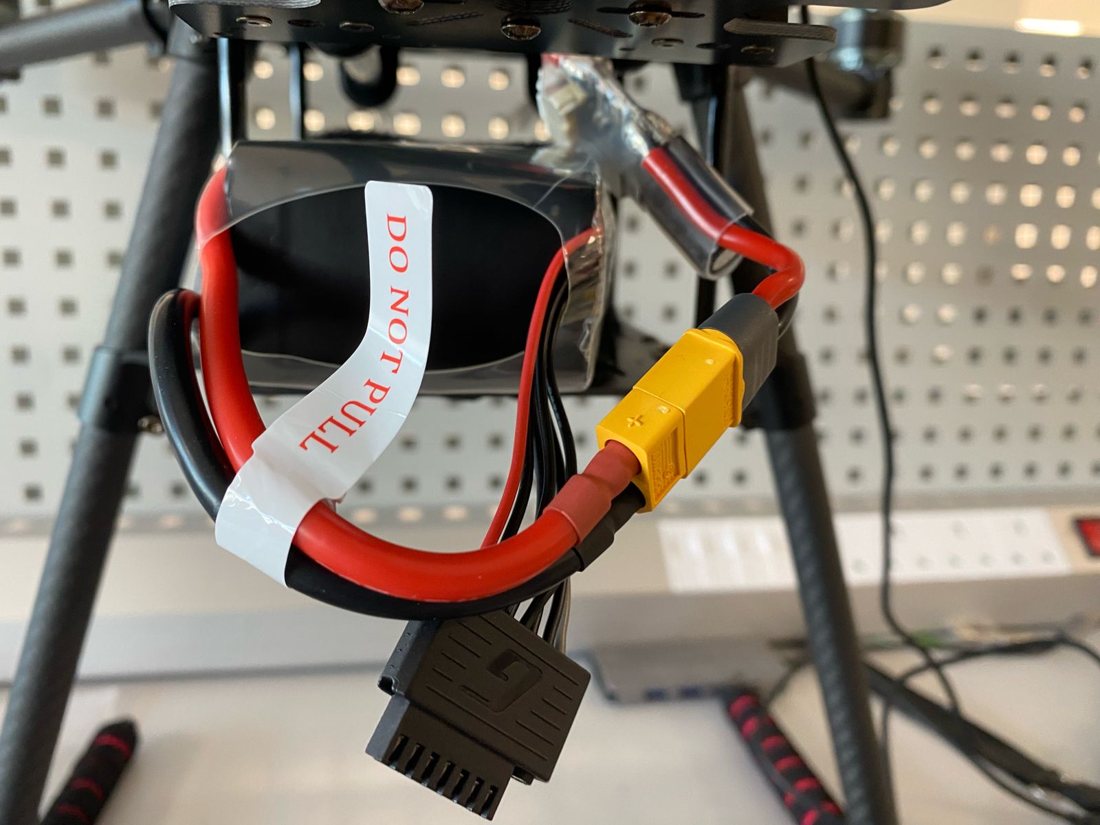

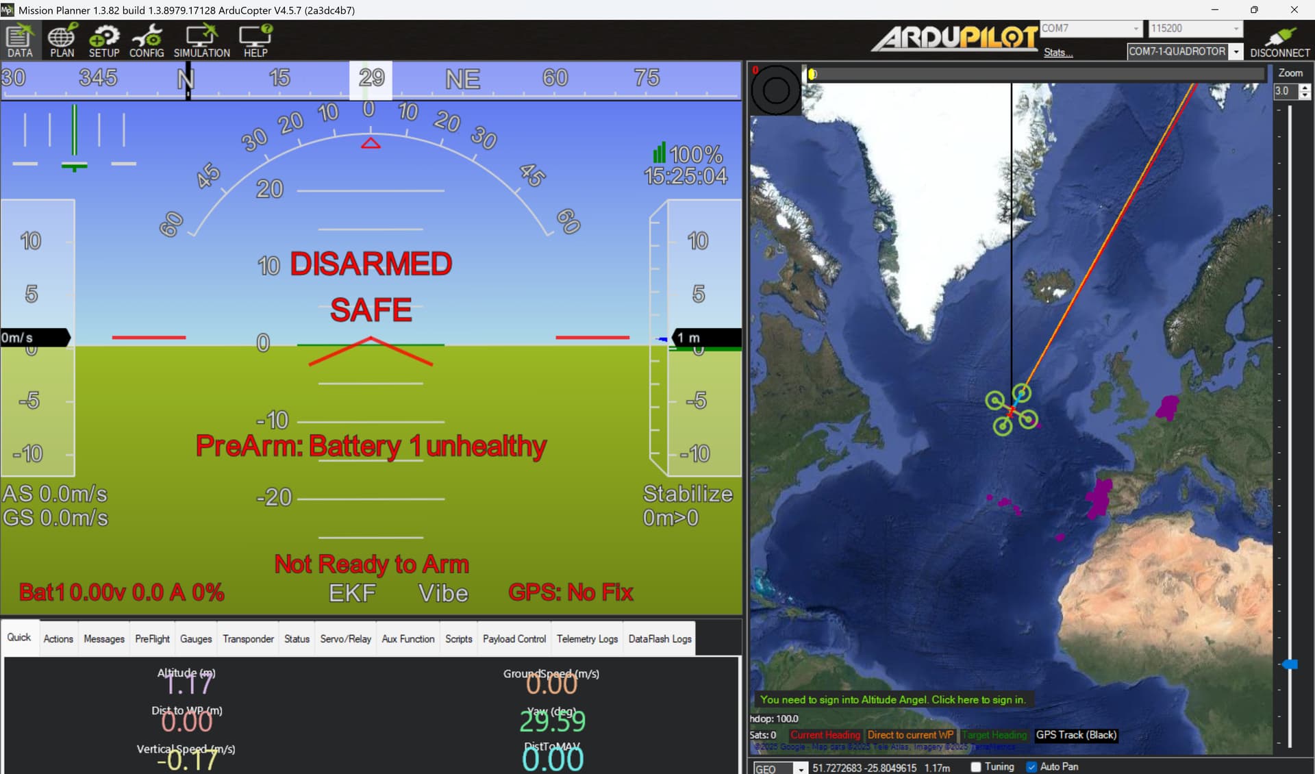

I am having the following issue: “PreArm: Battery 1 unhealthy” on a Pixhawk 6x, Holybro 650 kit. Screenshot attached for the Mission Planner screen as well. I am using a “Tattu G-tech 6S 8000mAh 25C 22.2V Lipo Battery Pack with XT60 Plug” battery

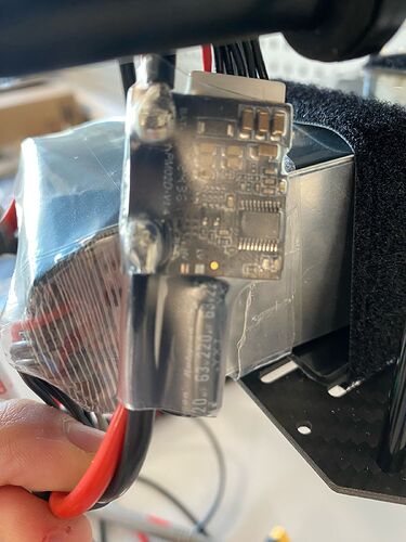

  • Using correct battery module: “PM02D-v1”

Battery 1 voltage is reading 0.00V
That is the issue. Probably a bad voltage input pin is configured.

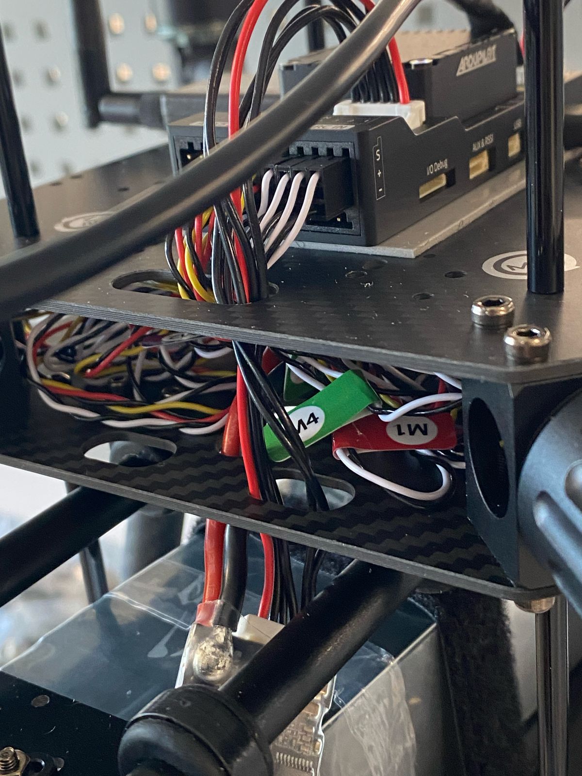

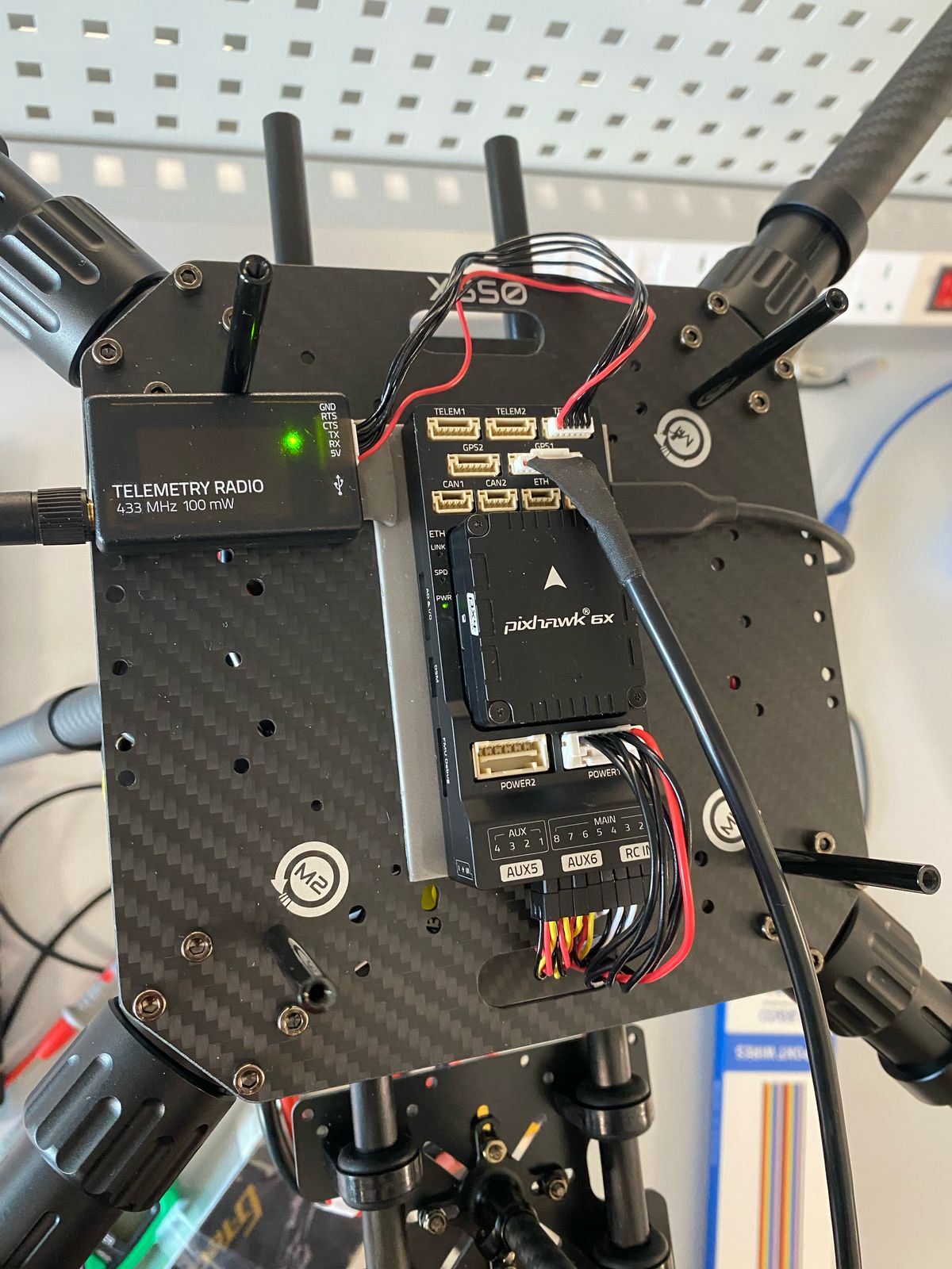

Post a picture of your wiring.
Here you go, thanks for the reply!
Connections look good. Double check all your battery parameters in the FC.
