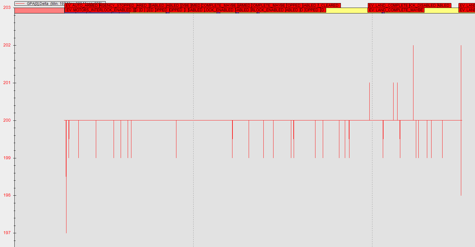

Pre-arm: GPS x: not healthy but RTK fixed and flying without issues if forced
CubeOrangePlus
ArduCopter V4.5.7
GPS 2: Septentrio AsteRx SBi3 Pro+ (primary)
(GPS 1: here3 is secondary)
I am using an Septentrio AsteRx SBi3 Pro+ (dual antenna) and get an RTK fixed and zero errors from the Septentrio side. Arducopter is not happy though and reports GPS 2: not healthy every few seconds and won’t let me arm. If I takeoff in Alt-Hold and switch to Loiter in the air it works seemily fine. Also switching off the pre-arm check would work, but obviously neither is my preferred solution.
I think it is supposed to indicate that arducopter expects a specific pattern of data but is not receiving it?
I followed this guide: https://customersupport.septentrio.com/s/article/How-to-integrate-latest-Septentrio-GNSS-receivers-with-Ardupilot-using-Pixhawk-standard-boards
So I end up with that:

It needs to be below 200ms otherwise it will signal bad health.
Thank you for the input!
Right not I am running double the frequency, yet it still throws the error :frowning:
GPS_RATE_MS,100
GPS_RATE_MS2,100
Is there a window where the frequency should be in order for it to be considered “healthy” or just <200ms?
Thanks again!
125ms-200ms is optimal. And it needs to be consistent.
Thank you, that is very good to know!
Tried 200ms on the GNSS and 200ms on Autopilot - no luck.
Since I can only choose 100ms or 200ms on the GNSS side, nothing in-between, it should work if e.g. I set the Autopilot to 8Hz/125ms and the GNSS to 100ms? However it does not.
The baudrate of 115200 can’t be the issue I think. GNSS says 0,82kB/s, which should be easily covered.
Ask Septentrio how to get hard realtime 200ms out of their system.
Thanks, I will!
How did you come to this conclusion? Because of the 1-2Hz deviations in GPA?
Given the price of a Septentrio system you’d think it would be perfect…
GPS not healthy in ArduPilot FW context means: realtime (<= 200ms) not met.
It seems like regardless of the set rate, via SBF, data is output every 500ms, which is bothering and proves you were right.
After switching to NMEA with all messages enabled, it worked without issues first try. What I am still unsure about is if Arducopter is using the heading info from the NMEA message HDT or just calculating using the GNSS antennas’ distances. It seems like it is actually using the data provided via NMEA but I am not sure.
