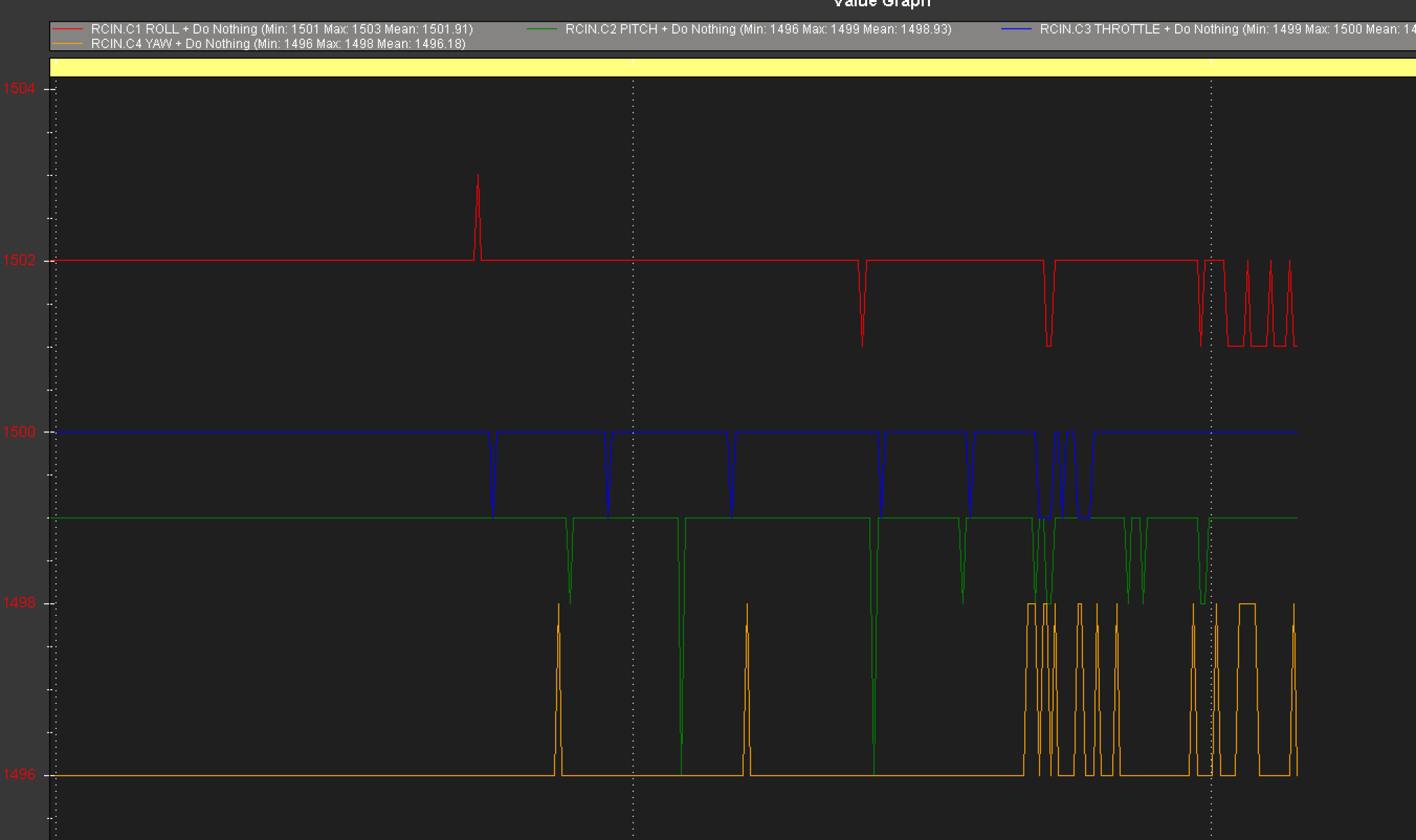

There’s no flight or anything very interesting in that log. However there is some movement on the RC channels, I presume when you are touching the sticks.
It could be shakey hands :slight_smile: or the transmitter could do with a hardware calibration. Be sure to do the RC calibration in each copter after you’ve done the transmitter.
But as per this graph the variation is within the deadzone of the RC inputs, so the copter would be ignoring those tiny inputs. The deadzone is 20PWM except for Throttle which is 30PWM.
If you’ve used BetaFlight with that transmitter you may have turned off the analog smoothing too, try turning that on again.

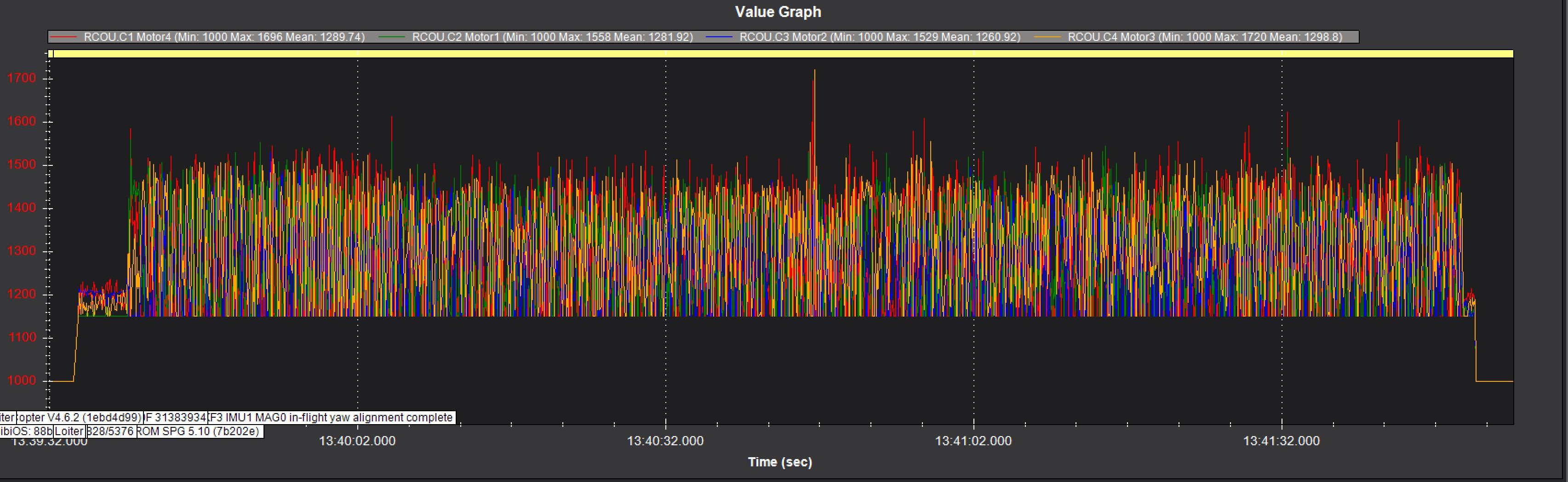

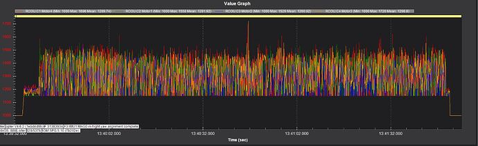

Hello Dave. Yes, I applied the config adjustment per your instructions. I failed to configure the notch filters before attempting the Auto Tune.. Here is the screen shot of the motor outputs.
OK, Auto Tune will probably run with that. But, set INS_RAW_LOG_OPT,9 and make another hover flight to collect data for notch configuration first.
