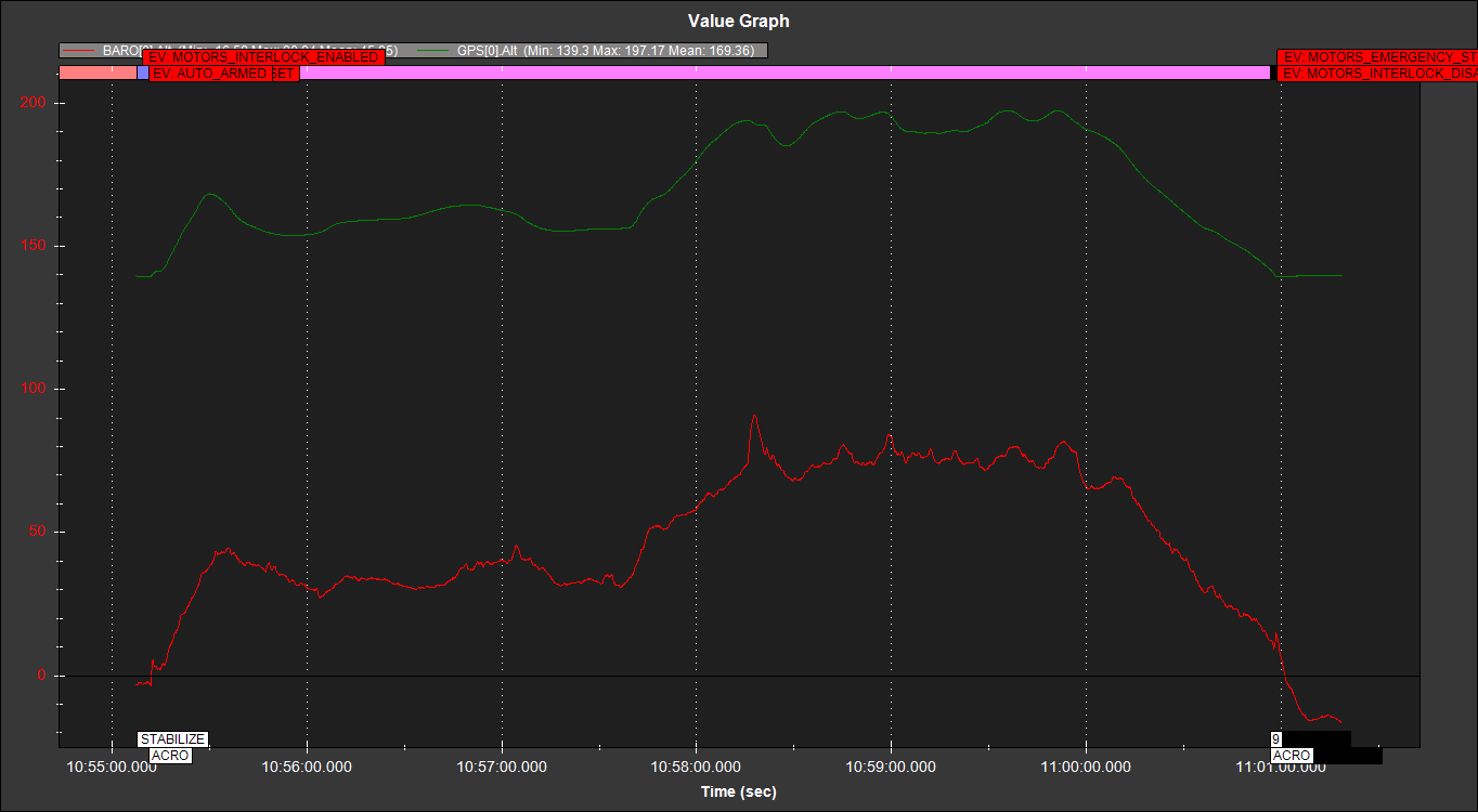

After one minute, around 10:57:35 another command was issued to climb to 80 meters using the same tecnique, and again, the copter climbed, this time slightly overshooting, and then began bobbing up and down very slowly.
The behaviour is very repeatable, in all previous flights it followed the same pattern: reaching an altitude, then slowly descending by a considerable margin, then beginning to drift up and down very slowly.
In Loiter and Alt Hold mode the copter seems to stay very stable in altitude.
Flight log: www.ecoterrenos.cl/2026-06-22 10-55-07.bin
For comparison, data from a Loiter flight:
Latest Lua script: RETRANSLATOR_09.lua (35.8 KB)
Could it be that I have to use vehicle:set_target_velocity_NED(target_vel) rather then target location? That was suggested by IA, but do want to risk several hours changing the structure of the program

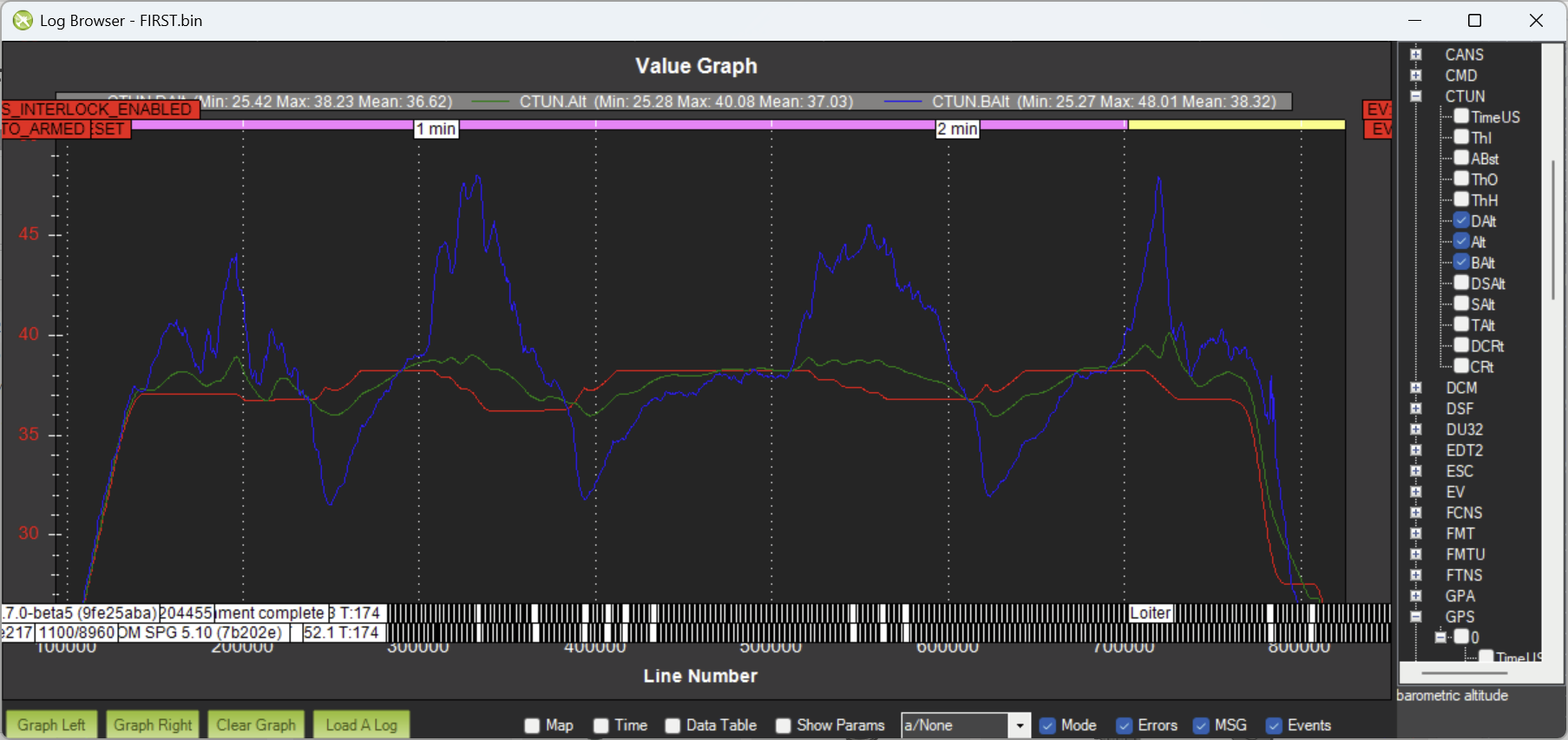

OK. I have been doing more testing, and it seems to me that there is some bug in the implementation of the guided mode altitude control or altitude source. I changed the control from vehicle:set_target_location to vehicle:set_target_velocity_NED(target_vel) , but it did not change anything as far as altitude drift is concerned.
I did two test flights
In the first test flight, there was an unsolicited variation of baro altitude from 31 to 47 (i.e. 16 meters), and the copter was doing cycles of slowly climbing and going down. The target altitude was set to 174.1 meters (which is equal to 40 meters plus home altitude). This did not change during the flight.
The copter altitude was obtained using current_pos = ahrs:get_position()/100. Once the copter climbed to that target altitude, the copter remained very close to that altitude (± 1m), Accordingly, the vz was 0 if there was a differene of less than 1 meter. current_pos altitude and 174 meters were within 1 meter. But the copter visually climbed slowly up and down several
times in a very pronounced manner, and the baro data also reflects it (as well as GPS data).

The .bin file contains messages with all the parameters used for setting vz:
gcs:send_text(6, string.format( "sign:%.0f dalt:%.1f vz:%.1f dist::%.1f C:%.1f T:%.1f ",vzdirection,dalt,vz,dist,current_pos:alt()/100,Copter_target:alt()/100))
tyícal output once the copter climbed to position:
sign:1 dalt:0.4 vz:0.0 dist::0.9 C:174.5 T:174.1
In the second flight, there was unsolicited variation of baro altitude of from 24 to 34 meters (10 meters). The target altitude was set to 176.6 meters (which is equal to 40 meters plus home altitude). The whole time it stayed pretty close to 176.6 meters, varying by ± 1 meter. There are messages in the .bin file where one can check that. During this second flight, the automatic yaw tracking was disabled. Towards the end of the flight I started yawing the copter manually. Overall, the second flight had slighly lower visible variation of altitude compared to the first flight.

In short, the ahrs:get_position() at least in guided mode returns altitude which is inconsistent with respect altitudes reported by baro and gps, and visual observation.
First flight .bin file:www.ecoterrenos.cl/FIRST.bin
Second flight .bin file:www.ecoterrenos.cl/SECOND.bin

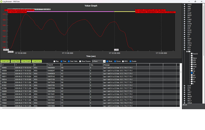

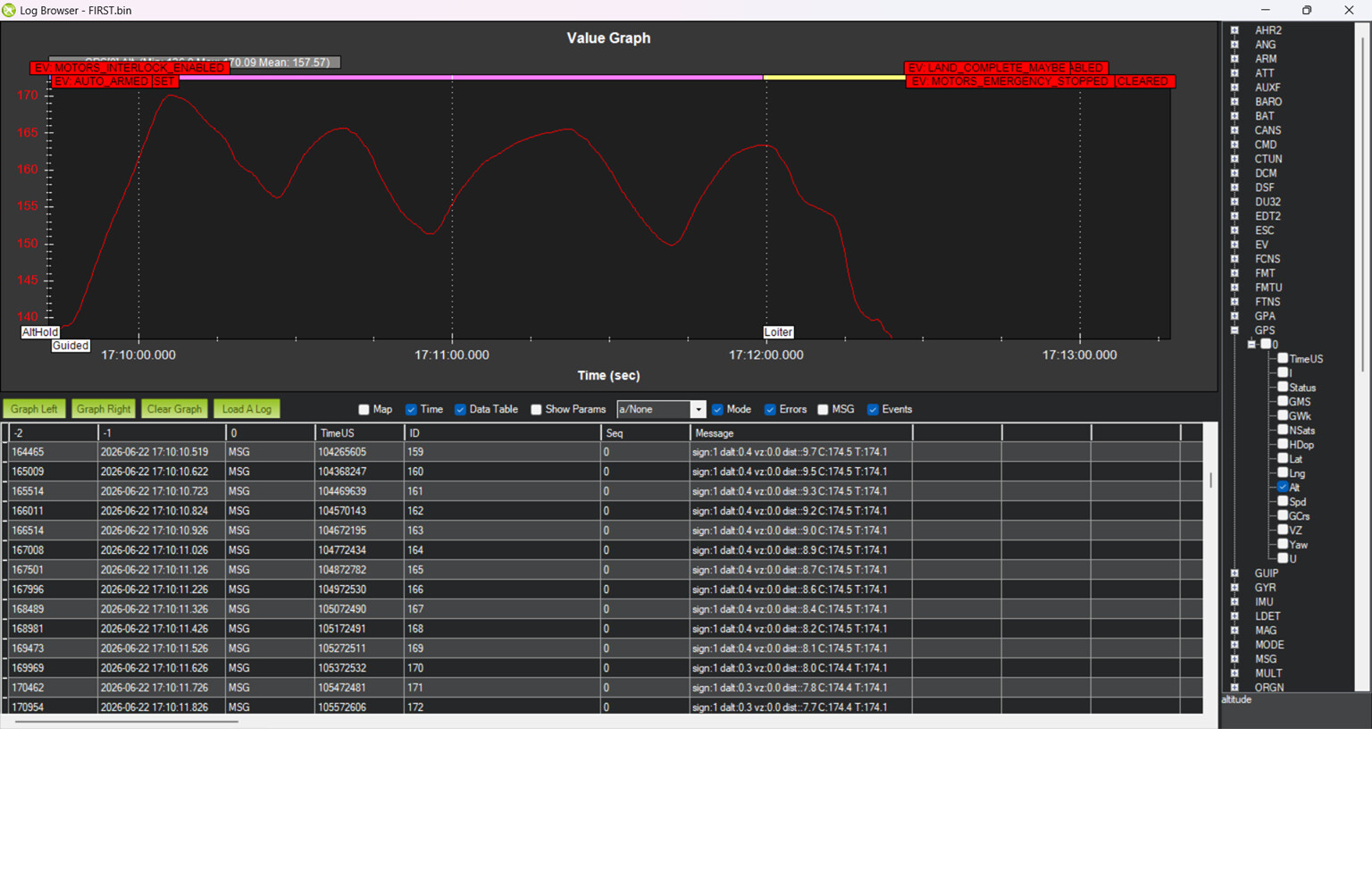

To make it even more obvious: this graph shows that after around 10:10 there is GPS altitude which descends slolwy.
Yet the messages from script show that the ahrs:altitude remains stable
sign:1 dalt:0.4 vz:0.0 dist::9.2 C:174.5 T:174.1
C: is copter altitude as reported by ahrs:position
T: is target altitude set once

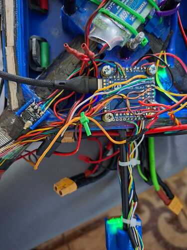

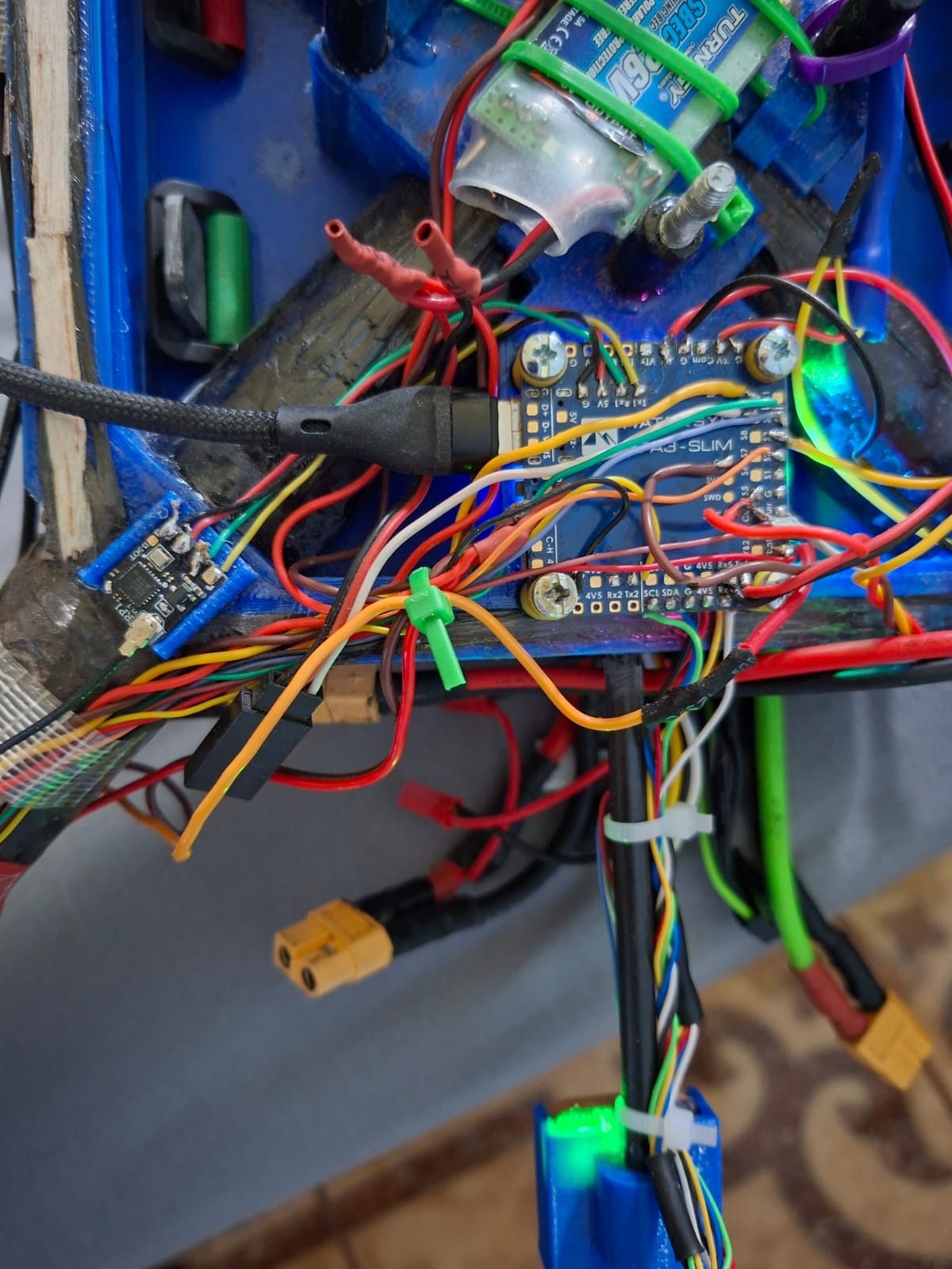

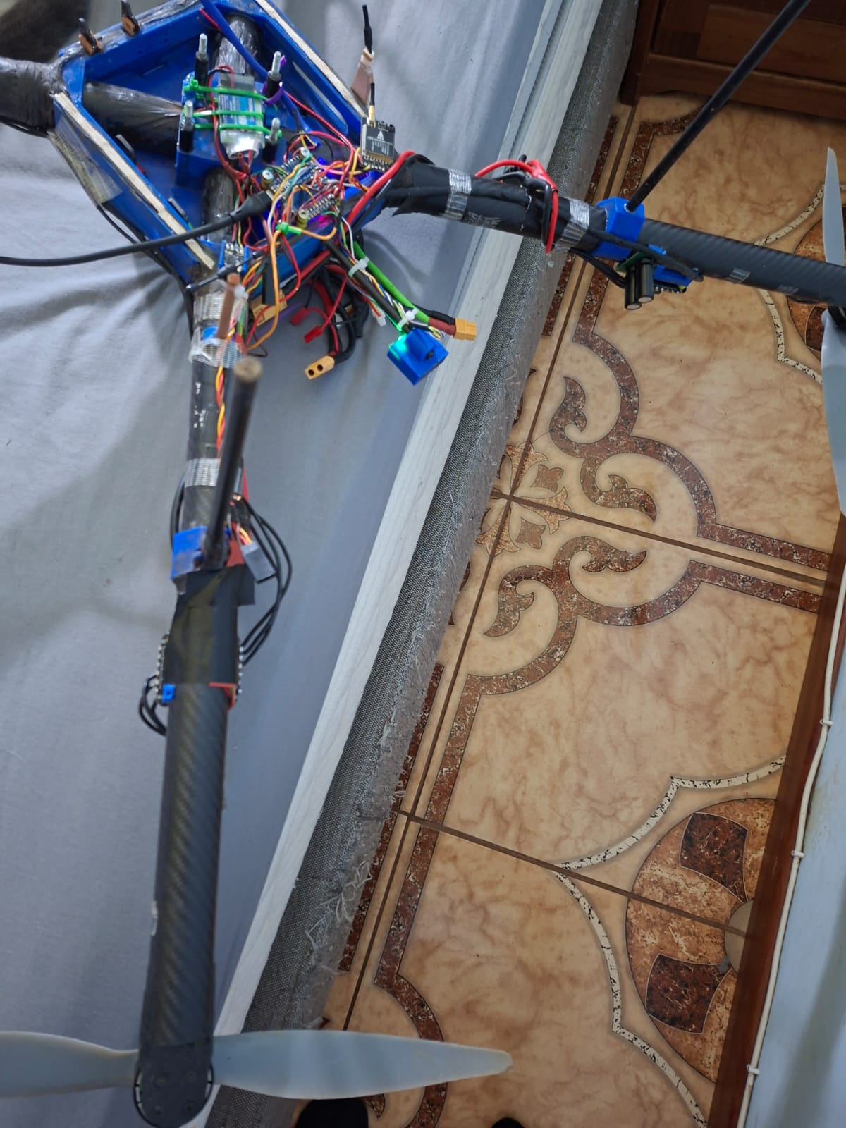

I think there may be some significant interference on the barometer. The deviation between the barometer altitude and the EKF altitude is as high as 7m at times which is very unusual. Maybe the autopilot has been placed in a nearly air tight case or the prop wash is flowing right over the Copter? Maybe there’s a large hole below the autopilot?
Actually, that is a very good point, and I also noted some disrepancies between GPS and baro, although overall they track each other quite closely.
The baro is exposed, and since the arms are very long (diagonal 105 cm), and props are only 15 inch, there should not be any interaction (or so I assume) between the props and baro
but baro and gps overall follow each other.
I checked RCOU and baro jumps, and indeed they are related, i.e. when motors suddenly change power, that is when baro altitude jumps a little. No, not sure, at one point yes, at another two points no, there was no change in motor outputs
I think I have kind of solved it…
It could be that baro has a creep for some reason. (I tried to block out light, wind, etc., did not do much good).
However, ardupilot seems to ignore almost completely the GPS, pushing the ahrs altitude up.
I think the algorythm is wrong, because for very small altitude changes where baro could be more precise, that is the correct way, but when you see that GPS stays at a fixed altitude, but baro grows slowly, the ardupilot either must issue a warning (GPS/baro discrepancy) and/or rely more on GPS altitude as source for altitude.
My suggestion would be to set a limit for ALT difference which should generate alternative altitude estimation
