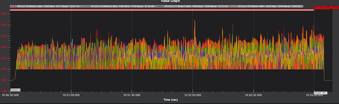

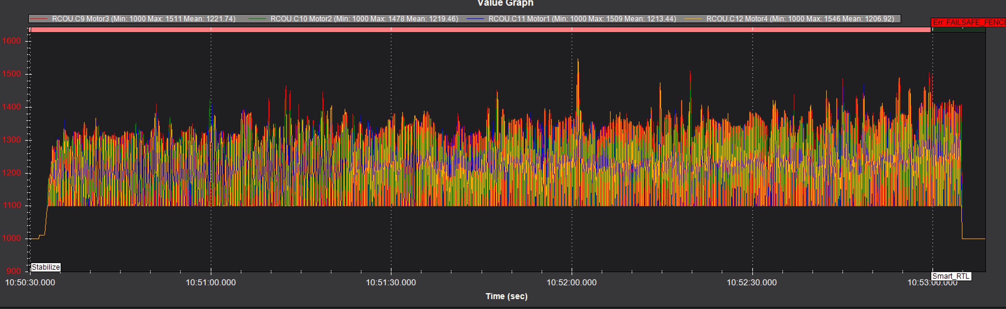

This craft will never fly with default Rate PID’s and vertical acceleration controller gains. MOT_SPIN_MIN at default is a problem also. The outputs are nothing but oscillation.
And, you would have an easier time tuning it if you used a higher capacity battery for additional weight. From this log it’s difficult to determine hover thrust but it could be as low as 0.02.

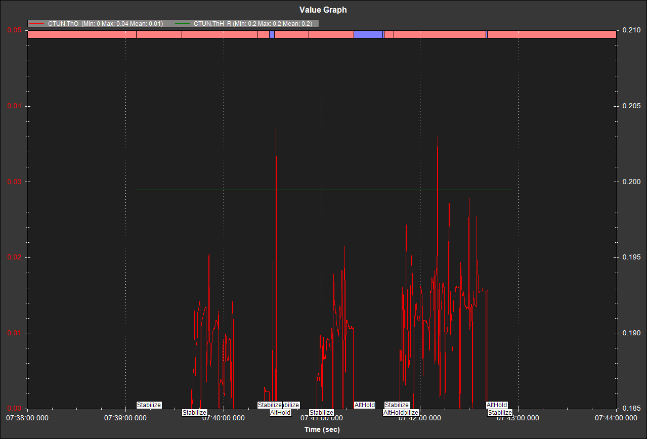

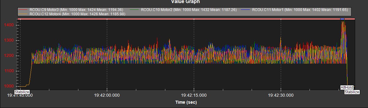

This morning I added weight to the drone and flew it up around 20 ft and for some reason I lost control and it kept on ascending up. This has only happened once before. Any idea what could be causing this?
Here is the link to the .bin file.
It reacted the same as when I switch the drone into Althold mode. Just a incontrollable climb.
Thank you

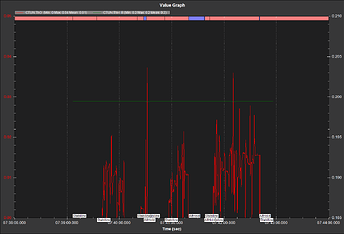

Again why? The Hover thrust is more like .06 This answers your question “any idea what is causing this”.
Anyway you have massive outputs oscillation from default Rate PID’s and Vertical Acceleration Controller gains.

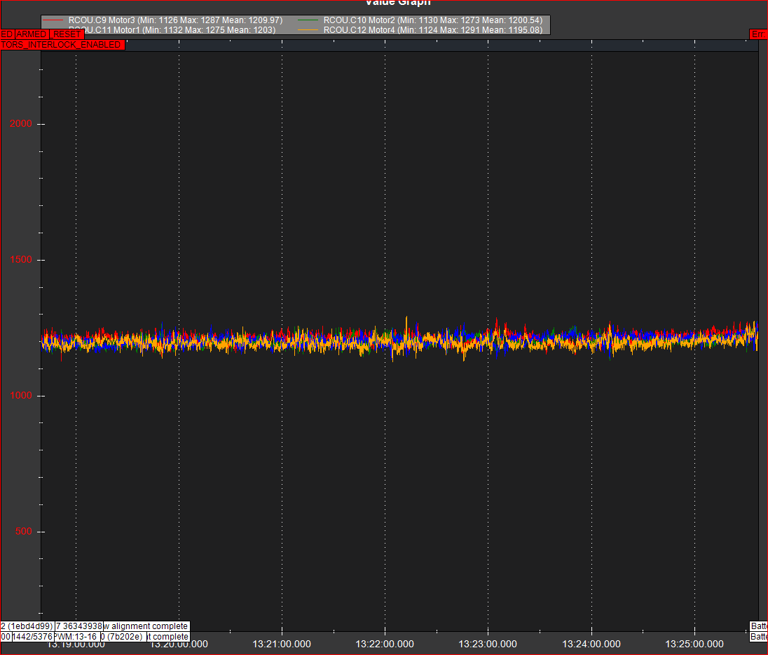

I was able to work it down and it flys a lot better now. The Alt and Pos hold modes work now too.
When im in position hold mode it seems to drift a little and has little jerks here and there. Is there anything I can do to fix that? Overall its not bad but im just looking to make it better.
Don’t use Position Hold, it was superseded by Loiter years ago. You will have to post a link to a Flight Log for any questions of that nature.
But, that RCout graph looks good.
