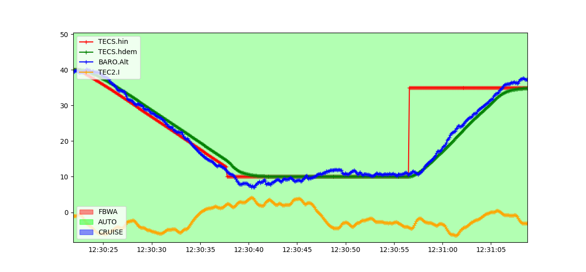

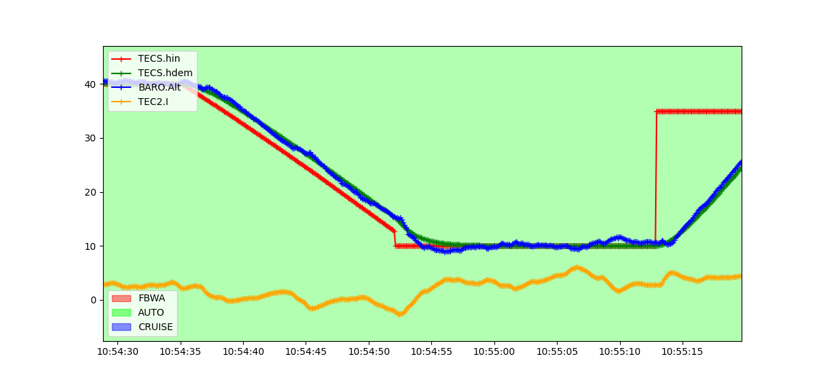

Poor waypoint altitude accuracy on descent

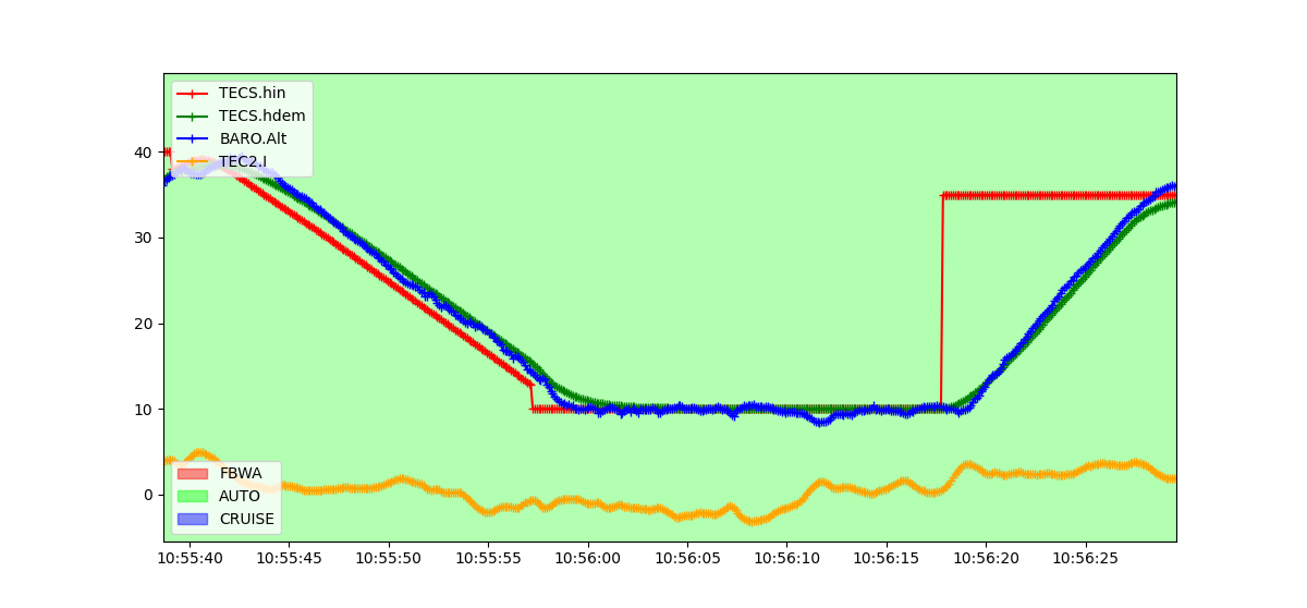

I’m doing navigational fine tuning on a sub250g ZOHD Drift and horizontal navigation is excellent in tight spaces.
However the altitude accuracy is poor if the plane glides to a waypoint with lower altitude.
In my case the altitude of a ascending waypoint is hit very well while the descending waypoint gets missed by a couple of meters.
I don’t see any parameter to tweak in particular to compensate and would like to ask for advice.
From my analysis it is the combination of the glide slope TECS.hin that is two-point filtered with TECS_HDEM_TCONST and therefore TECS.hdem follows but cannot reach the waypoint’s altitude target. As seen in the ascending waypoints the jump of TECS.hin converges much better to target altitude.
BR

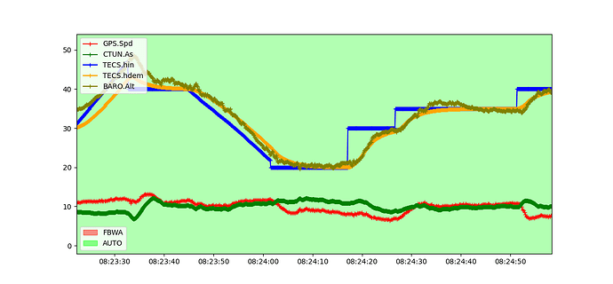

That descent is well within the flight envelope. The plane is accurately tuned to hold 10m/s but measurements are typically all over the place unless it’s calm.
That was about 1m/s wind in the morning, about the only time to get reproducible measurements as I recently have upwind and downwind sections on that field during the day, really annoying.

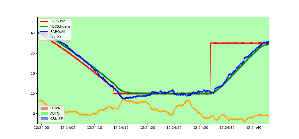

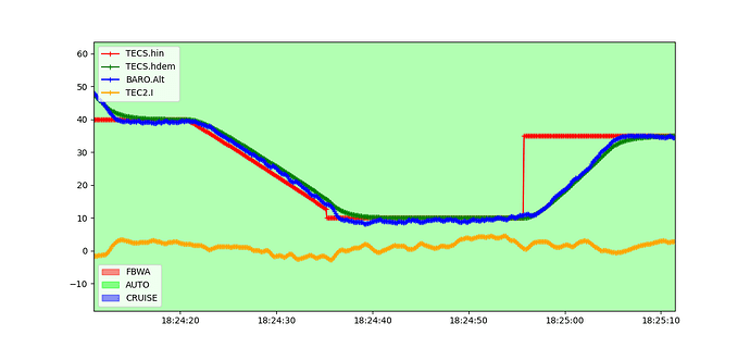

Some intermediate result, just changing TECS_HDEM_TCONST from 3(default) to 2 makes it follow the glide slope closer but has downsides on the following climb. I was expecting a linear climb but got an immediately climb instead, maybe another altitude bug in ap4.6b5.

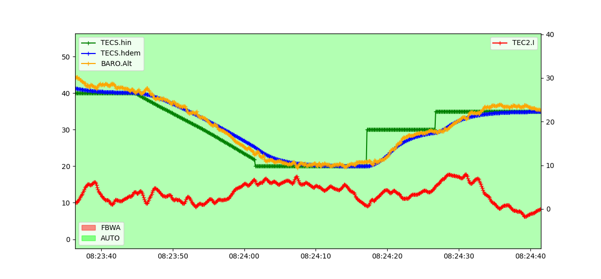

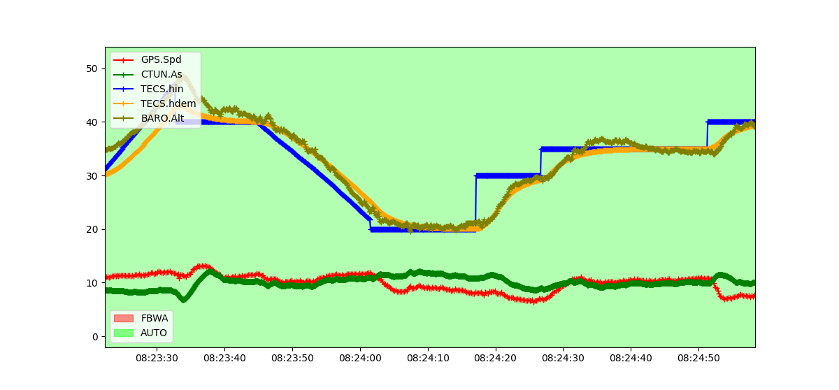

BTW: I went down to 10m to have more vertical distance in the glide slope, but doesn’t do much in the end.
I wonder if there is more low-alt specific code, because there are separate TECS parameters for landing that might work around that (but you need to be in a landing sequence so they won’t be any use wp to wp). The descent from 40 to 10 looks consistent so maybe just go down to 20 or 25 and see how that handles it.

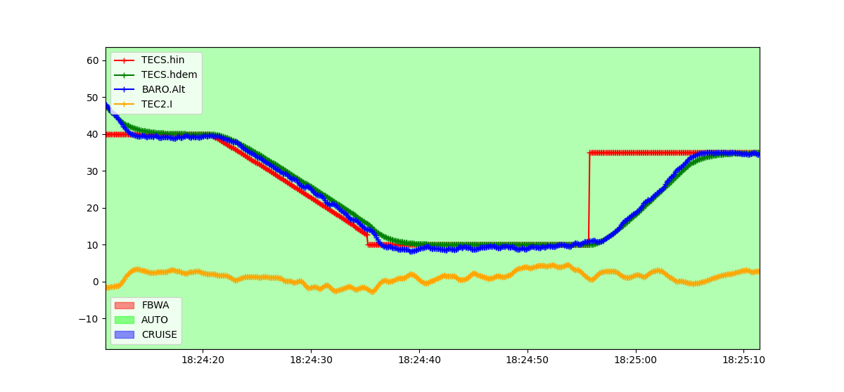

I tried several variations and I always end up with ~10-20% too less descent at the wp.
It is likely the two point moving average that follows the slope and therefore cannot reach the target altitude at the WP.
To me it’s a design issue that I can work around by setting a separate WP target for the descent before the turn.

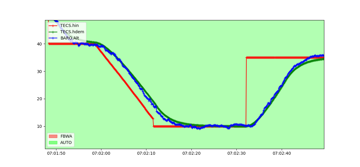

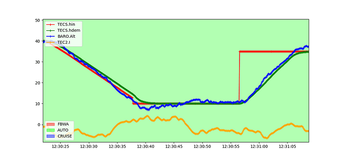

Another session with TECS_HDEM_TCONST=1.0 which in combination with the I-Gain even manages to go below the slope and undershoot the target altitude slightly.
It also leads to some really aggressive moves on climb only limited by TECS_CLIMB_MAX.
I’ll try to tweak it until no undershoot happens, maybe in the 1.4-1.5 range.
BTW: I don’t understand why the slope does not end on the target alt but above that, it seems to be a wrong calc IMO.
The slope line connects the waypoints. When the aircraft comes to the “Acc radius” in front of the target waypoint, it is considered to have reached the target waypoint, and the slope line ends there.
A smaller “Acc radius” would improve this situation.

Thanks @hatnac I’m running
NAVL1_PERIOD     11.000000
WP_RADIUS        20
so that’s a comprehensive explanation.

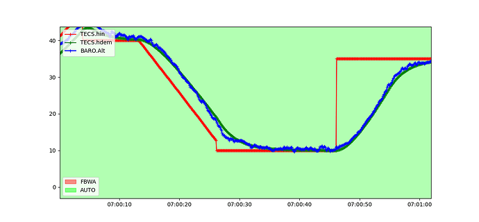

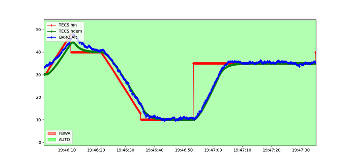

My latest run with
TECS_HDEM_TCONST 1.500000
TECS_INTEG_GAIN  0.300000
TECS_TIME_CONST  3.000000
looks like it’s almost accurate, just have to reduce TECS_INTEG_GAIN from here.

Nice job! That looks really good.
Thanks, much appreciated.

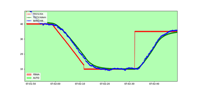

But actually it’s fools luck. I had a facepalm moment realizing that the whole thing converges because of Acc Radius sets the same altitude again for the next waypoint.
Plane flies with 10m/s and at WP_RADIUS 20m it gives the two points within 1.5 seconds for the moving average at target altitude. Otherwise it would not work out the way it does.
IMHO immediate climb should happen for the first waypoint when switching to Auto.
IMHO mission control over TECS actions is too limited/cumbersome.

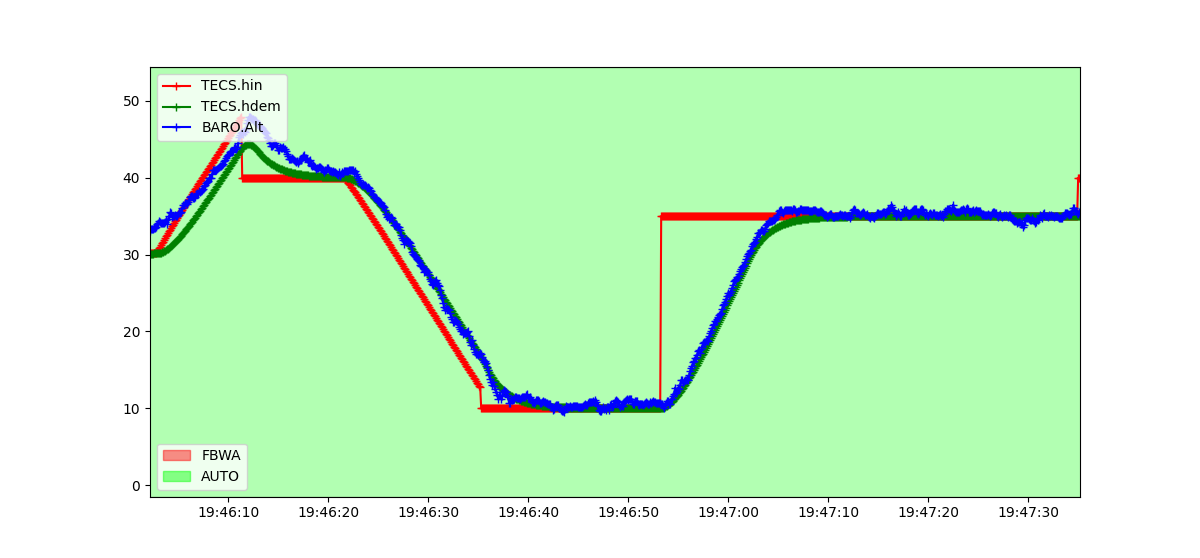

Final tune attached for reference, only dent in the altitude is a 90deg turn at 50deg bank angle.
TECS_INTEG_GAIN  0.240000
