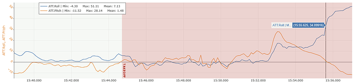

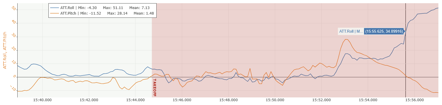

Hi all,
I had a plane=)
I was doing an auto takeoff. It seems I had weak battery, so it went below BATT_CRT_VOLT on a first second of a takeoff. I have BATT_FS_CRT_ACT=2 # Land so
plane have chosen direction to land, started to descend, rolling, but it was still in the auto takeoff mode and it even did not reduced motors RPM for landing. Speed were growing, rapid descend, done.
Messages:
2026-05-03 13:56:55.339 Armed AUTO, xaccel = -17.3 m/s/s, waiting 0.2 sec
2026-05-03 13:56:55.539 Triggered AUTO. GPS speed = 0.7
2026-05-03 13:56:59.079 Takeoff to 40m for 200.0m heading 294.7 deg
2026-05-03 13:56:59.399 Autoland direction= 310
Flight:
Log:
2026-05-03 13-56-45.bin (636 KB)

There is no battery failsafe, It is just a failed takeoff. The “Autoland direction= 310” thing is just to tell you that the auto land direction has been locked in from the take off heading. It does not mean that it is starting a auto land.

If its not flown before then it could just be that the tune is not correct, or the control surfaces are not setup correctly. There really is very little relationship between what the controllers are asking for and what the plane is doing.

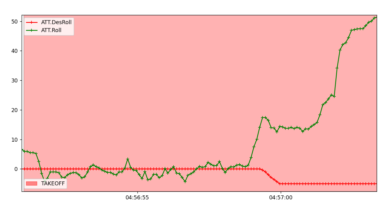

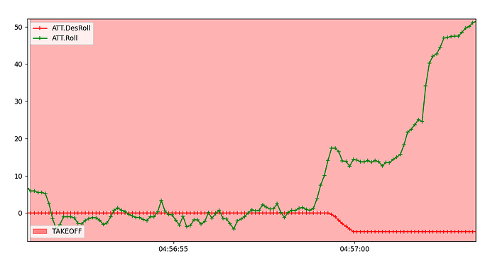

I’m going to go out on a limb here and suggest something physical, like your battery was loose and sliding around inside the fuselage, causing the un-commanded roll to the right. AP was trying to correct but at a max of 5 degrees due to LEVEL_ROLL_LIMIT = 5.
LEVEL_ROLL_LIMIT = 5 - means 5 degrees maximum, but in the log you could see that roll is more than 15 degree and even more than 45 at the end.
The desired roll was 5 degrees (What the controller is trying to do) but the plane was not able to maintain that. In fact it wasn’t even in the same direction. That’s why @timtuxworth was suggesting a mechanical issue.
