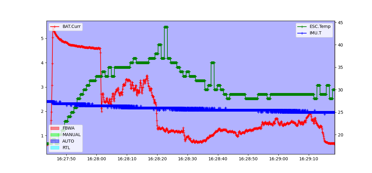

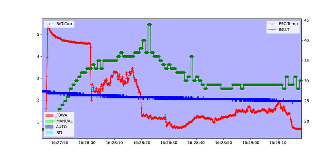

@menschel I really appreciate all your bug reports, but can you make sure you include a log with each report like this? I know it may seem obvious for you what you are talking about, but it is less obvious for me. Ideally you would reproduce the issue in SITL and include a link to a bin log from SITL showing the problem. That makes it extremely easy for me to then reproduce and work on the issue. It doesn’t surprise me that you are finding issues with the large changes in terrain handling in 4.6.0 as it was a very large code change, but we can’t just revert as it was fixing serious bugs.
If you don’t have a place to upload bin logs to then let me know and I’ll create a folder for you on my google drive.
The graphs from MAVExplorer are useful too (thanks!) but ideally I need the bin log associated with each issue, so I can extract from that log the exact parameters, mission and GCS commands (they are all logged in the bin log, allowing me to reproduce easily)
