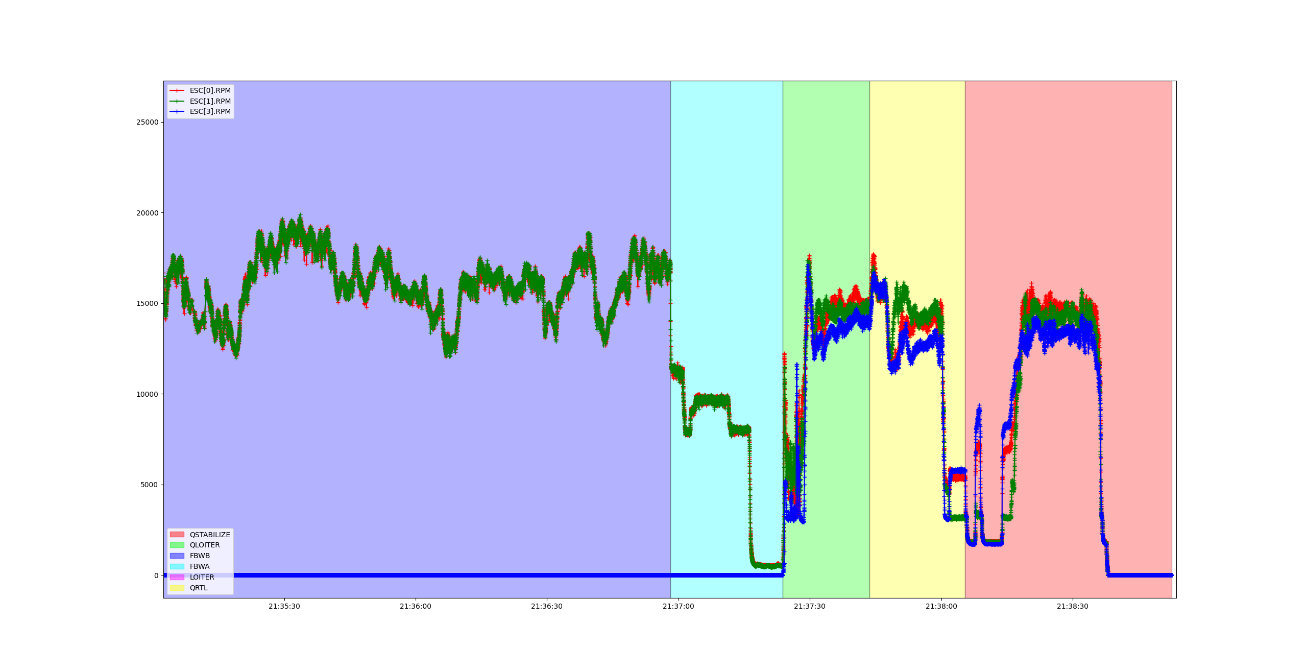

  • ESC Telemetry RPM readings in logs “move” over all 4 ESCs while only 2 motors should be running

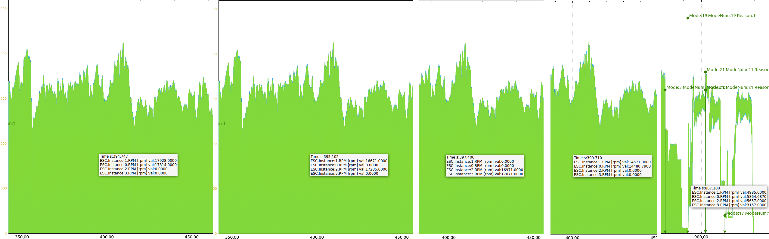

I mean, in the logs, I see ESC telemetry instances and when I pass the mouse over the individual frames and let it show the point values, I see that 2 motors have rpm and two others don’t and the Index of the telemetry instance changes arbitrarily.

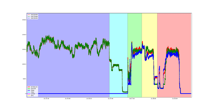

Nope, but that is from Allisters log, gimp’ed together…
I see nothing like that in allister’s log, what GCS are you using? If you simply plot the ESC data for a single motor you should see zeros. which is not the case.
I run on linux and currently APM-Planner oder QGroundControl are my choices.
That concatenated screenshot is from
APM-Planner_2-2.0.30-rc3-x86_64.AppImage
EDIT: Yes I see zeros.
APM planner is the issue. There are no zeros in the log for the forward motors. Look at the individual log messages. It will be messing up the instance numbers - it has had issues with this in the past, I thought I had fixed them all, but clearly not.
In that case I’m sorry, I was played for a fool by APM planner, MAVExplorer does not show this.

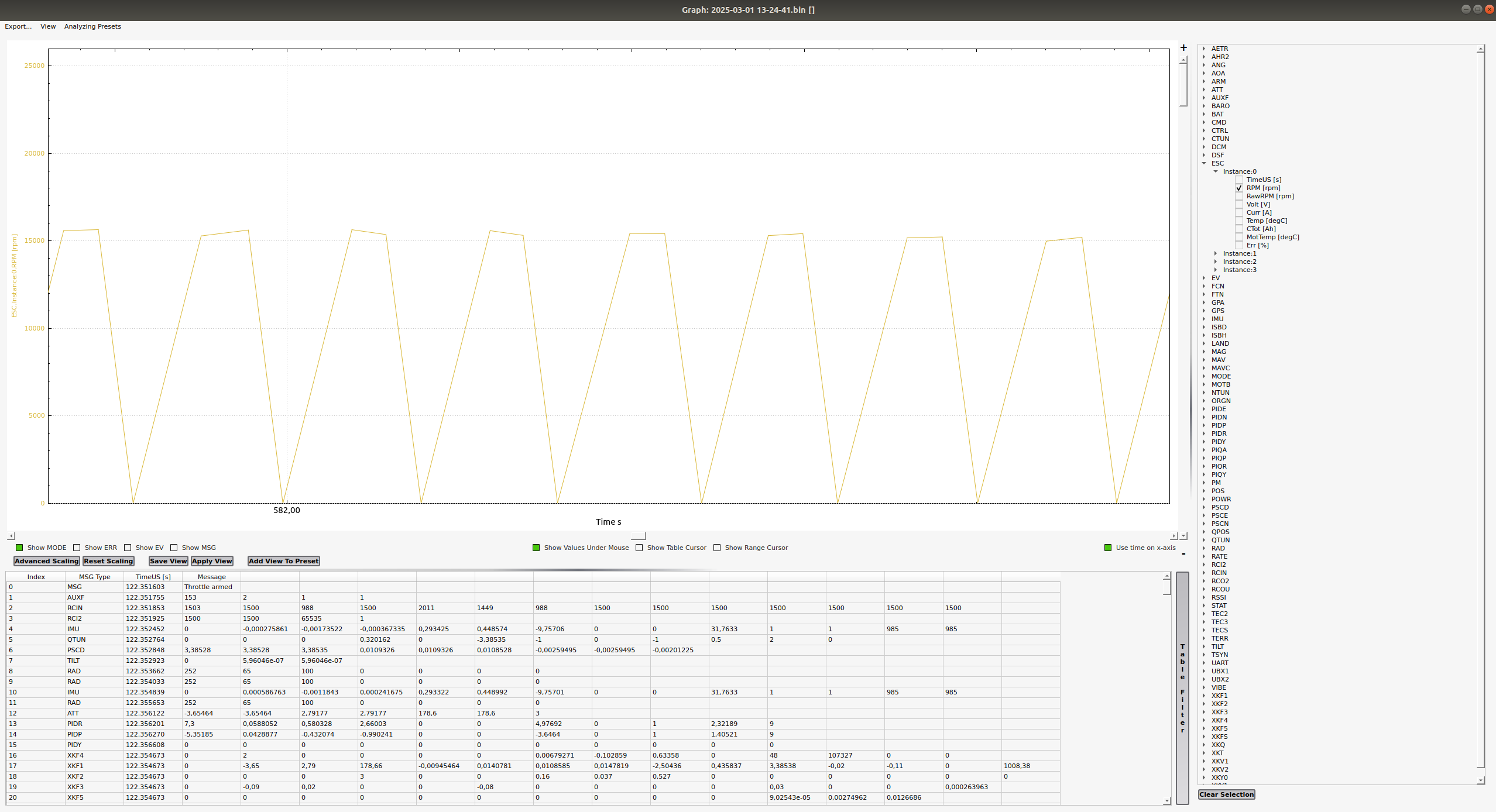

I’ll need to provide a build with full rate motor and rate output logging if someone is willing to run this?
I’ve been able to get the noise on the bench in manual mode, so if you can get the data you need from a bench test then I’ll try it. Matek F405-VTOL (F405-TE BdShot)
Does the board have an sdcard?
Yes.
Please can you try and get a log with this. Please set the full rate attitude bit (bit 20). You might have to turn off other logging to avoid dropouts.
arduplane.zip (624.9 KB)
I’ll test it out tonight.
