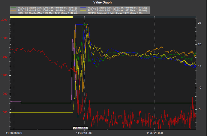

Hi, thanks for looking into this. Our RC-pilot swithes to QSTABILIZE when the transition doesn’t occur automatic.
Thanks a lot for looking into this
Log file from tests with a Fighter 3.0, Arduplane 4.6.0 Beta 6:
bin log
Parameters
Test were done at about high (100m) altitude. Parameters were changed during the tests to reproduce the behaviour. Some back transitions work (where Q_ASSIST_SPEED different from 0 or -1). When Q_ASSIST_SPEED is set at 14 m/s back transitions work fine.
Best regards - Pål Kvaløy
@pkvaloy
Q_Assist works, but the activation message doesn’t appear, which is irritating. The quad motors are already running before your pilot switches to Q_STABILIZE, as shown in the log file.

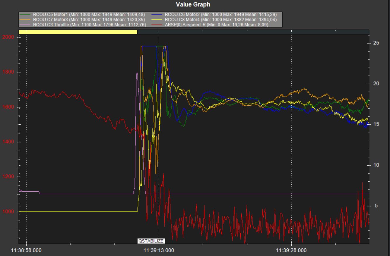

@pkvaloy
Peter Hall (@ Iampete) told me that QASSISt activity is logged in QTUN.ASt !
Rolf

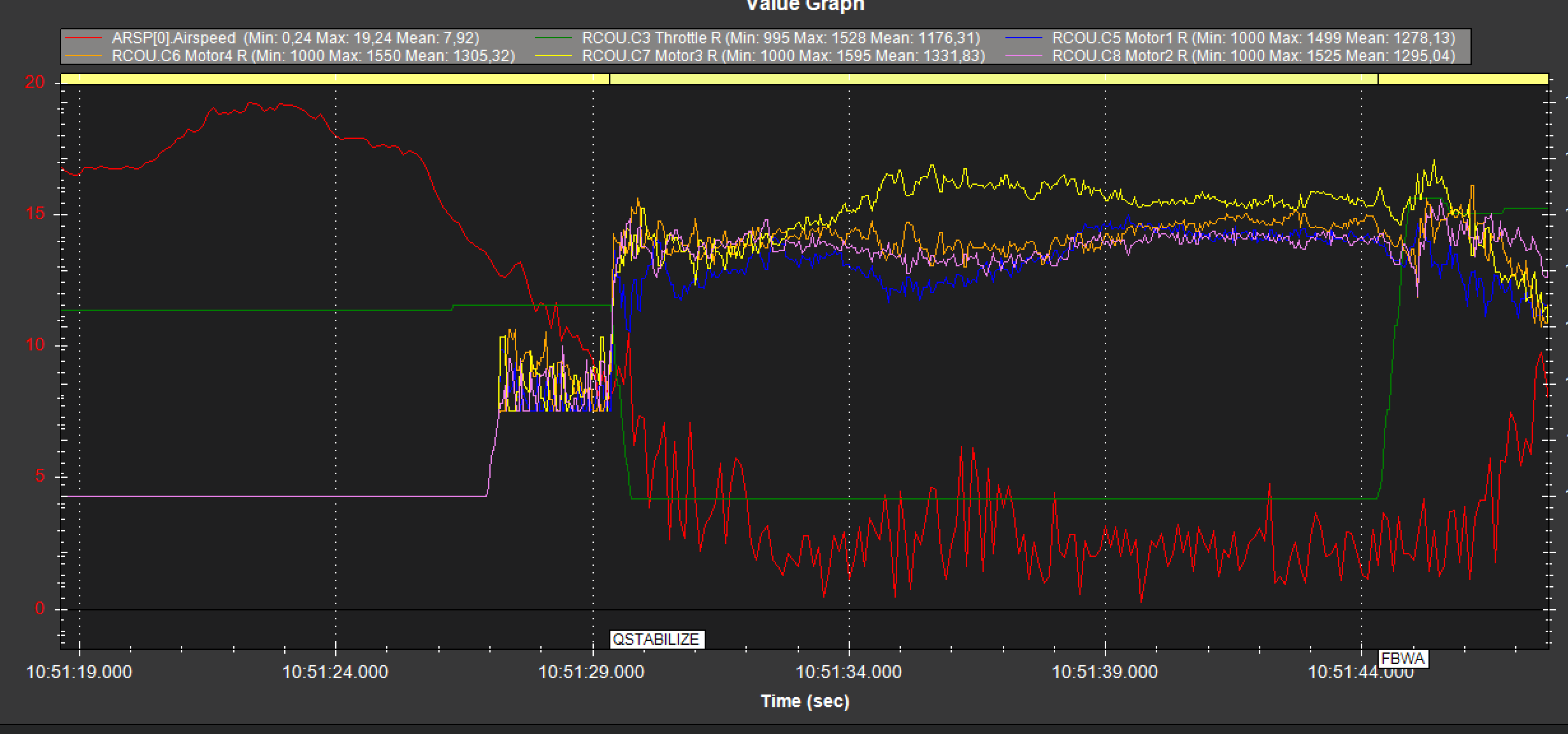

Thank you very much for looking into this. Here is a log file with another failed transition. Graphing the transition the same way as you did shows that the rotors don’t start before the RC-pilot switches to QSTABILIZE.
This log is from a big VTOL, a Mugin EV460. The plane stalled before the pilot luckily saved the day switching to QSTABILIZE.

Sorry, but no failed tranistion is recognizable in this log file (00000022.BIN) either. Q_ASSIST_SPEED is -1 and therefore Q_ASSIST is switched off.
