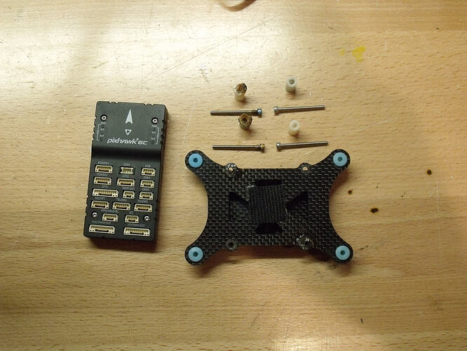

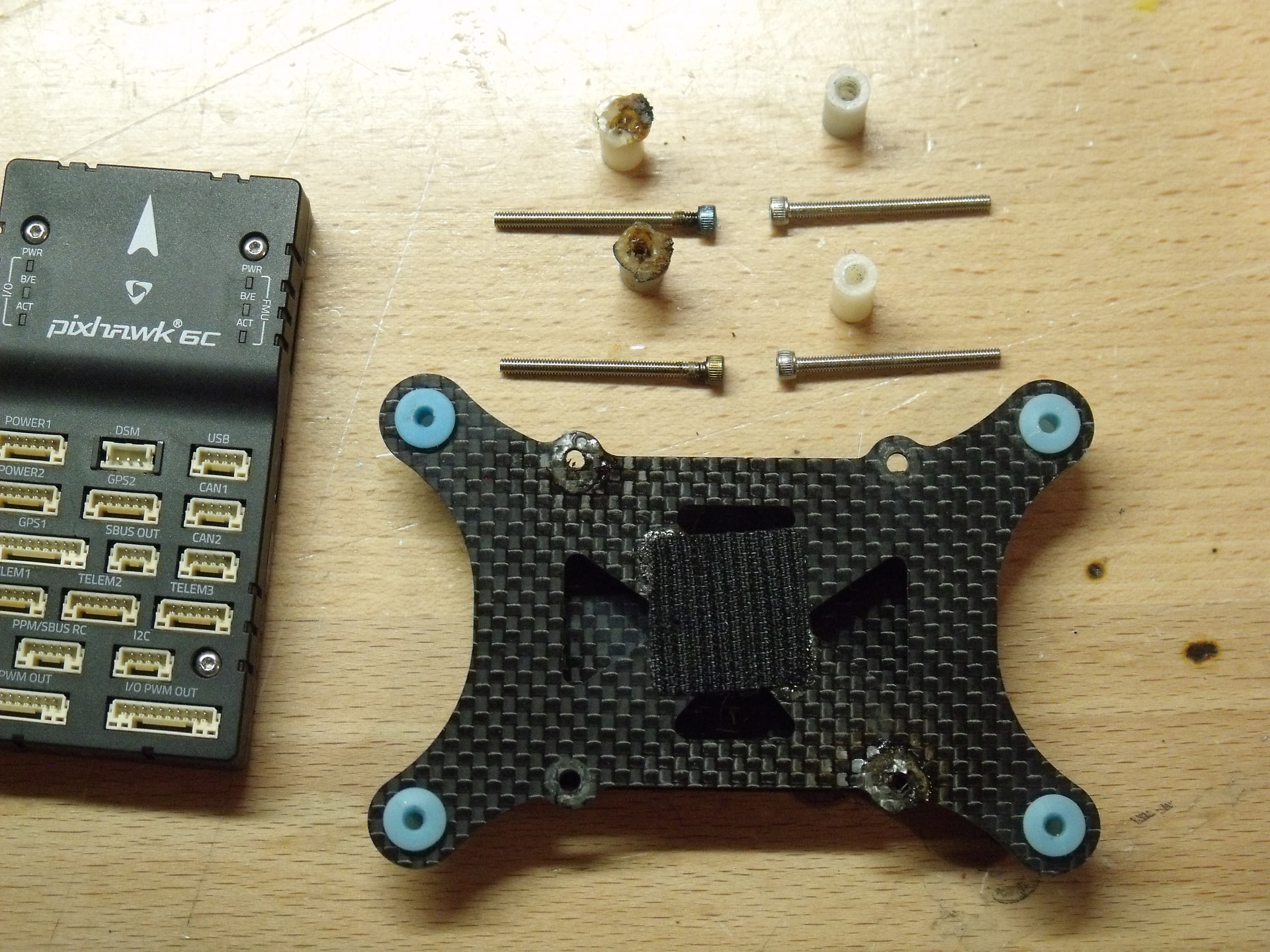

The Pixhawk mount is raised up a bit using nylon spacers in order to mount the landing gear controller underneath. When I removed the mount, the front left and right rear spacers were partially melted and the bolt heads were scorched.
You can see heat damage to the mount where the spacers made contact. Examination of the flight controller casing showed no heat damage whatsoever and later, I was able to plug it into my laptop running Mission Planner and it appears to be running okay.

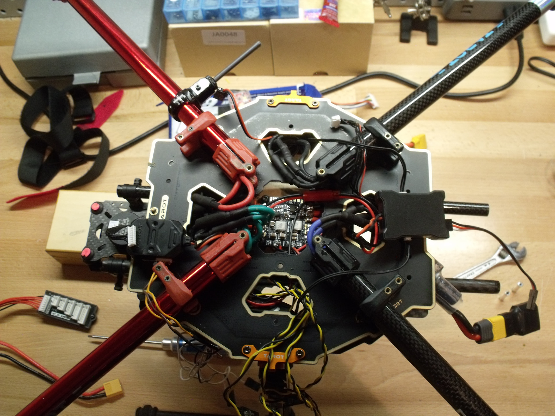

I removed the top deck, exposing the connections between the ESCs and the wires going through the arms to the motors - no visible indication of heat damage.
The long bolts that secure the flight controller mount go into the threaded holes at the ends of the arms - again no visible sign of heat damage. At this point, I am mystified as to what the heat source was.
I will have to strip away the heat shrink around the bullet connectors in order to disconnect the ESCs from the motor wires so that I can remove the middle deck and expose the power distribution and ESC layout. BTW, the PDB is functional as I was able to apply power to it.
Check for frayed wiring everywhere. I imagine those screws served as a path to ground for some short, maybe out in the arms by the motors. Carbon fiber is conductive, and splinters can pierce wiring shielding with ease. That is what I would do first.
I think you are correct! I was totally mystified by the lack of visible heat damage anywhere else. So, after a close visual inspection of the wires coming out of the arms, I found one on the left front and one on the right rear where the insulation was compromised. I suspect that as I screwed the hex bolts in to secure the controller mount, they pierced the insulation, and the carbon fiber plate completed the circuit. I plan to cover the spots with some heat shrink and carefully put it back together. I don’t know if the associated ESCs are okay - I will be optimistic and see what happens on the next test flight.

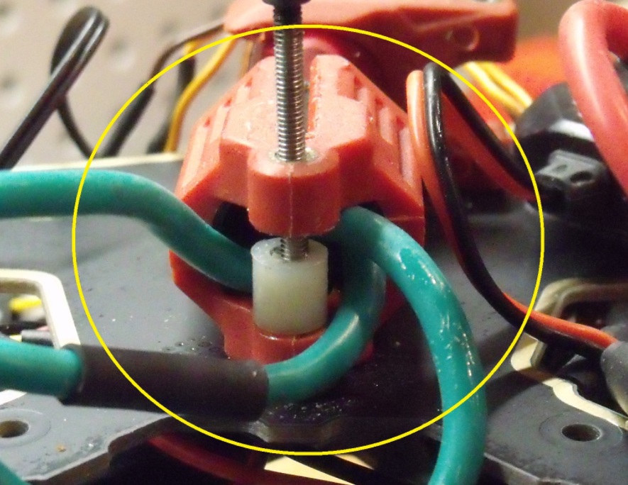

I did a close visual inspection of the motors - they all appear to be okay. I have applied some heat shrink over one compromised area and I’ve decided to glue nylon spacers to protect the wires when I screw the hex bolts in during reassembly:
After I have the aircraft put back together, I plan to run the motor/compass test, installing the propellers upside down to produce negative thrust. I will be able to throttle up the motors for an extended time and see how they behave and to make sure that there is no heat issues. If successful, then a brief flight test - hover just out of ground effect for a minute or so. will be in order.

I have repaired the damaged motor wires and reassembled the aircraft, but there is some heat damage to the bottom of the flight controller shock absorber mount:
I have ordered a replacement which should arrive tomorrow (Saturday). After I mount and hook up the Pixhawk, I will conduct a radio and compass calibration and wait for favorable weather to try a test flight.
