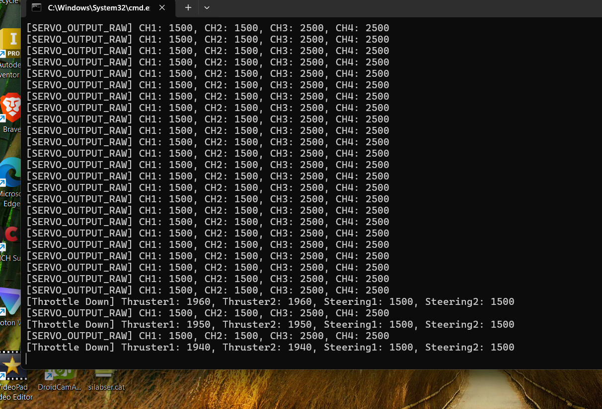

For my test, I connected the Pixhawk directly to my PC and wrote a Python script that sends PWM signals based on keyboard input. Pressing “Q” increases the PWM by 10 µs, and pressing “E” decreases it by 10 µs. The script also prints the current PWM value (e.g. 1500) so I can track exactly what’s being sent in real time.
I set the Pixhawk to Manual mode and observed how the servo responded as I adjusted the PWM from 800–1500–2200 µs. The servo moves normally between roughly 1100 and 1900 µs, but beyond that range it stops responding, which makes me think the Pixhawk might be clamping the signal internally.

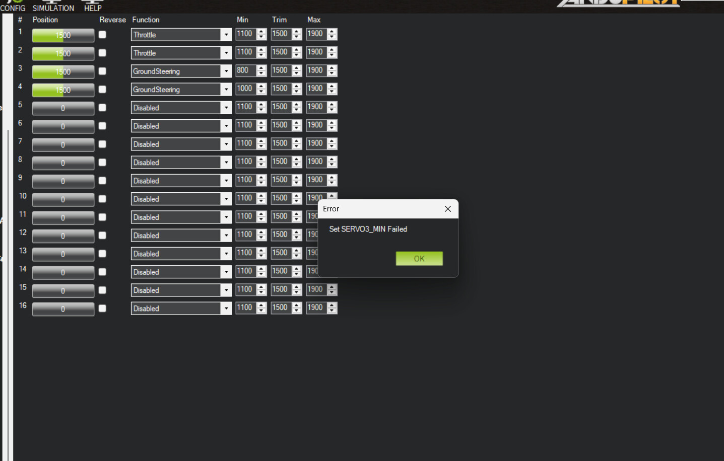

When i try changing the min and max from this window, i get errors.
So i change it using the parameter tab
It’s fine to use the parameter list to change the values outside their “normal” ranges.

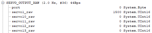

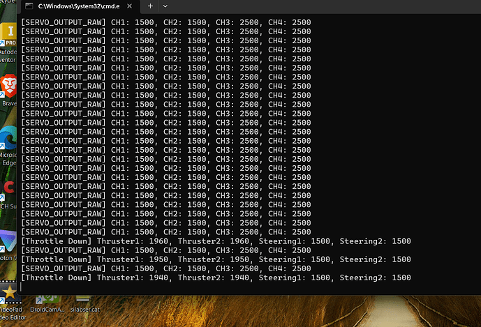

I got it work , it was a software issue and the Pixhawk needed some rebooting. Also it turns out the PWM i printed on the screen is not the same as the raw PWM
from the image PWM is 2500 but the printed one from my scrip says 1960. All in all ,i managed to get it to turn the full 180.
