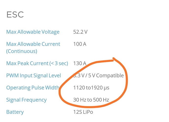

The picture below is the ppm setting of the motor and the radio you mentioned first.
If you can care it, I can send you the entire parameter value, flight log, video, etc.
Also, the log value was not obtained in disarmed state. Because the symptoms occur intermittently.
The second picture is what was needed. You haven’t setup MOT_PWM_MAX & MIN. This is usually a fixed value provided by DJI.
Example: MOT_PWM_MAX=1960, MOT_PWM_MIN=1160
Yes, I understand.
Do you mean I have to input the PWM min_max value?
Because it may be different from the value provided by dji?
Then I will enter the pwm value of dji that you told me.
Okay, thank you very much for your answer. I will contact you again after the test.
