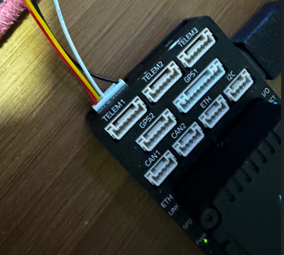

At this point I’m suspecting a wiring issue on my hand-crimped JST-GH cable — possibly the RX pin on the Pixhawk side is not actually making contact, or there’s a pin offset in the connector housing. The fact that telemetry works (one direction) but RC doesn’t (other direction) would be consistent with only one signal wire being connected properly.
I’m attaching photos of my wiring for review. Can anyone confirm:
  1. The correct pin mapping for CRSF on the UART4 & I2CB connector of the Pixhawk 6X baseboard V2?
  2. Whether the “Telemetry 100% + RC not found” pattern definitively points to a missing/broken RX line?
Any help appreciated — I’ve been stuck on this for over three weeks now.

Something fundamentally wrong here because I am wiring a Pixhawk6X up the whole time to TBS RX without issue.
Hang on - what is that picture? What is the connector wired into? Doesn’t look like a telemetry port.
Please post all your params
Hi Andy,
Thanks for taking another look.
Regarding the photo — the connector is plugged into the UART4 & I2C port on the Pixhawk Baseboard V2. It’s the 7-pin JST-GH connector on the upper edge of the board. Note that the silkscreen on this baseboard revision is printed upside-down on that edge, which may make it look unfamiliar in the photo. I chose this port based on the ArduPilot Pixhawk 6X documentation recommending SERIAL6 (UART4) for CRSF.
Wiring on that 7-pin connector:
  • Pin 1 (VCC +5V) → red wire → Nano RX 5V
  • Pin 2 (TX4 out) → yellow wire → Nano RX CH2 (CRSF RX)
  • Pin 3 (RX4 in) → white wire → Nano RX CH1 (CRSF TX)
  • Pin 7 (GND) → black wire → Nano RX GND
  • Pins 4, 5, 6 not connected
I’ve also tested on TELEM1 (SERIAL1) and TELEM2 (SERIAL2) with the same result each time — Telemetry Signal 100%, but RC not found and zero channel movement in Radio Calibration.
Full parameter file attached.
