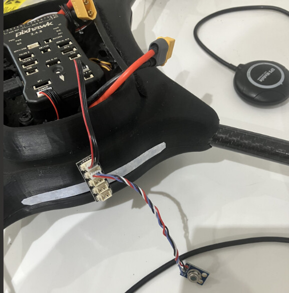

Pixhawk 2.4.8 with MLX90614 on I2C

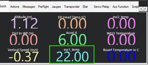

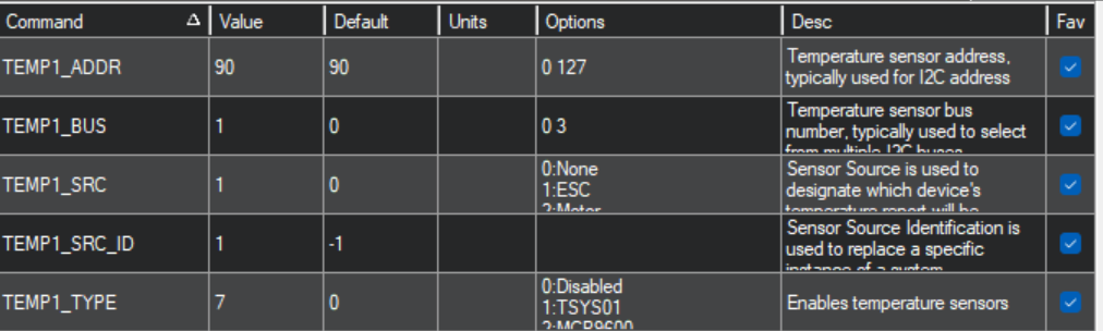

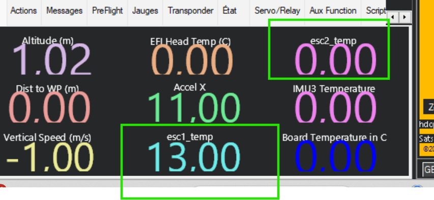

I connected with sucess a temperature sensor MLX90614 on the I2C port

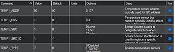

with Ardupilot Temp following parameters
Here is temperature mesured OK:

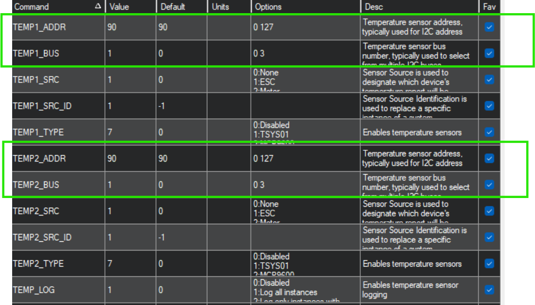

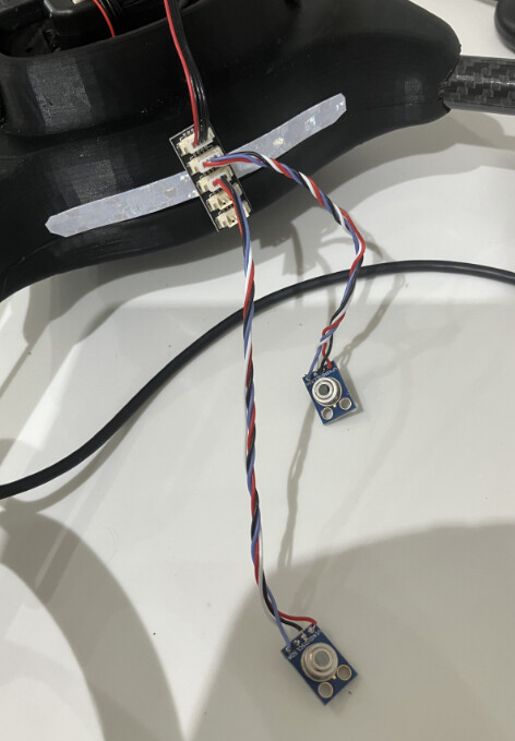

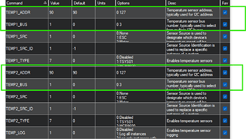

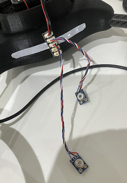

When I connect 2 idendical Temperature sensors on the I2C:
with following parameters:
–>I Have issue with temperature 1 (devided by 2) and temperature 2 is empty:
I have tried different TEMP_ADDR adresses (90 for the first and 100 for the second) or Bus number (0 &1) but i have the same issue
I guess there is an I2C conflict –>Does anyone know how it works?
Thanks
Vincent
very cool, i didnt know those sensors were supported, it looks like you need to change the i2c address of the sensors if you want to use more than one.
On the same I2C bus each device must have a seperate HW address.
This cannot be changed just by a parameter on the FC. It must be changed on the device itself. If the module don’t has the possibility to change the address it is not possible to use it on the same bus.
So you can either use to different I2C busses if available. But this also need two HW independent I2C busses on the FC. Or you must change the HW of the sensor.
This MLX90614 has only a single fixed address. So if the module has no additional features it is not possible to use more than one MLX90614 on one I2C bus

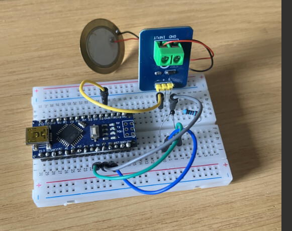

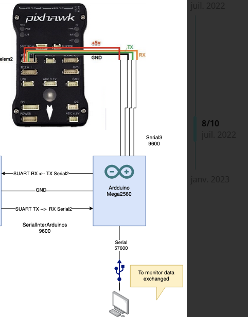

Hello Geofrancis,
first, those IR senso are supported by the Pixhawk 2.4.8–> have a look to the list of temperature sensors compatible here: link
second, for arduino solution: I can use the MLX90614 (your explanation) or I already tested an Arduino board with thermistor and vibration sensor for measurement

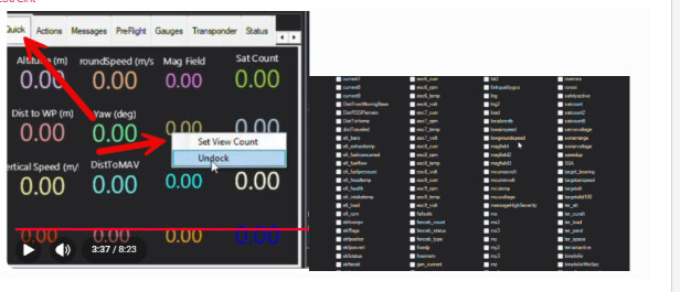

–>The question is “how to connect the Arduino to the Pixhawk and recover data with Mission Planner?
I have seen several information on the web in order to connect the Arduino to RX/TX of the Pixhawk with Telemetry Port (serial mavlink protocol) with code details
–>My question is, how to recover Data exchanged with Mission Planner (I mean wich parameter will pring the information)
I hope the request it is clear enought?
Regards
VIncent

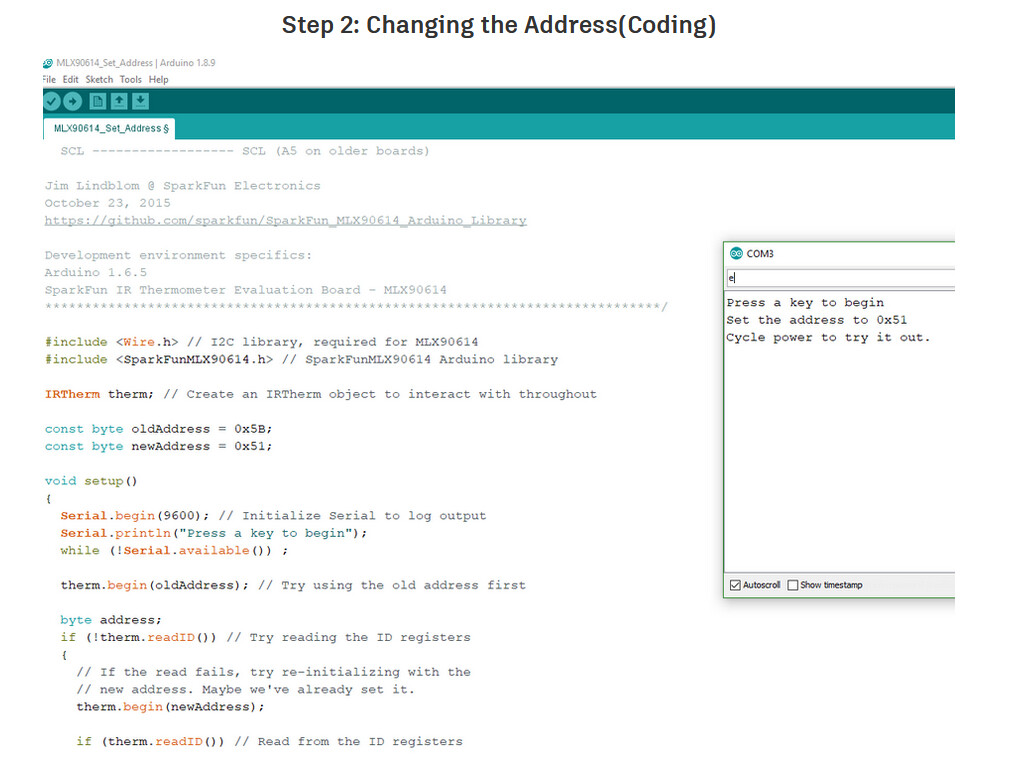

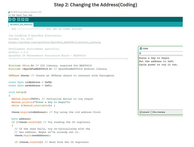

I was pointing to that article as they show how to change the I2c address of the sensors. I believe the change is saved so then it can then be plugged into the pixhawk and multiple sensors will work on the same bus

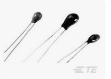

Hello ddegn, those sensors are just for monitoring engine temperature…maybe I did’nt choose the right one…the MCP9600 could be better if I can changed the address with pin resistance as said Juergen
or I can use a classical thermistor on the arduino+pixhawk solution (no adress conflict and conditions are not extreme!)?

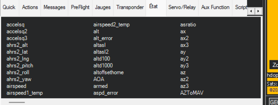

Thanks GeoFrancis, I beleive your solution make reference to Code address change for Sensors→Arduino→Pixhawk connections
At the end, once everything connected (RX/TX)&configuredcan you tell me name of sensors measures that can be visualysed in Mission Planner ?
The sensors are i2c , you only need the Arduino board to change the address. Then they will work when plugged into pixhawk i2c.
In addition to @geofrancis post, after you changed the I2C address on the MLX90614 with an Arduino (or similar board) you can use the MLX90614 as you tried in front by setting only the correct new addresses to the FC params.

Here is also the article I found: Multiple IR Temperature Sensors - MLX90614 : 4 Steps - Instructables

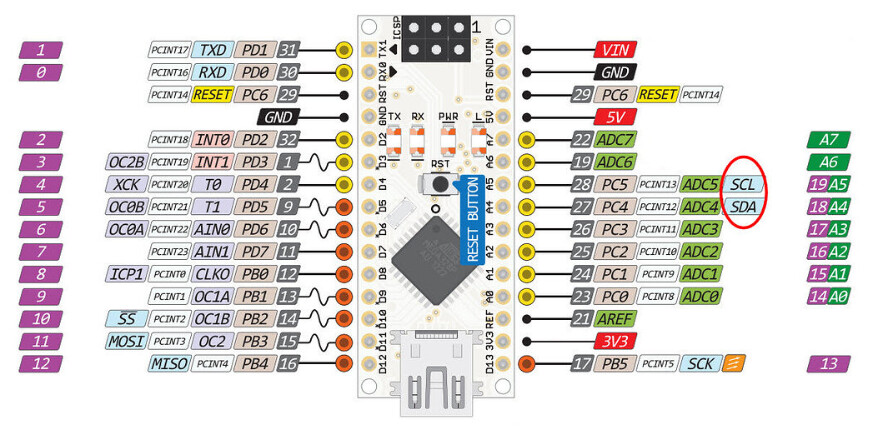

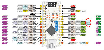

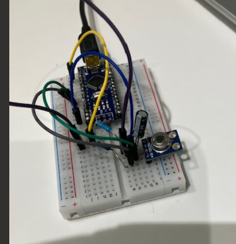

–>I will managed it with a Nano board…here are Nano pins details for SCL/SDA
I have conected the MLX90614 on the I2C port of a Nano:
with I2C-scanner code –> I have identified with success the address: 0x5A
(Program I2C_Scanner.ino)
but when i want to use the program MLX90614_Set_Address.ino inside zip indicated on site (as you said) i have the error: “Failed to communicate with either address.”
this test is not passed on line 46: "therm.begin(oldAddress);
(SparkFunMLX90614 library added from here)
If some one has an idea?
Maybe you did it correct, but you verified a default address 0x5A, while the “set address” sketch uses by default 0x5B as “old address”
Here is set address code i have:
