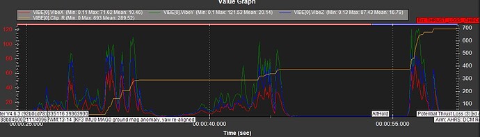

Now, I’m facing with an issue with the drone where if I put it in AltHold, it just shoots up and won’t come down unless I disarm it. Good thing I did it indoors because one time it got stuck up on the ceiling lol. There is a potential thrust loss (3) which I guess is due to a bad motor (bent shaft, plus the props and hence the shaft have some free play even after fully tightening the props and holding doen the motor bell with my hand). I’ll replace this motor in a week. Also the propeller on the 1st motor also has a chipped tip on one blade. Should I replace that too or can I live with it? Here is the log of the very short flight:

You had RPM filtering working but completely disabled now, please enable as suggested
Check arms twist, motors connected to outputs 11 and 12 are working harder. That can be CoG if i’m wrong in numbering.
There are still ESC protocol errors on 2 outputs as discussed before, please check you wires or replace it to thicker ones.

No, no, I did not have it enabled in the original log
Well, yeah I have no means of actually centering it but considering I have enough power, I don’t think I should worry about much right?
That copter won’t fly on LPF only.
The problem with CoG or arm twist that noise is much wider because motors rotate at different RPM, and it’s harder to filter.
Well, I did. To gather initial data. Check my first log
Do you think it could be vibe levels as high as I have seen them, ~700 clipping events and battery sagging to ~3V per cell? Output oscillation and maxed out motor outputs.

But to give you context, the very first log in the question section of this thread was done without any filtering and you can agree that the vibe levels are pretty good for this frame than what people make out to be. In that flight I suffered a crash and the first motor shaft is slightly bent. I only noticed this a day ago. Then @Yuri_Rage suggested to remove the earplug mounts and hard mount the Pixhawk and analyse the vibes after this. So in the process of doing this, alt_hold mode made by drone shoot up of theground and the third motor’s prop has a chip and this is causing vibration on that motor which I can see. So yeah I agree I have to replace the prop and the motor. As for the battery, it is Li-ion.

Where can I see this in the log? Is this because of the bad motor and vibration?
By graphing the RC outputs. I’m wondering why you would post this log at all. What’s the point with a bent motor shaft? You could have started a new thread titled “what happens with a bent motor shaft”.

Before this, I used a lower qualit set of props that were unbalanced and with those, I saw these same vibrations on almost all motors given I provided step inputs, but I did not have the potential thrust loss (3) warning and it definitely did not shoot up wihtout control on althold. So the point was to know the root cause of these two issues are some config issue (maybe an ekf3 clash with GPS no fix since I’m inside while performing this flight).
Yes they use collets. But they worked okay for the first flights with these new props
Yes, the reason I want to fly again (pribably after replacing the damaged parts now) is to do FFT to analyse the frequency I should be filtering out. Although now I think that shouldn’t be different from the first log as the peaks are due to the blades passing over the arms. Am I right?
